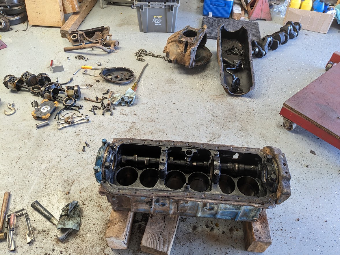

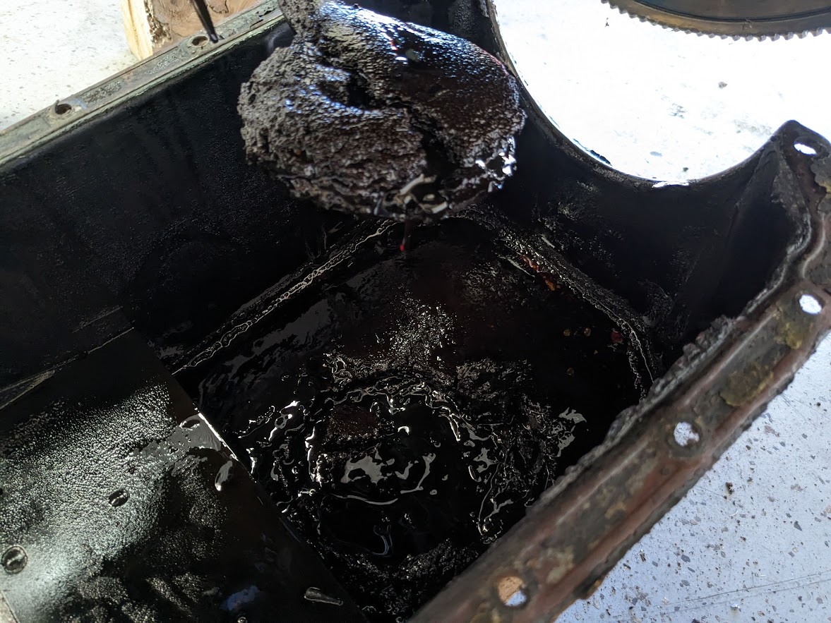

    fwiw, I got the engine apart, it spun a rod bearing. Also, the head was cast a week before the block, I guess it was sold as a complete engine.

    OH MY! I wonder why it spun the bearing?

    In '63 I bought my first '55 Delray. When I took it apart it looked just like your engine. The previous owner was so proud that they always changed the oil. Pennsoil was notorious for clogging up engines and that what he had used. I asked him how often or how many miles he had changed the oil. He couldn't remember. You've got an interesting project Squirrel and waiting to see what you put it in.

  26. Wow! is that the pickup or did someone leave a do-doo in the pan?
    427 sleeper likes this.
  27. Well, the engine DID take a **** :D

    Well, the crankshaft is the same as a 235, so it shouldn't be tough to make it a useable engine again
