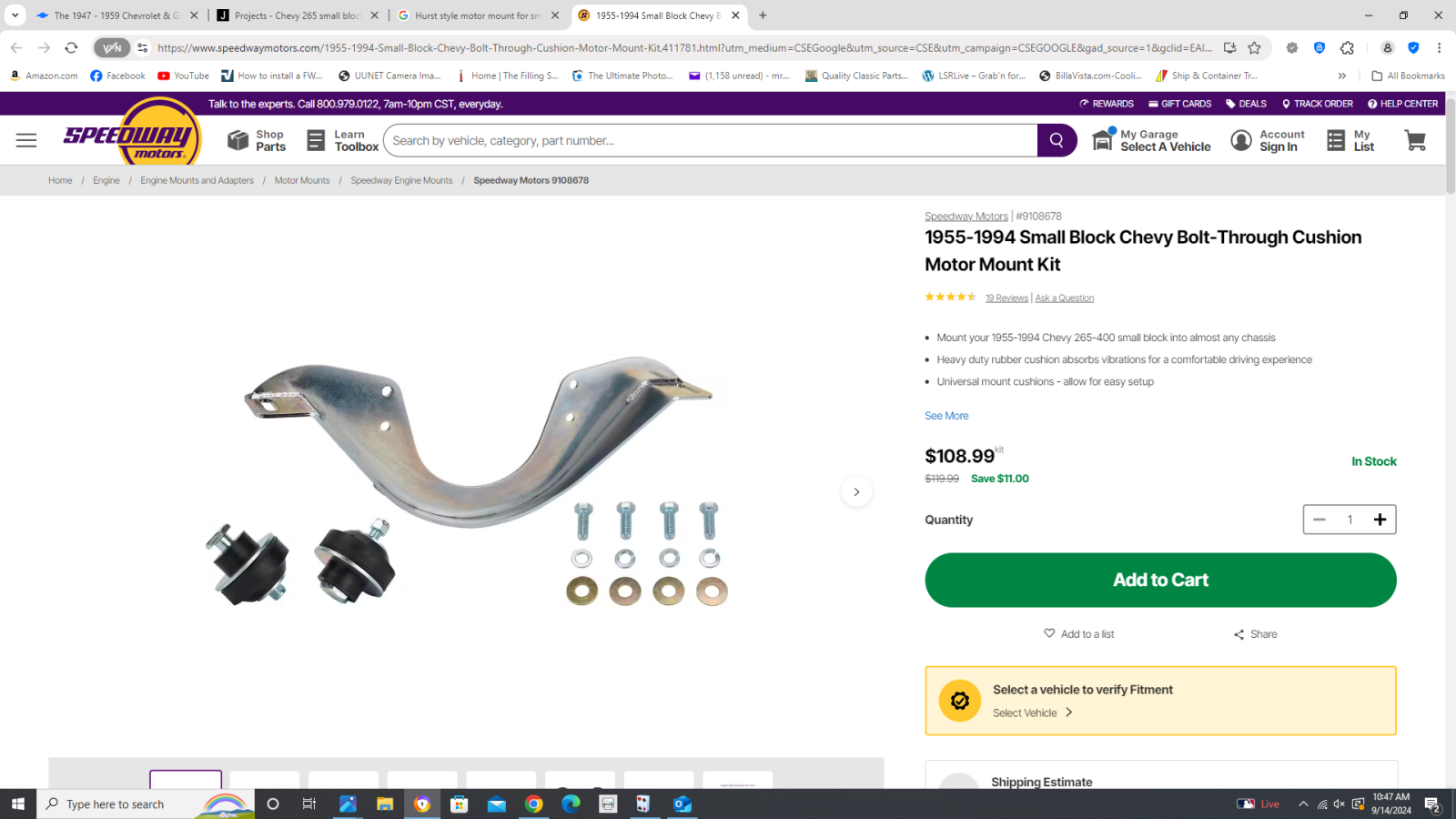

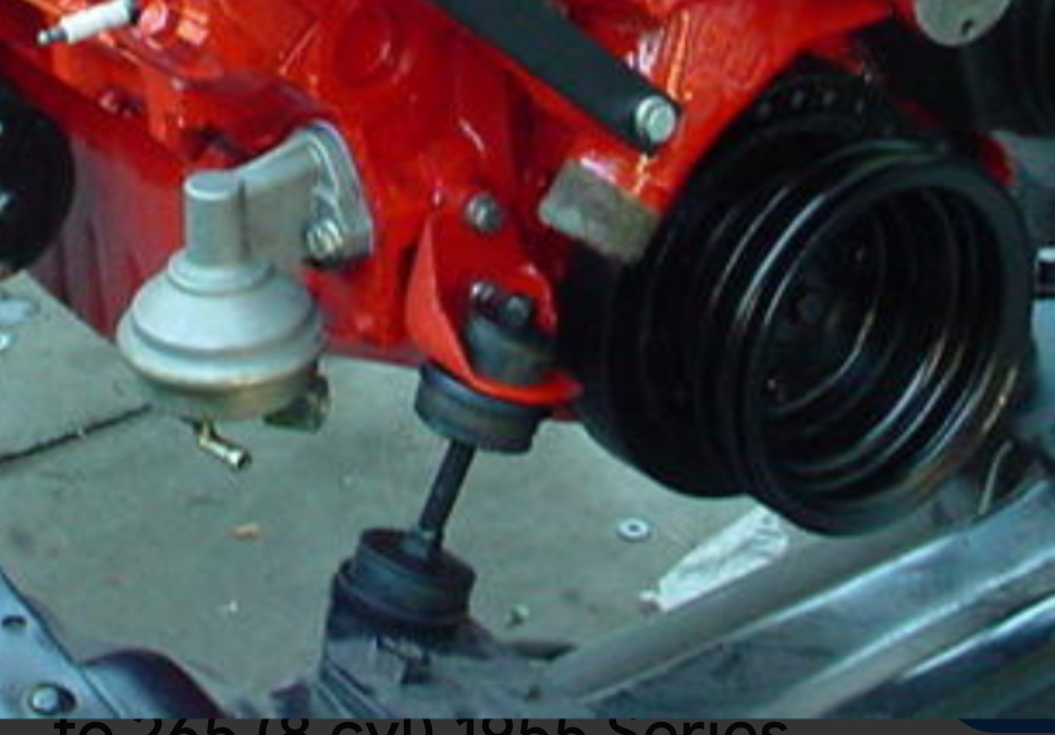

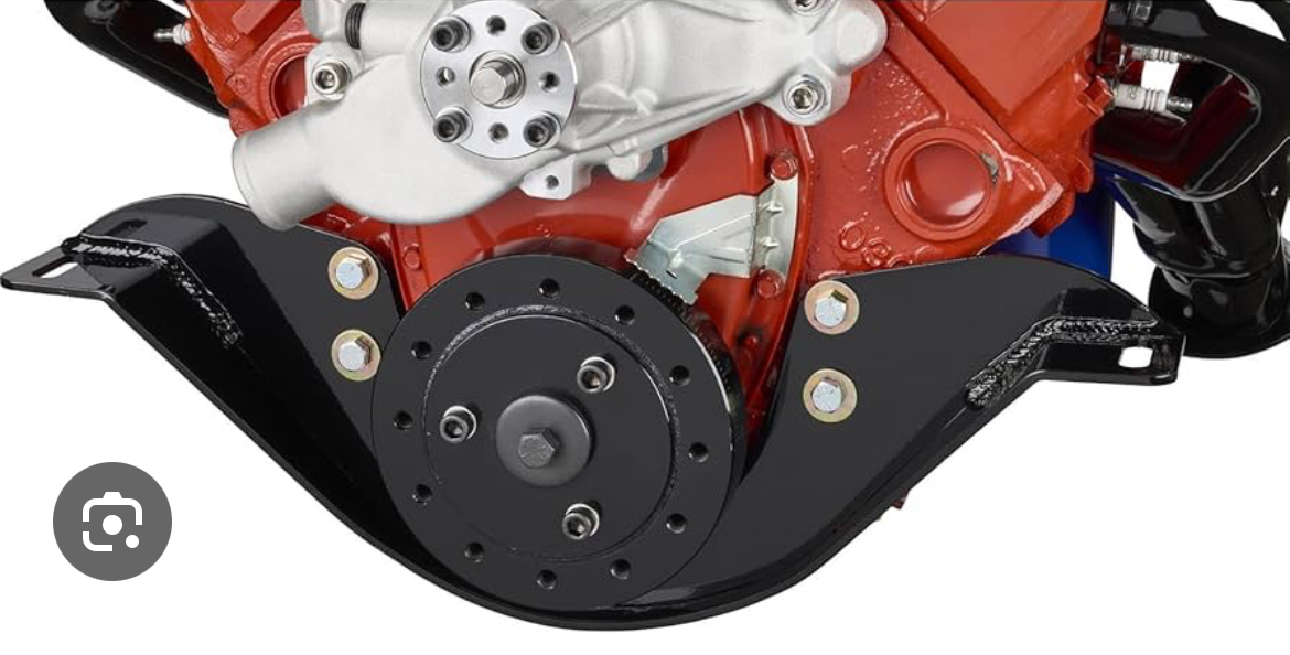

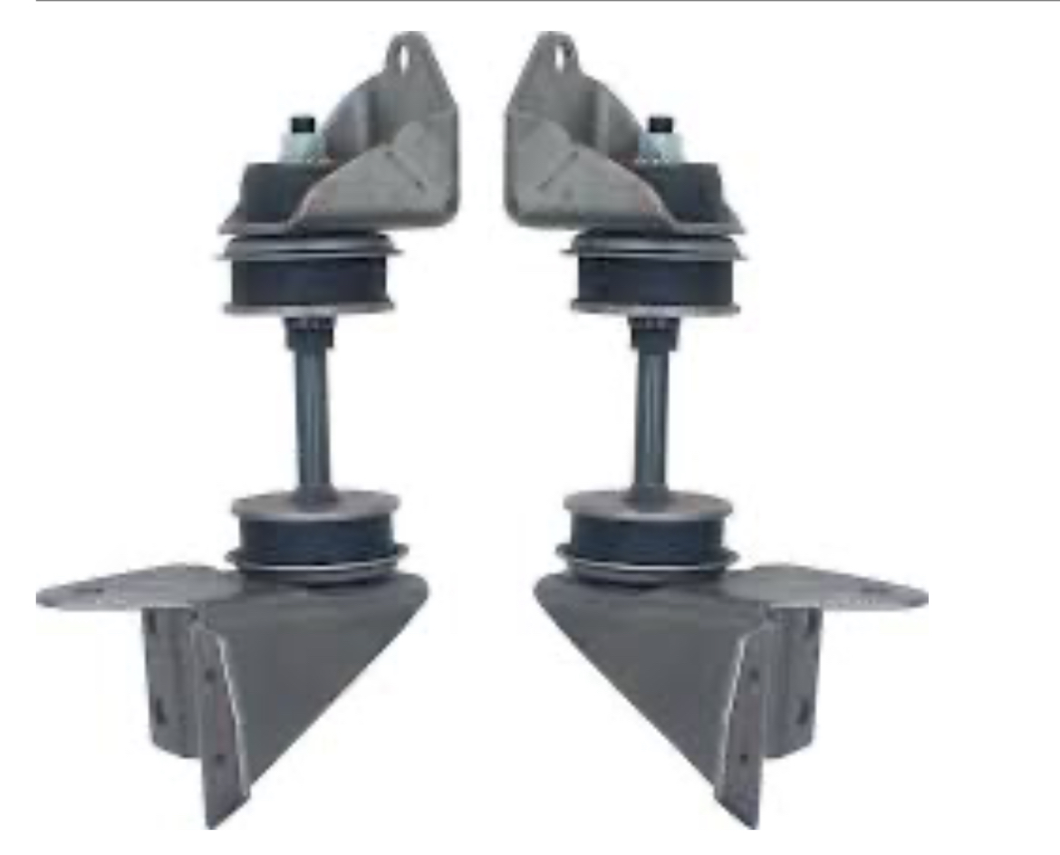

    A Hurst style front mount such as this one from speedway is a simple way to mount a small block V8 in an early ch***is. This one comes with the Ford biscuit motor mounts. They can often be found at swap meets for a friendly price when rodders decide they don't need them anymore because they use side mounts.
    A cast iron V8 truck (or car) bellhousing from 55-59 (car 55/57) will let you use rear mounts on the bellhousing but you do have to run a manual transmission.

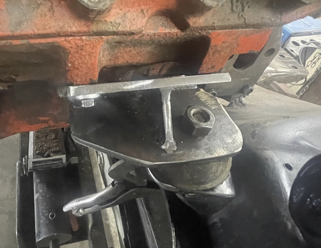

  14. Direct bolt in would be a Chevy that used front mounts. Or a ride born with a 265 or a 283 that uses the front mounts. That’s a narrow field.
    I guess “bolt in” is where the confusion comes in. We build stuff. So “bolt in” is kinda of a strange concept here.
    Guys already posted some mount options

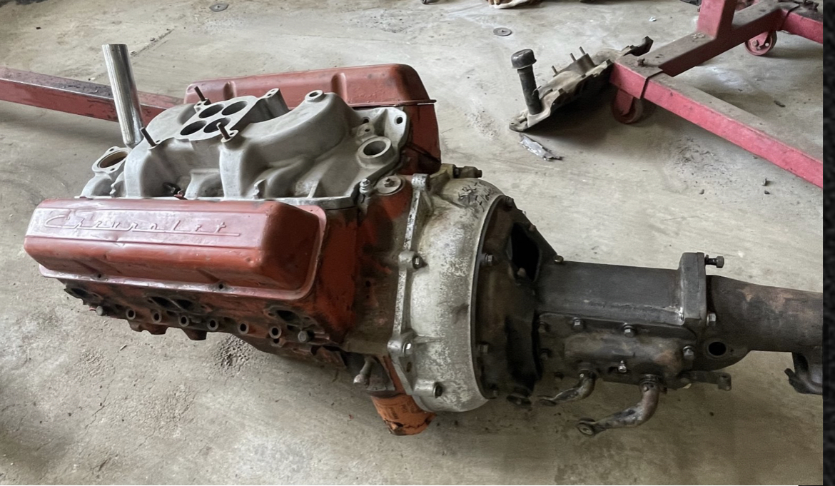

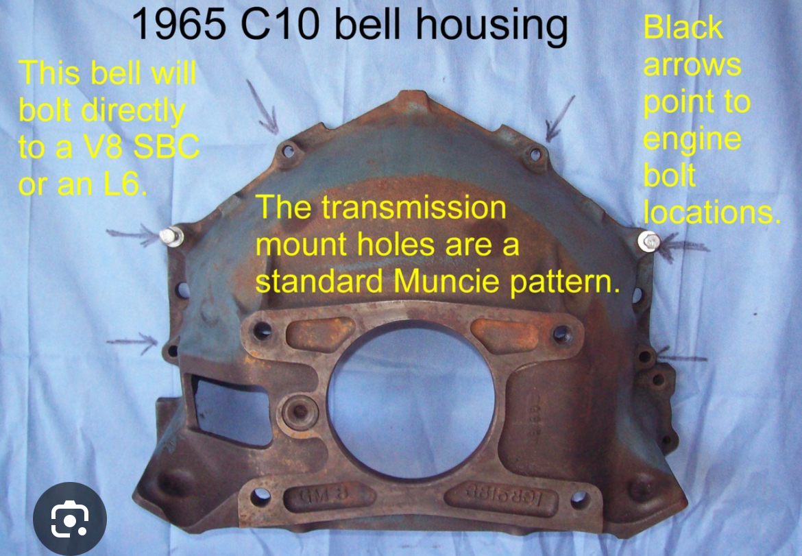

    if ya want a manual, that’s EZ if you don’t have one of these with your 265. Truck bells for c10s 60-72 have the mid mounts on the bell
    there’s a couple different versions. One with a hydraulic clutch that mounts on the p***enger side. Saves some clutch linkage fab issues. But that’s EZ to convert one of these to hydraulic if you need to. The large center hole is important. There’s a couple different sizes and needs to match the trans you use. Saginaw and Muncie 3 speeds are not expensive and simple to rebuilt if needed. An s10 5speed would work with minor mods. Lots of info here. For an auto, side mounts for the auto bell needs fabricated.
    If you pick up a beater that used a flathead ford, that 265 is easily adapted to the ford trans.
    here’s a 283 mated to a flathead ford trans with a cheap swap meet adapter.
    Your 265 will fit anywhere a flat head used to reside. If you have the original 265 exhaust manifolds you have an advantage all ready for that
    those 265 manifolds clear the steering on lots of older ch***is.

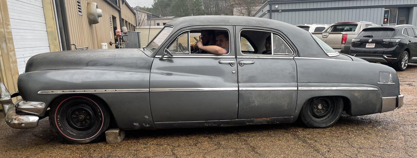

    under 10k? I don’t know the Canadian old car market but this ugly Merc will be cruising for way under 10k including purchase price
    Here’s an example of building a “bolt in” mount. We didn’t use the front mounts because we’re mounting the trans on the tail shaft.

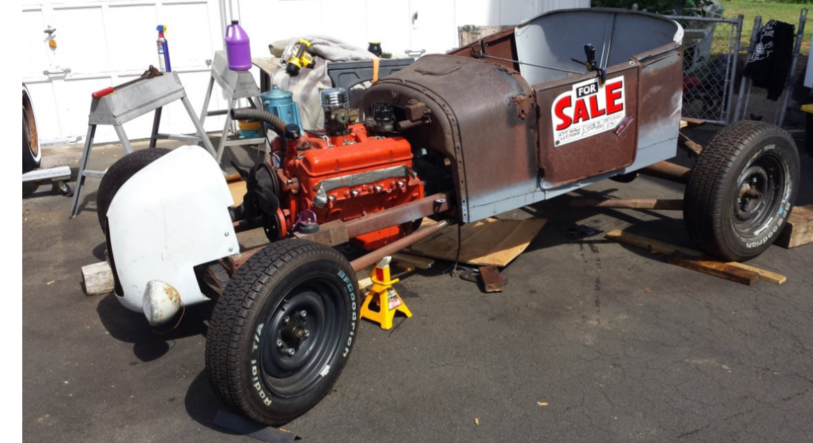

    here are some examples of beaters near me
    This one is perfect for that 265

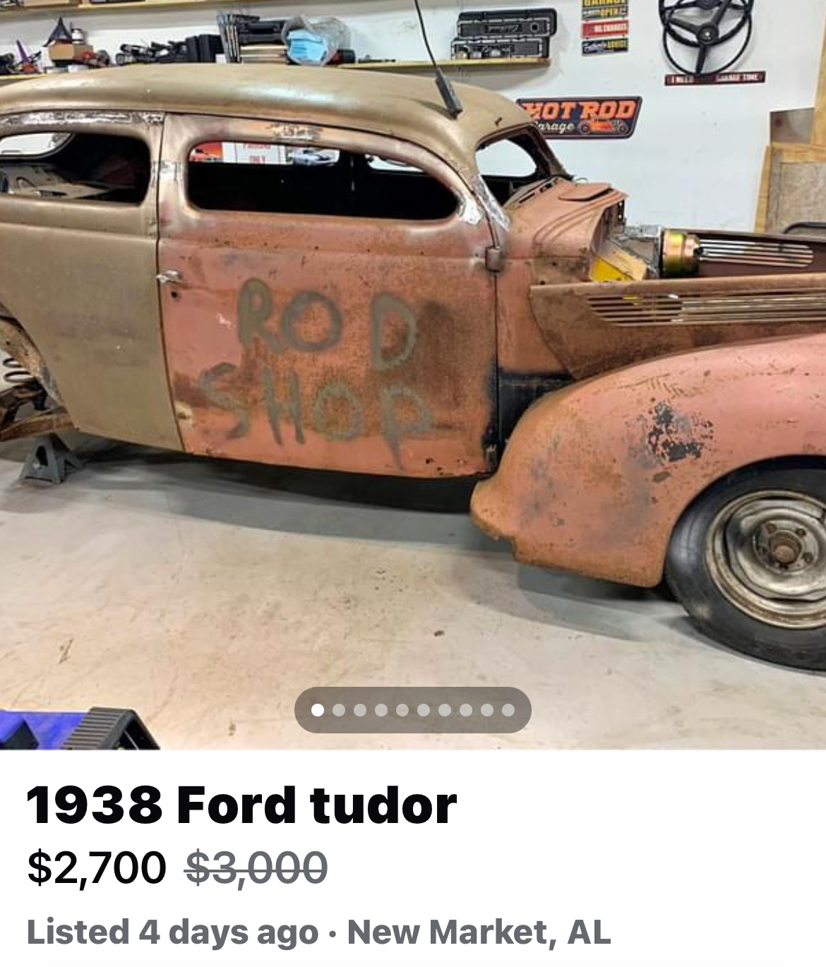

    I’m just posting examples. I understand you live far north from central Bama.
    friend of mine picked up a good 31 model A 2 door sedan shell for under 3k. The ch***is for those are super simple.
    They’re out there you just have to find em

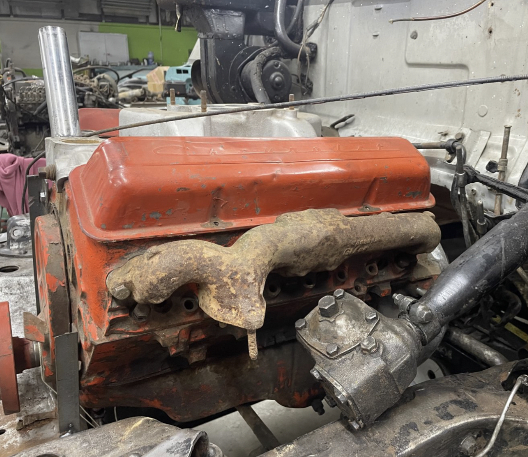

    What the heck is that ducting(?) behind the air cleaners that goes down below the exhaust manifolds?
    Algoma56 and Sharpone like this.

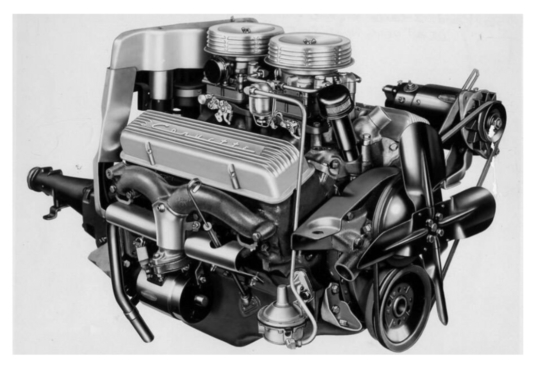

  23. 427 sleeper
    Joined: Mar 8, 2017
    Posts: 3,438
    427 sleeper
    That's stainless steel shielding for the plug wires to cut back on radio interference.

  25. 427 sleeper
    Joined: Mar 8, 2017
    Posts: 3,438
    427 sleeper
    Yes. They were used because the fibergl*** body doesn't shield like a metal body.
