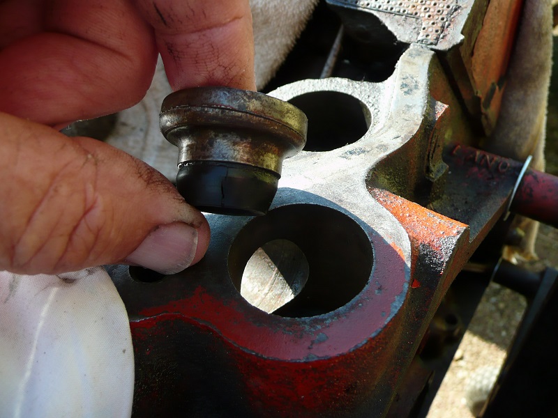

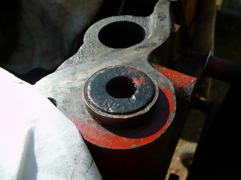

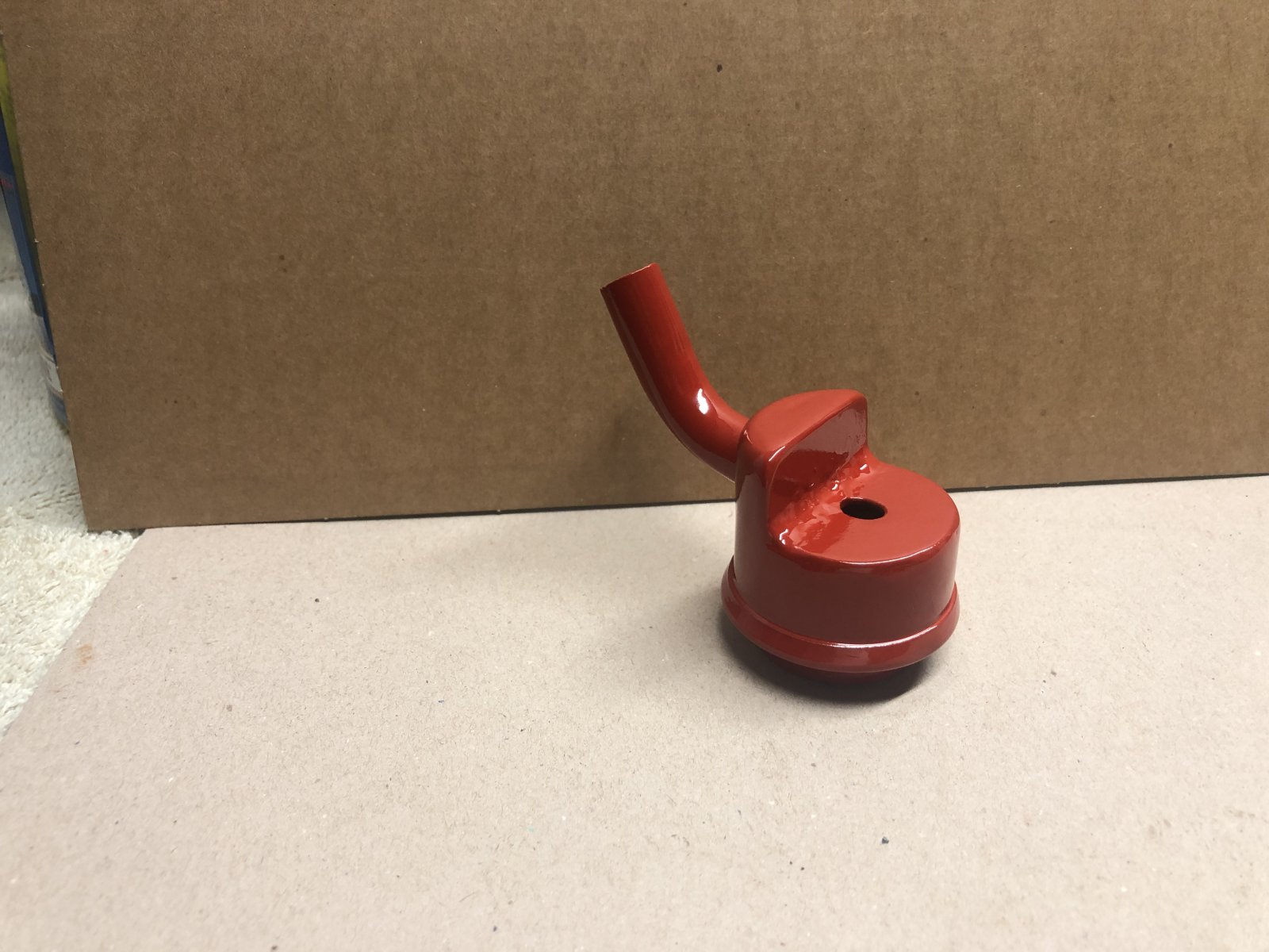

    I've purchased a 283 the had the PCV fittings plugged with RTV!.....Can I change this fitting for the earlier type?

  2. Chev63
    Joined: Mar 4, 2024
    Posts: 28
    Chev63
    Like this....

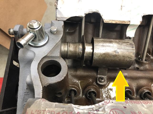

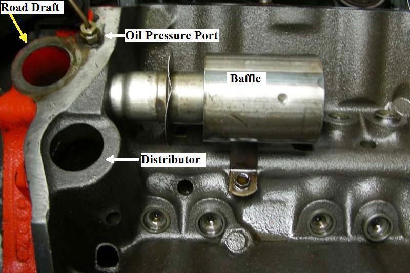

  3. Chev63
    Joined: Mar 4, 2024
    Posts: 28
    Chev63
    And do I need to fit a baffle?

  7. SS327
    Joined: Sep 11, 2017
    Posts: 4,199
    SS327
    If you go to a road draft tube you will definitely need the in block baffle.
  8. 427 sleeper
    Joined: Mar 8, 2017
    Posts: 3,398
    427 sleeper
    The answer is yes to both of your question's. You have to install the baffle and you can use the fitting shown. Not sure why the baffle was removed in the first place. :confused:

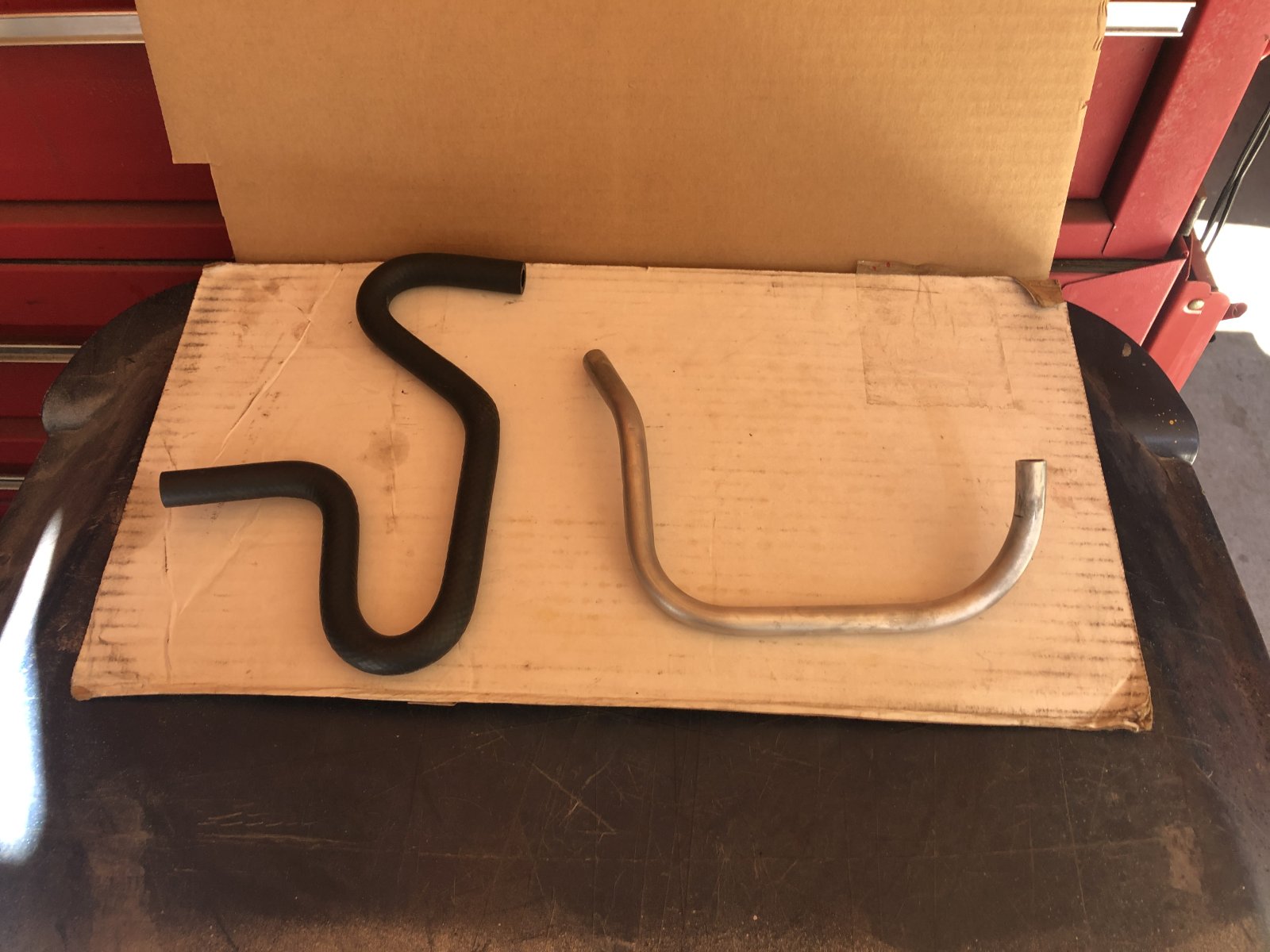

  9. Bob Lowry
    Joined: Jan 19, 2020
    Posts: 1,626
    Bob Lowry
    I always did/do a pcv system using what Chevy offered...

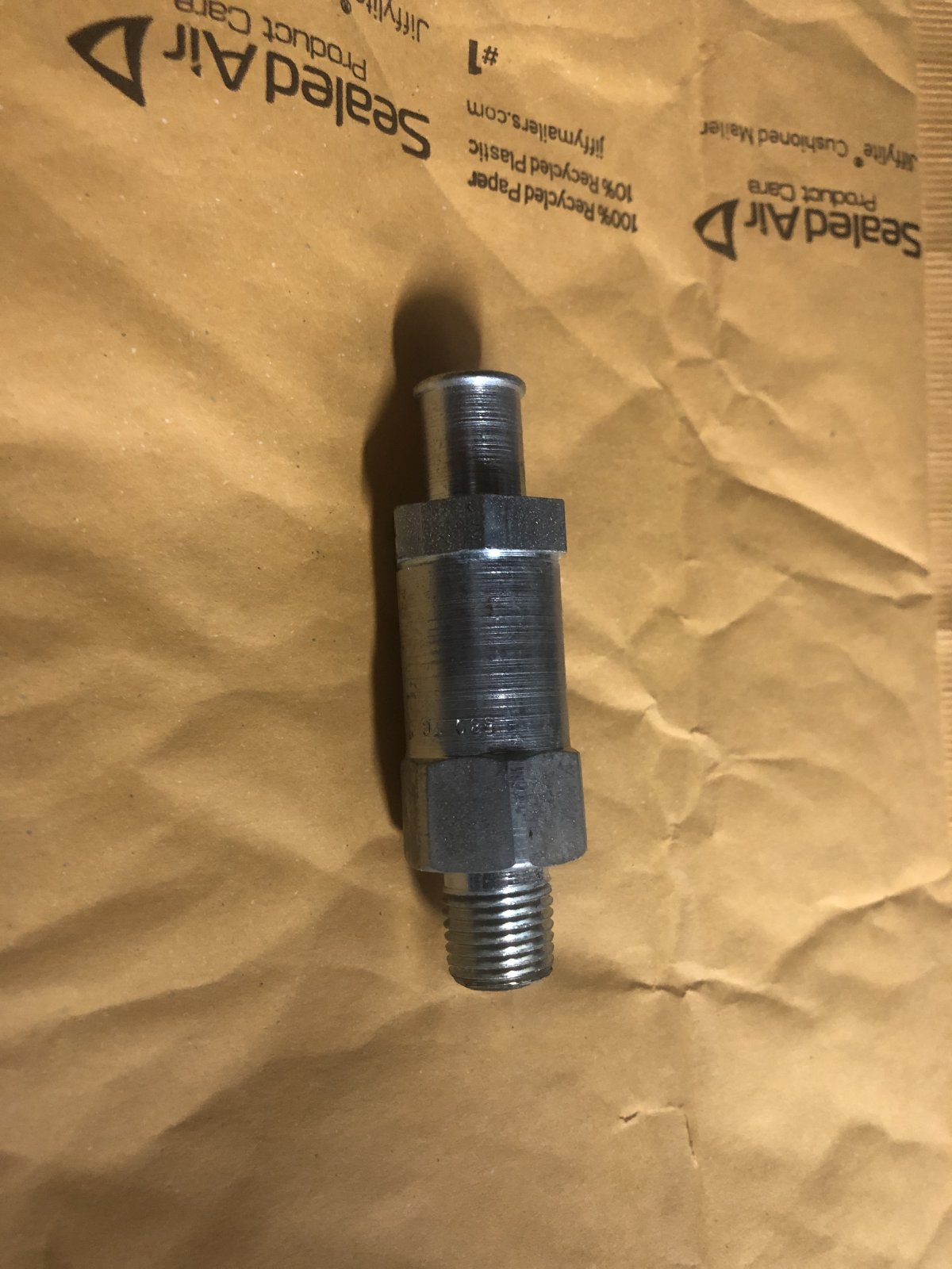

  12. jimmy six
    Joined: Mar 21, 2006
    Posts: 17,403
    jimmy six
    Stock 283-327’s from 62-up used the little teapot fitting and internal baffle until they went to the valve cover system and changed the blocks.
    The PCV valve screwed into a 90* fitting at the rear of the carb base. The early valves were cleanable the replacements are not. A Standard V100 is readily available and will work fine on almost all engines with a threaded fitting.
    These parts were used on a y-block Ford with dual quads. A 3/8” hose with many bends is available at Auto Zones at the back of the store near all the “Help” products…none of this is rocket science. The valve is a serviceable NOS found at a swap meet. IMG_3647.jpeg IMG_3651.jpeg IMG_3640.jpeg

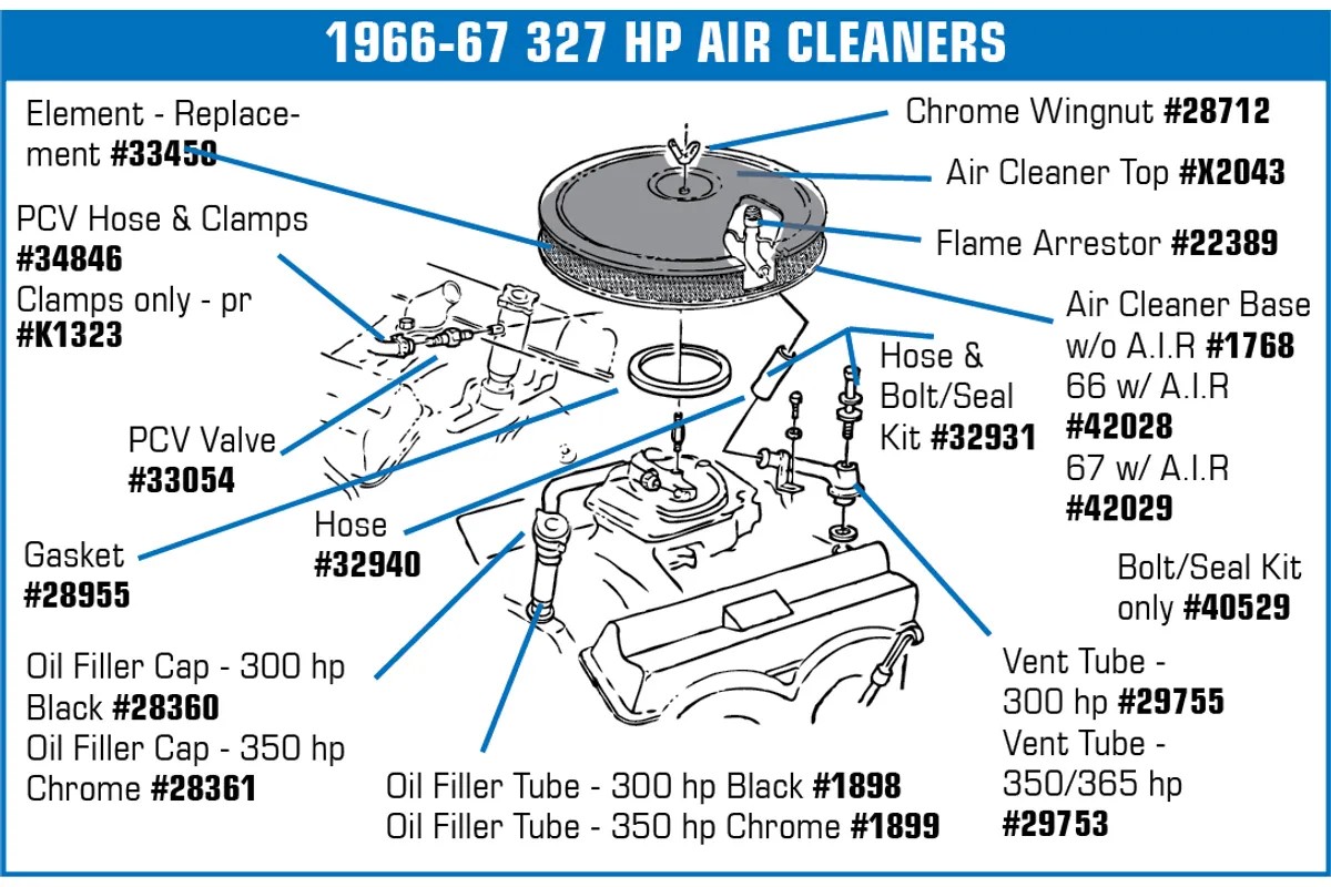

    Posts: 22,913
    My 327/325 hp (same as 350 hp).
    66/67 style.
    The odd one is the 1965 Corvette that most people outside the Corvette group do not know about, it did not use a pcv, instead, it had a metered orifice in the carburetor body.

  18. 327Eric
    Joined: May 9, 2008
    Posts: 2,204
    327Eric
    You definitely want the baffle in the lifter galley at all times. As for the pcv fitting, I have a rubber valve cover grommet in the back of the block on mine.
  19. Mr48chev
    Joined: Dec 28, 2007
    Posts: 36,209
    Mr48chev
    This and what Bob Lowry showed. in post 9.
    Soon after Chevrolet (GM) switched from road draft tube to PCV valves you could buy the kit that Bob showed at the Chev garage parts counter and maybe through local parts houses. I installed a few of them in 64/65 in high school auto shop when someone brought one in and had us install it and word got out that you could have it done to your small block and get rid of the fumes from the road draft tube. Guys in their 70's and older can remember those cars with blow by pulling up beside them at a light and having a cloud of blue smoke come out from under the car.
    That grommet will work if you have the baffle in place and working but if you don't have the baffle oil tends to get splashed to the PCV valve.
    I've also cut a few road draft tubes off and set them up to run a PCV valve setup. Easy to do but can look a bit clunky if the engine is out in the open.

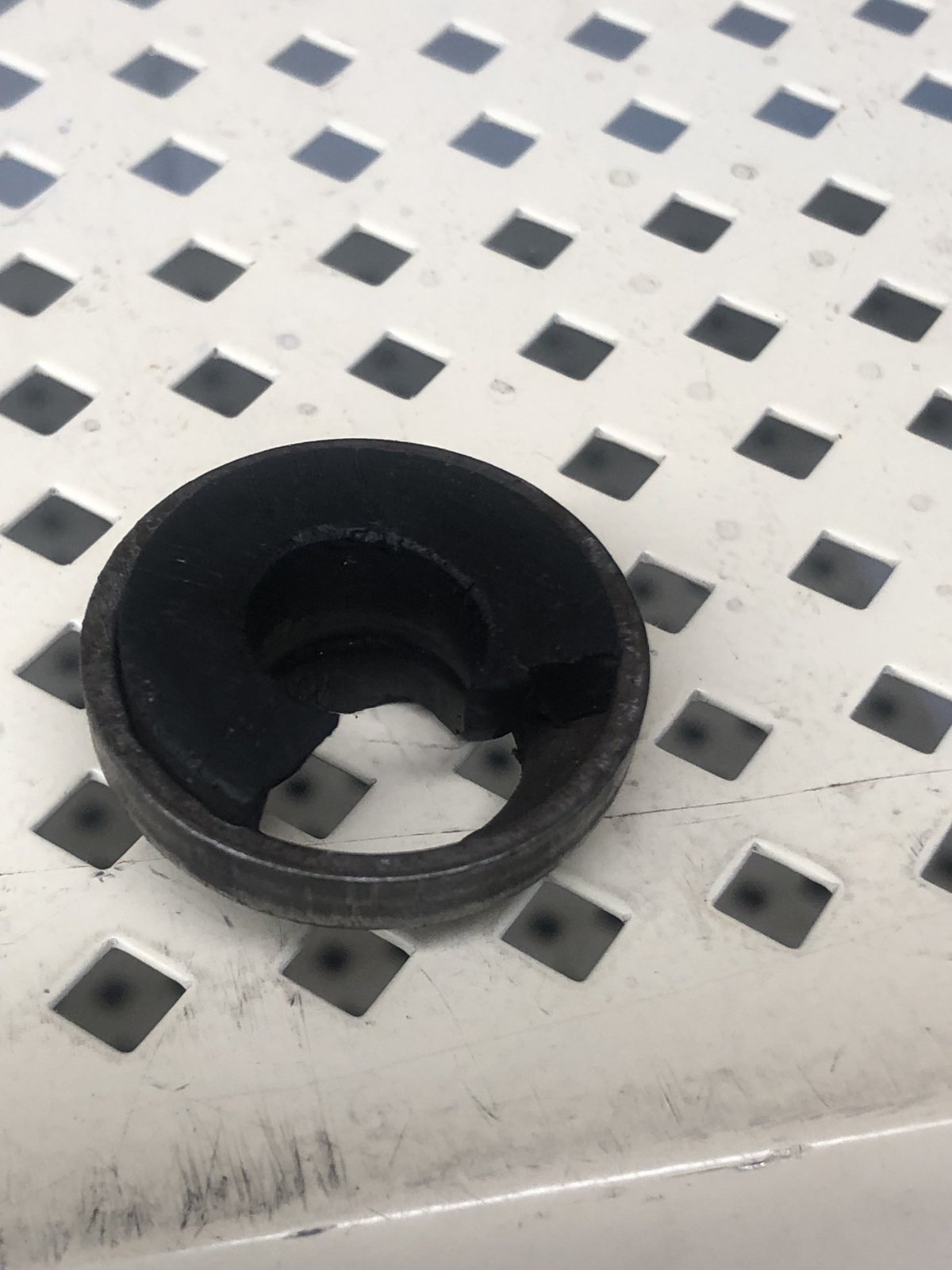

  22. enloe
    Joined: May 10, 2006
    Posts: 10,136
    enloe
    from east , tn.
    I need these pieces for my Corvette my rubber piece is broken. I would also like to get the kit that is pictured above. Does anyone know where I can get these pieces and what the part numbers are? IMG_7606.jpeg IMG_7607.jpeg
