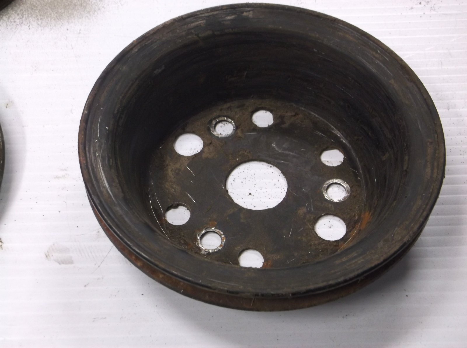

    Gents,
    I have what I believe is a 1963 built 283, (block casting # 3794226) it has a 'hub' as opposed to a harmonic balancer..... What I need is the part numbers for the crankshaft and (short) water pump pulleys.
    Any help very much appreciated!

    If anyone knows the era correct OEM part numbers that would be great....

    That "hub" was it on a 283. Those pieces shouldn't be hard to find and the 95 buck asking for what many on here would think asking 10.00 for would be high will have some digging in the junk pulley box.

    Any idea what the 'BC' after the part number means?

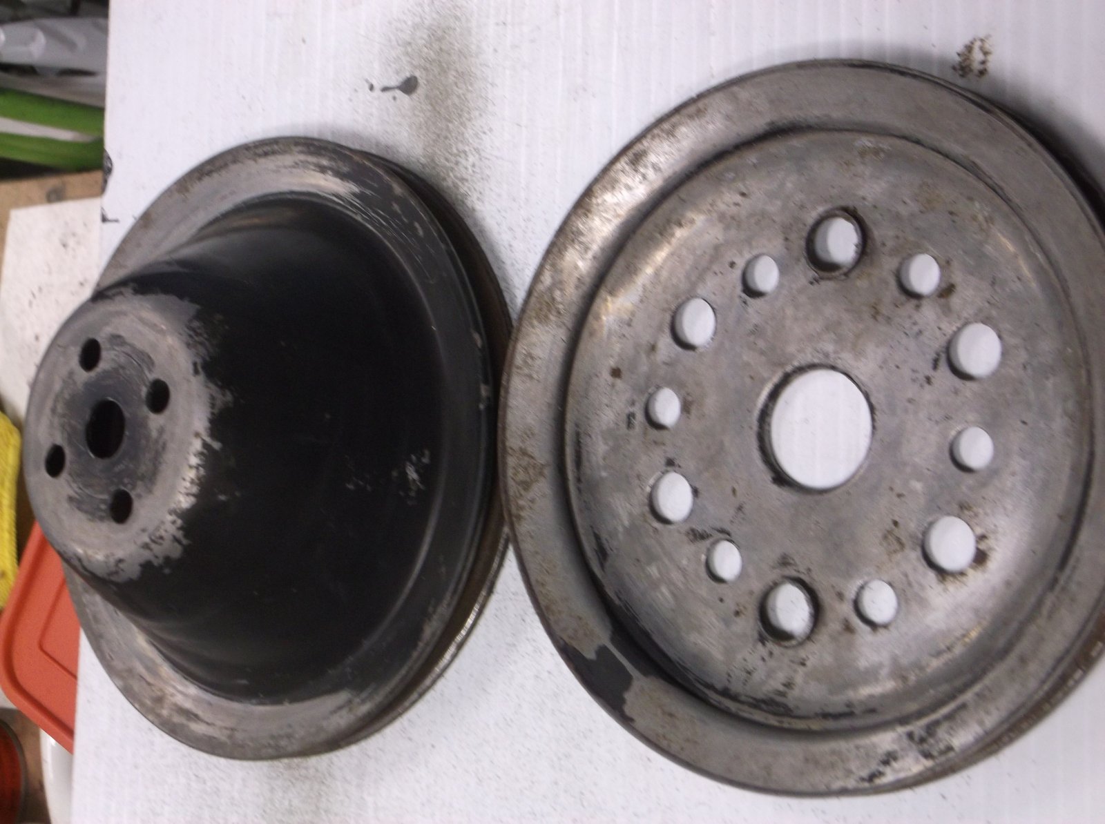

    I just cleaned up the pulleys from a '64 283 I'm hoping to save and the crank pulley is 6 3/4" and looks like yours. It doesn't have any numbers stamped in it and was bolted to a small, stepped dampener,also without numbers. This is a "D" code 2bbl, power glide engine.

    Any numbers on the top pulley?
  16. squirrel
    Joined: Sep 23, 2004
    Posts: 60,068
    squirrel
    3755820 crank pulley
    3905995 water pump pulley
    this is from the 1964 Chevy parts book
    Chev63 likes this.

  18. blue 49
    Joined: Dec 24, 2006
    Posts: 2,150
    blue 49
    from Iowa
    Pics of my dampener and pulleys. No numbers on any of them that I can see. The last pulley was piggybacked on the crank, maybe for power steering that I won't need.
    Gary
    Chev63 likes this.
  19. 05snopro440
    Joined: Mar 15, 2011
    Posts: 3,089
    05snopro440
    I bought the Summit pulleys for my 283 and for a 350 in my '62 Bel Air that I was converting to short water pump. I found the Summit water pump pulley was too big and would have slowed down my water pump. I used a stock 70's long water pump pulley on my short pump, it perfectly aligns with the alternator and crank pulley and is smaller diameter than the big summit unit so it doesn't slow down the pump.
  20. squirrel
    Posts: 60,068
    squirrel
    that's exactly what it's for.
    Cars with AC got a two groove main pulley. Cars with PS got the added one in front.
    Chev63 likes this.
