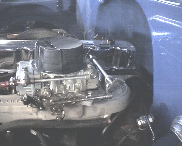

  12. Snarl

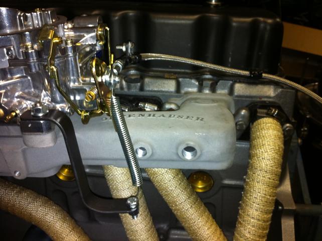

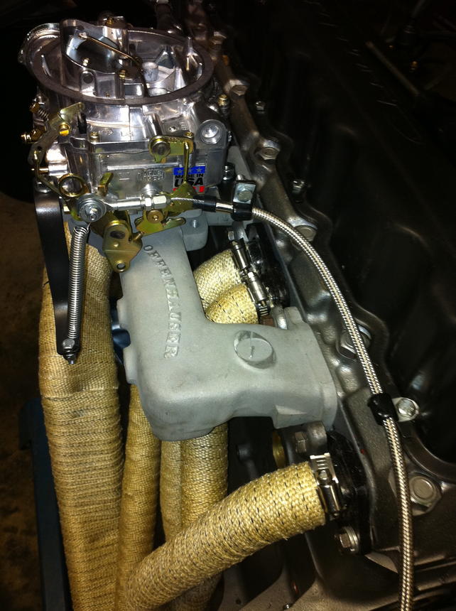

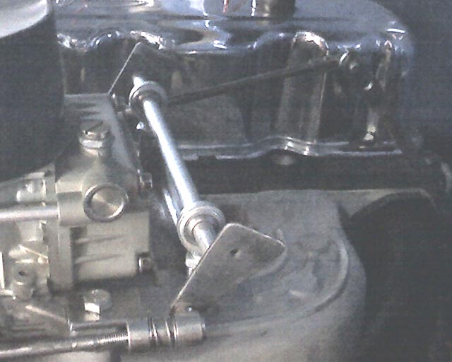

    Not sure if this will help or not (b/c I used a Holley).
    For more pics/info click here
    One thing that I had to do with the Offy bellcrank kit was shorten the cable sheath and buy a new cable. The cable that came with it didn't slide through the sheath well, even with wd40 sprayed onto it. If you have the same problem, bring the kit to a bicycle shop and they should be able to hook you up for a couple of bucks.

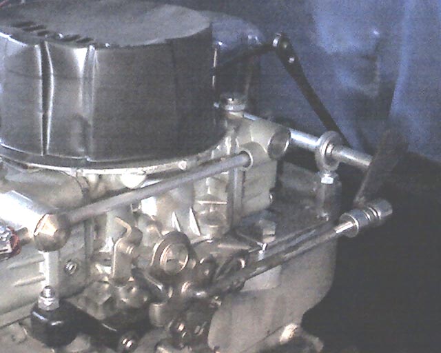

    Here's a 390 I ran front-to-back on a 250...

    In order to do that on an Offy intake, I believe you'll need to fab up an adapter plate.
  21. seacat95
    Joined: Jan 26, 2011
    Posts: 62
    seacat95
    That's a really nice Nova and thank you for the pics. That helps. I have the bell crank kit on the way, although they have it arriving Monday and the carb will be here Friday. I'm also thinking of going to the bone yard and pulling a factory gas pedal with cable set up and putting it in and either making my own brackets at the carb end or just getting one from the parts store as they are dime a dozen for Chevy set ups.

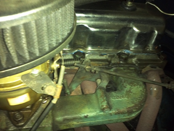

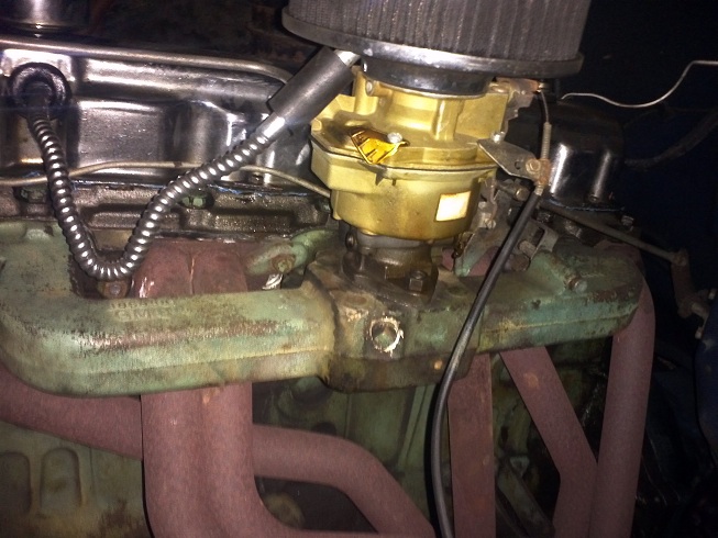

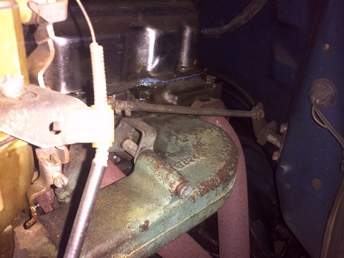

    After some head scratching I am thinking of hooking the cable to the pivot arm where the linkage rod goes using a barrel fastener. Then I would hook up to the carb like the last 2 pics showing a cable on the carb.

    seacat95
    I have the 500 Edelbrock and Offy bolted on and love it. Wow it's like a different motor. The 4 bbl really made her come to life. Thanks to all for the help.
    I did do some tweaking to my brackets for the cable after the pics were taken. We drove it up to the Hoedown and it did great.
