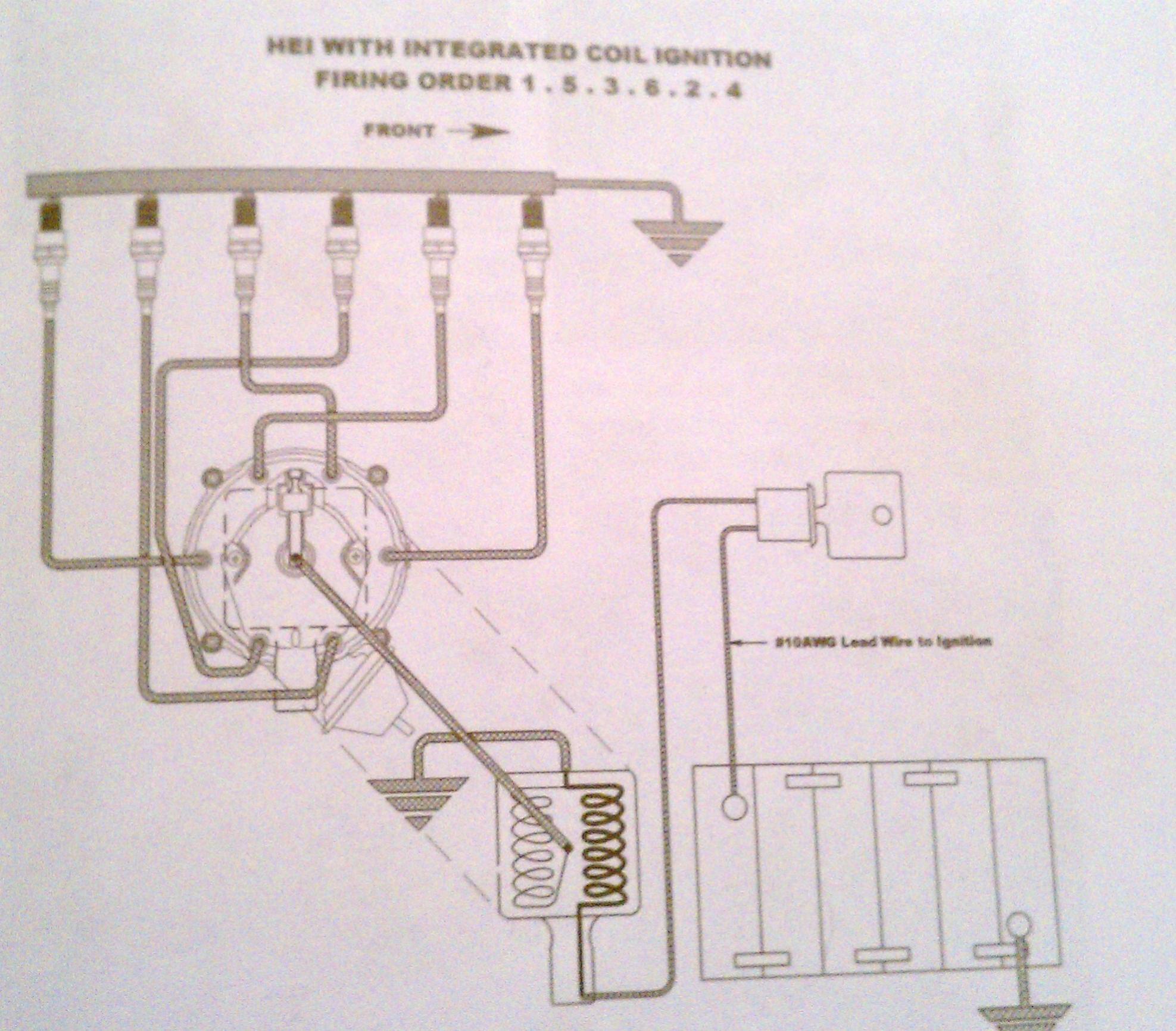

    i got the plug wire firing order sequence set at 1 5 3 6 2 4, when i look down on the distributor i assumed it turns clockwise? i figured this out looking at a diagram on page 125 of santuccis book.
    please dont tell me the distributor rotates CCW?
    i dont understand how it could rotate CCW according to this diagram?
  11. miky2001
    Joined: Nov 9, 2006
    Posts: 939
    miky2001
    from houston
    heres the picture i am talking about????

    the dist turns clockwise so you are on the right track there. i always drill 1/8" hole in thermostat to prevent air lock like suggested.
