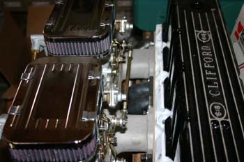

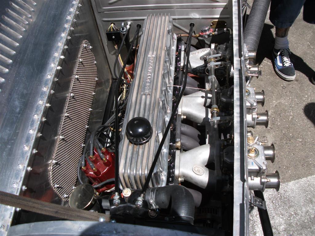

    Here are a couple of 292's that are producing over 260 hp on an engine Dyno.
    Normbc9
