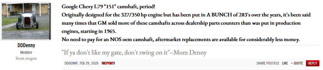

    So...yes.
    As DDDeny says, not a problem.
    One thing, depending on the heads that you use, is how the engine will run with that cam.
    With more, stock valved and no porting, the engine will be down on power, don't expect a lot.
    With larger heads and or larger valves in the OEM heads and some porting, especially on the intake side, the engine will be more responsive to that cam.
    A better than "stock for the engine" intake manifold will be a very good bet. Ported and or larger valved heads and a stock intake manifold, is like being choked.
    And one note, it might not be a good "stop light" combination. But with the rpm up a little, it should be a fun little engine.
    It will also need more than 8 to 1 compression too. Again, if the compression is low, it'll be a bit sluggish around town.
    Mike
