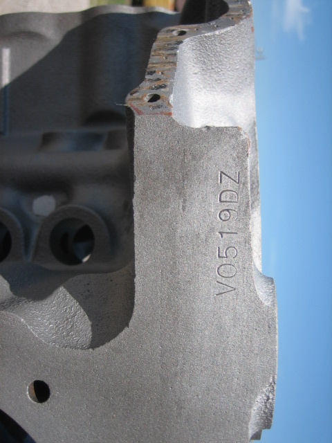

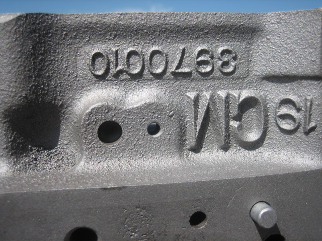

    from Texas
    302 DZ block and pistons from 69 Z28 bought new by Mike Batt Plano, Texas. Rods had a splash of pink paint. Factory stampings were often NOT even. Some were stamped on the oil filter mount also. Piston is a TRW forging with a GM part number (3927172). The 302 was a POOCH in a heavy car with shallow gearing---no torque.
    PICTURES: factory screw in oil galley plugs, block number, stamping, with windage tray, piston
