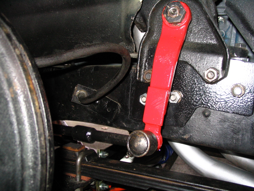

  25. waldo53
    Joined: Jan 26, 2010
    Posts: 863
    waldo53
    from ID
    I tried the mono-leafs too, rode like a lumber wagon! So, I went with a 3" axle from Sid, and rebuilt the stock spring packs final setup 003.jpg using only 5 leafs, with Teflon liners. To eliminate bump-steer AND get the steering wheel out of my face, I made a new steering box mount out of 1/4" plate which moved the steering box forward 2" and raised it about 2". I still had a little bump-steer so I modified the Pitman arm by cutting a 1" section out. The idea, as stated above, is to get the drag link level. So, with this setup, the truck sits pretty low, rides as good as any MII set-up I've ever had, and has zero bump steer. I also run a steering damper that you can get from NAPA.
    anthony myrick and HunterYJ like this.
