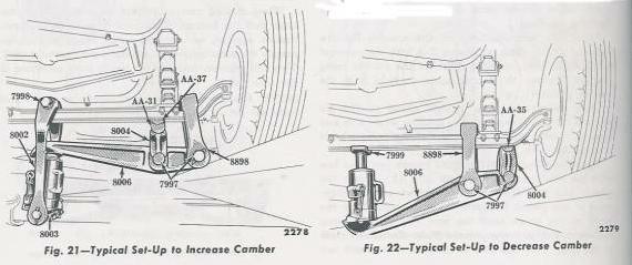

  1. you might could rig up something like this
    I have had axles straightened at truck shops here in Al
    there has to be a shop that can do this in your area

    I'm running the stock axle on lowered springs. My caster is shimmed and perfectly fine. It is the camber that is an issue. Nobody wants to bend the axle to make the tires lean in which is ideal for radials. The only shops equipped to do it are only used to working on large commercial trucks and don't want to work on a 66 yr old 1/2 ton.

  20. Coil springs is an option that probably has not been mentioned. You can use radius rods or a 4 link setup if you like.
    I have seen them also setup with coil overs although that would not be on my list of really cool things to do.
    To get your camber set the way you want it set send the axle to Sid's in OK. Those guys got it goin' on.

  24. SpikedLeatherworks
    Joined: Oct 5, 2005
    Posts: 62
    SpikedLeatherworks
    Thank you. That is a cool shot of the setup to do the job.
