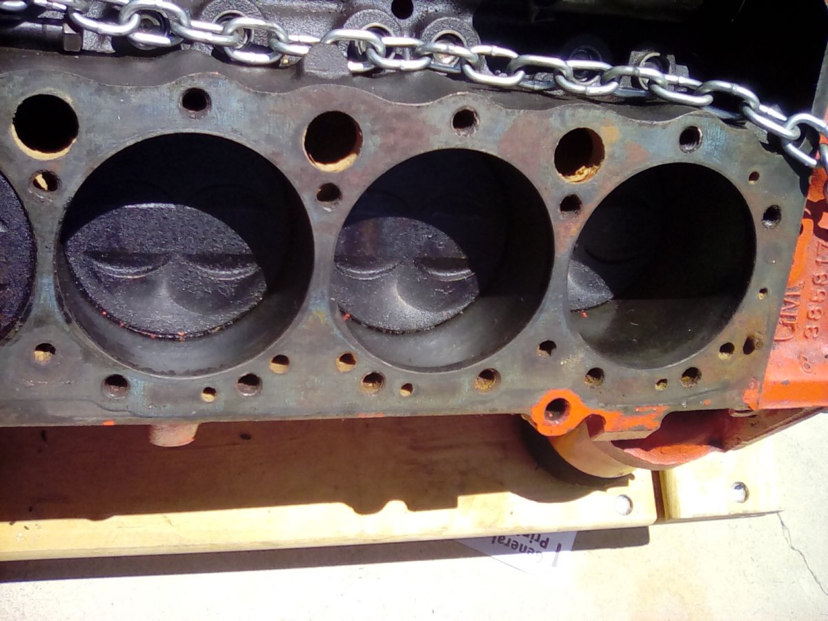

    Ok HAMB... I am considering buying a Chevy 327. The seller doesn't know a whole lot about the engine. He was going to use it for a project but ended up going a different route. He has stated the heads have been rebuilt and from the looks of it that is true. I wanted to get a better look of the bottom end. The heads were not tightened down yet so we removed them to get a looksy. As you can see in the pics there is some oily looking carbon build up on top of piston. Also a black smudge stain that is not easily removed on the cylinder wall... what would cause these two things??? Could this be why the heads were rebuilt? Other than what I noted there was a slight ridge at the top, no scoring on cylinder walls and nothing else obvious to me. Is this a sure sign to p*** on engine? What else should I look for?
    Not looking to rebuilt it... just want a reliable runner for a project.

    If there is a ridge 1/4" down from the deck, more than likely it's going to need bore work. What's he want for it? Good 327 blocks are getting hard to find.

    I see what I think is a 60 on one piston...if it is .060 its pretty near done if you cant use the current bore. Some may say they can go .080 or .090 but personally id find a block with more meat to start with...

    The "smudge" is actually RUST. It may "burnish" itself out once the engine is running again; I'd at least take some Scotch Brite to it and see if it cleans it up. The ridge is no big deal, unless it's deep. I've done plenty of Welfare Motors; ring and bearing job after I remove the ridge. Depending on bottom end wear, the ridge could break a ring land. What heads; Power Packs or Double Humps? I happen to have an abundance of NEW parts for 327's; pistons, aftermarket rods, cranks, cam/kits, etc; if you need anything, I'll make you a killer deal. I am Butch/56sedandelivery.

    That engine has been burning oil. See how smooth and polished the cylinders are? No sign of crosshatch pattern. The cylinders are worn, that's why the pistons have the oily carbon buildup on top. At minimum I would run a ball hone down the bores to clean them up. I'd at least clean the pistons up and re-ring them. New bearings and seals and you might get away with a low cost rebuild.

    The engine was definitely burning oil and if is already .060 over it won't last long if you hone and throw in some new rings. It might be worth $500 with the bell housing but I would shop around for a better core. 327s are great engine and can be made to run but you get more power and value with a 350.

  16. If it has been bored once (at least) and has a ridge, it has a lot of miles since the last rebuild. Boring again is iffy at best. I think the only reasonable route is to hone the cylinders, re-ring, new rod, main and cam bearings and run it. I don't think I'd pay 500 for this one.

    I probably wouldn't want to give 500 for it, but that is pretty close to core price these days. I have no way to actually determine the ridge but from here it doesn't look that bad and the oily carbony piston tops could have been caused by someone soaking it down to keep it from it rusting. If the cylinders are not worn too bad sometimes you can get by using forged pistons and honing to fit. Forged pistons require greater cylinder wall clearance, only running a mic on it will tell for sure. What ever happens with it the ridge will need to come out and it is not going to be a cheap mill when all is said and done. What desirable motor is?
