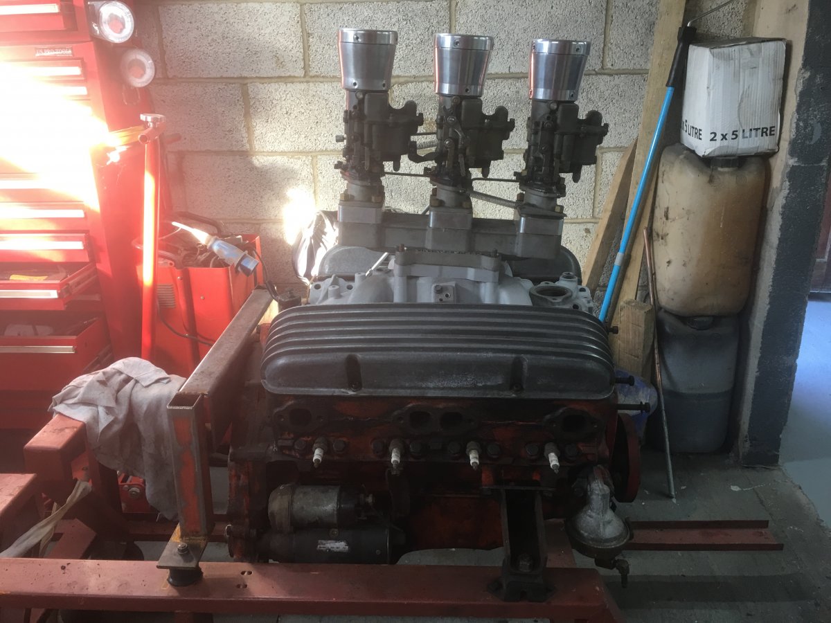

    This is how the motor is at the moment

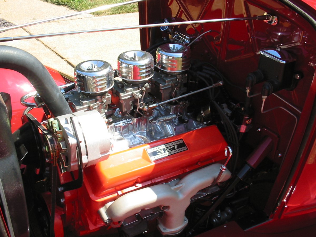

    I have seen those but that would mean more outlay.
    Would it affect the running with my setup or would it be better on a 3x2 manifold

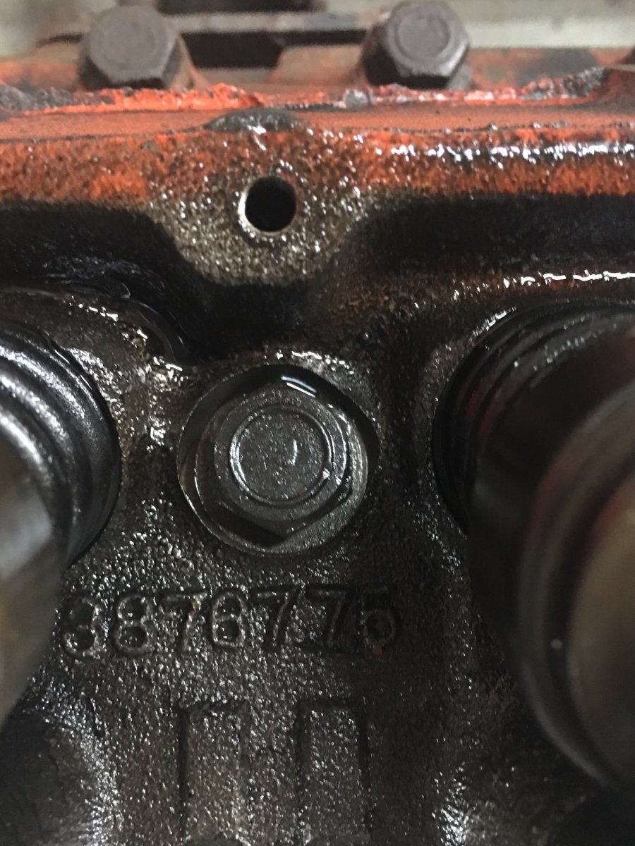

    It might help if you post the casting number of the heads you have now and the suffix number of the serial number stamped in the pad on the front of the right side of the block. That would let guys know what you are actually starting with.

    Heads read
    Block casting number and on the front pad it reads,V0822MF 7BFE47A5-A683-4942-9F1F-FF5BAEBCA143.jpeg
    If I’m right it comes out as a 67 Camaro 210hp

    Those are strange heads for a '67, but they did offer a 2 bbl carb 327 engine in a Camaro and maybe that's it. See if you can find heads with casting numbers that end in 441,461,462 ( and there are more) on your side of the pond. They also used that block for a 350; I'd pull one of those heads and check the stroke before going further.

    This is the 2bbl setup that came on it

    Most likely pro comp junk, I'd rebuild your stock heads way before wasting money on those things, also like was said I'd get rid of that goofy fake 3x2's looking thing in a heart beat, just looks like a joke wannabe laugh at me item.

    It’s a 3x2 adapter made by ‘vintage speed’.

    from So Cal
    I think you guys are too harsh on the 3 x 2 adapter. I think the added height it gives to the carbs looks good, a standard 3 x 2 manifold can look a little lost in an A engine bay. That baby will sit tall and proud between the radiator support rods. Plus, I bet on a good 4 barrel manifold that arrangements flows better than a standard 3 x 2 manifold. Of course, if you want it to look like everyone elses, forget all this and just get a 3 x 2 manifold...

    40 coupe, that 3x2 manifold wouldn't make for a decent door stop. Again I'd trash it and get yourself a decent four barrel intake and carburetor and forget about how something looks. To me performance always trumps looks and posing.

    I think that 3 by 2 adaptor looks like a monkey screwing a football. Later Bill :(

    The manufacturer’s name is Vintage Speed but that thing neither looks vintage nor is it built for speed.
    There are much better choices out there.

    Apparently these flow better than a generic 3x2 intake.
    I’m not after a high power engine.
    Saying that though, if this setup is detrimental to the longevity of the motor I’ll happily change it for the more common, same as everybody else intake

    If your not after performance, block off the end carbs on that deal and put everything else back to stock. Done. Lippy

    If you don´t need a lot of hp and want a nice running engine that is good on fuel, you could just use your 3 pot intake with the rear and front carb blocked off, a mild cam like at 218/218@.050 lift to get a nice bottom end on the one carb and make enough torque to haul that long rear end and large tires.
