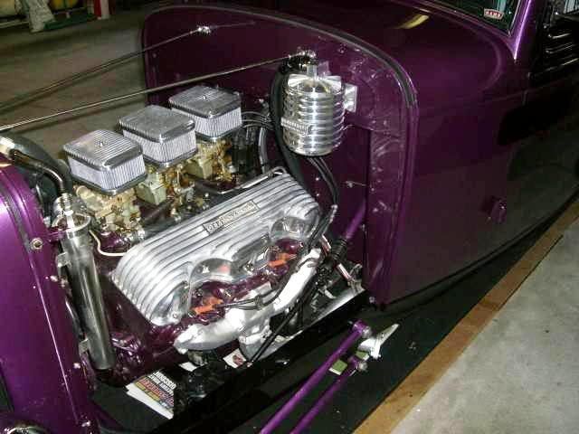

  13. NITROFC
    Joined: Apr 17, 2001
    Posts: 6,174
    NITROFC
    Here's mine ....:cool:

    NITROFC Do you know what kind of hp you get from yours and how/what did you use in your buildup of your motor. What is it that you have it in as well?
