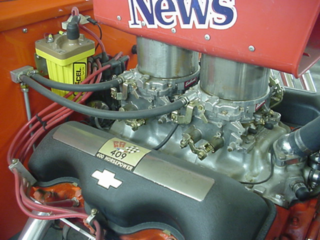

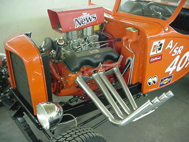

    Have read this thread and really learned a lot. I know that what I have done with mine would make most of you puke. I picked up a '61 348 from a farm truck. Run absolutly wonderful. Couldn't believe the size of the bell housing and flywheel. This engine was destined for a repop altered. I attended a swap meet at the Detroit fairgrounds and picked up a 409 snowflake intake for next to nothing... hooray. Now when I get the intake off my engine (having no idea what I'm doing) I'm looking at intake ports about 1" x 1 1/2" on the block, and about twice that on the intake. Drats, and I picked up two edelbrock carbs at the same meet. Double drats. After this project set for a while I ran into a fellow that told me how to make "em fit. Like I said, somebody's gonna puke. I cut off a couple of bolts, screwed 'em into the block with lok ***e, bondoed over the dimples, sanded it smooth. slightly rounded off the ports in the block, gooped up my gaskets and squished everything together. Musta been at least .040 of gasket between things. Oh well, It's been on the road for three years and hasn't done anything stupid yet. I was thinking that two edelbrock 650's would drown it out, but to my surprise it runs very good, with extremly quick throttle response. Only ignition change was to get the governed distributor out and replace it with a stock points type. So far The only problem was a failed condenser, other than that....Yee- hahh. Norm
