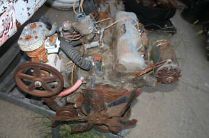

    So after soaking the pistons in Kroil and the crankshaft/rod ends in 50/50 acetone and ATF, my lack of patience got the best of me. After a week of rocking the crank back and forth I couldn't hold off any longer, it just had to come apart. I began by cutting each connecting rod approx. midway with a sawzall. I know it's probably not the most conventional method, but I took my time and thought it was probably better than stuffing a torch head down the cylinders and creating a bunch of unwanted heat and slag. Once the connect rods were cut I was able to "roll" each crankshaft end of the connecting rods and remove them from the crankshaft. Once that was completed, I was able to remove the crankshaft. Next came the fun part, removing the pistons. After about 2 hrs of beating on the underside of the pistons, I managed to remove all of them. Cylinder walls actually don't look too bad and they appear to be stock bore.
    So all of this leads up to a question. The camshaft is stuck, really stuck. Anyone have any suggestions on removal? Aside from removing the "plug" on the rear of the block and "persuading" it out, I'm out of ideas. Thanks for any input and suggestions.

    Do as planned, remove the rear cam plug and start bumping the cam back and forth, use a block of hardwood, don't hit the cam directly with a hammer. If anything it will pull the cam bearings with it.
    If your torch head will fit, give the cam bearing area of the block some heat. The hot/cool cycles will help break things loose.

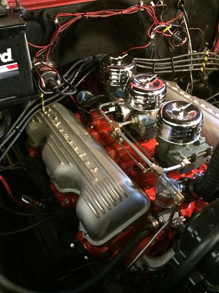

    Keep the faith. Mine, before and after ($3K later).

    That's a good looking 348. If you don't mind me asking, who'd you use for all the machine work/rebuild?

    Did the lifters come out?
    Can you build an extension from s**** steel and bolt it to the cam to get leverage to help turn it back and forth?

    I've attempted to pull a few of the lifters, but they're in about the same condition as everything else, stuck. I have tried rotating the camshaft from the end with a 2' pry bar, no movement. I'm going to keep working at it and see if I can get things to free up. The lifters will probably need to be driven out once the camshaft is out.

    Chances are that the lifters are holding the cam making it more difficult to move. last one I did I ended up driving a steel wedge between the cam lobe and the lifter forcing the lifter to move up a bit. In my case I knew I would not use the cam or lifters again so I wasn't worried about damage. I had used lots of PB Blaster on the lifters and after the wedge deal got them to move enough to get them out after the cam came out. Most of them I drove out and into the pan.

    I had an early desoto hemi that was the same way with the cam and lifters. I took the block to the machine shop and had them put it in their hot tank for a while. Went back and picked it up a few days later and had the cam and lifters out in 15 min. Well worth 45 bucks for the soak in the hot tank.
