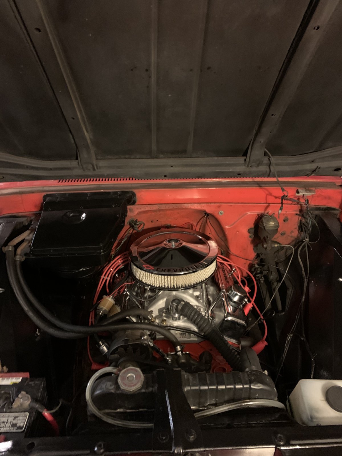

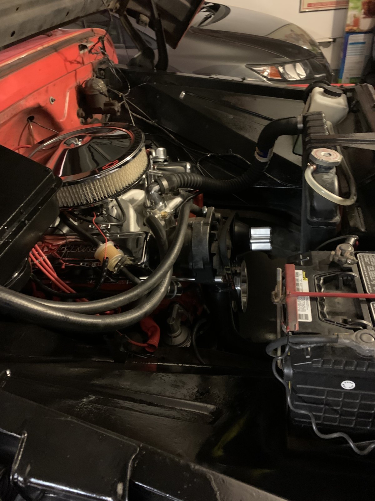

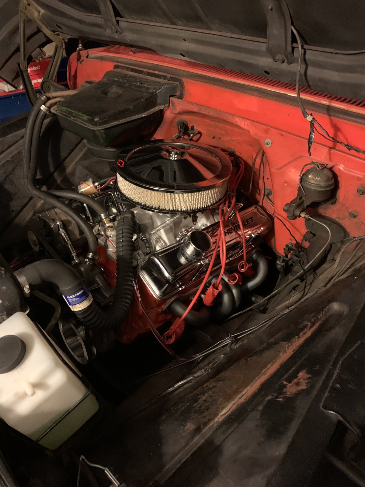

    Hey so I started a thread from a 250-350 swap that was just completed a week ago. Thank you too everyone that helped out on that and I have pictures here with some videos. Just waiting on radiator fan and downpipes. Anyways I’m wondering how involved a cam swap would get and if it’s worth it. I want to have a more choppy idle and I don’t want to do a rebuild. I’m looking somehwere in the 500-700 for everything so cam, pushrods, new seals, etc. Was wondering if anyone had good suggestions

    I actually just found this cam it sounds great. The motor only has a couple thousand miles on it and it runs smoothly so I don’t know if I’d have to upgrade anything to run this cam
    COMP Cams K12-212-2 Magnum 224/224 Hydraulic Flat Cam K-Kit for Chevrolet Small Block https://a.co/d/1zlugy0

    What is your compression ratio , what pistons , what cylinder heads , what's the quench measurement , what intake & carb , what trans , what stall converter , what rear gear ratio , what is your primary use for the truck ?

    i have seen that cam used in a lot of stock engines, it's ok and runs better then stock fore sure. but i think you would be better with the comp cams 268 high energy or the 270 magnum for your choice. i have a 350 with dish pistons and open chamber heads, the heads have had a lot of port work. i installed a 292 magnum cam (what i had), it will run, but it will also burn your eyes with the raw gas out the exhaust, it needs more compression fore sure.

    That cam has an advertised duration of 280º. That is a lot for a strictly street vehicle.
    It will take away from a fair amount of the bottom-end torque, and move it up into the higher RPM range.
    That is not the best thing, especially if you are planning on driving this daily. Not that this thing is going to get great mileage anyways, but that cam will cause you to have to lay into the throttle more at low RPMs to get it moving. You will be using more fuel as a result. It looks like you might be in coastal California. Fuel ain't cheap here. Losing 5mpg for sound will add up quickly, and it won't stop adding.
    Sounding cool is one thing, having a vehicle that is comfortable to drive anytime, anywhere, if a far bigger thing.
    I might look at muffler choices to improve the sound.
    I'd get everything else settled, and drive it until Summer. See how you like it the way that it is.

    Buy or borrow a compression gauge.
    Disconnect the coil power wire. Pull all of the plugs, and prop the throttle blades open with a large screwdriver.
    Test the compression.
    In this case, you are not looking to see what the condition of the engine is. You need the number.
    Take that number, let's imagine that it averages 135psi across all cylinders.
    Divide that 135 by 14.7 (atmospheric pressure at sea level, ***uming you are about that).
    That gives you 9.18.
    We're the 135 number correct, and you are at or near sea level, then that is about your compression ratio.
    This number, of course, is not truly accurate, as it is subject to a number of other conditions, far too numerous and detailed to cover here.
    The real running dynamic compression ratio will be 10 - 15% less than that, so more like 7.8 - 8.62:1.
    This plays a HUGE role in choosing a cam.
    I will bet good money that there are more people running the wrong cam in their engine than there are the right one.
    What town/city are you in? I will look up the average elevation.

    Antelope Valley goes from about 2,100 to 3,000 feet above sea level. For simplicity sake, we will need to split the difference at 2,550 feet. Also for simplicity sake we will need to call it a clear and dry day, at 60ºF.
    With those standards set, atmospheric pressure where you are is approximately 13.40psi.
    Take your compression readings and divide them by 13.40 and you will get an approximation of your compression ratio, with the above and previously mentioned caveats.

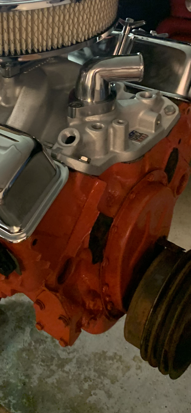

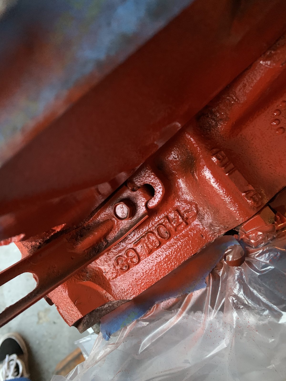

    What of the history of this engine do you know?
    Is it stock? Rebuilt? Modified? Crate?
    If it is a stock engine, or a stock rebuild, can you get a picture of the pad on the front of the block that sticks out in front of the p***enger-side cylinder head?
    The width will vary by year, and some of the pads have a partial VIN stamped on them.
    The key code on these should start with a letter, F, H, K, M, S, T, V, indicating the engine plant.
    Then two-digit month, followed by two-digit day
    After that you will find the important info, the Engine Suffix Code. That will indicate the vehicle-of-origin, and possibly the current configuration. That may be a two, or three letter code. If it is a three-letter code that starts with a T, then the block, at-least, started out life in a truck.
    The pad looks like this, and varies a bit era:

    Yeah the mileage is terrible however the timing is off, the carb hasn’t been tuned, and there’s no exhaust just straight headers so everything’s playing against it. I cruise 55mph at about 2000 rpm. Spark plugs are brand new

    From what I researched online this came out of a 69-73’ Camaro that’s LA built? Said 2/4 bolt rear main and then it makes 250-300 horsepower. Engine has about 10,000 miles and has never been rebuilt. Was swapped into a 73 Monza then pulled and sat for 15 years

    I’ll have to look tomorrow after work but it doesn’t seem like there’s any stamp on there
