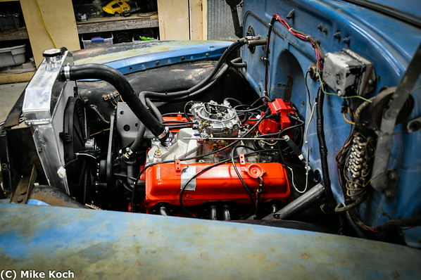

  2. Coach529
    Joined: Sep 6, 2012
    Posts: 437
    Coach529

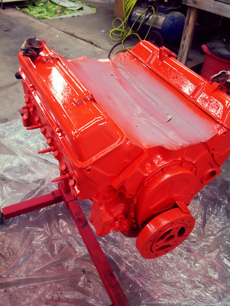

    Motor is now orange......
    And my Lokar shifter showed up.......whoohoooo

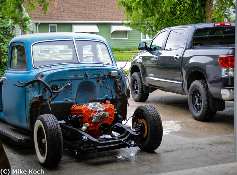

    Pretty good day despite distractions and multiple trips to the hardware store.
    Got the bolts to mount up the flex plate and got the ****** attached to the motor.
    Everything went together fairly smooth.
    I did overlook during mockup that the fuel pump would hit the frame. A quick cut with the jig saw and some grinding and it was fixed.

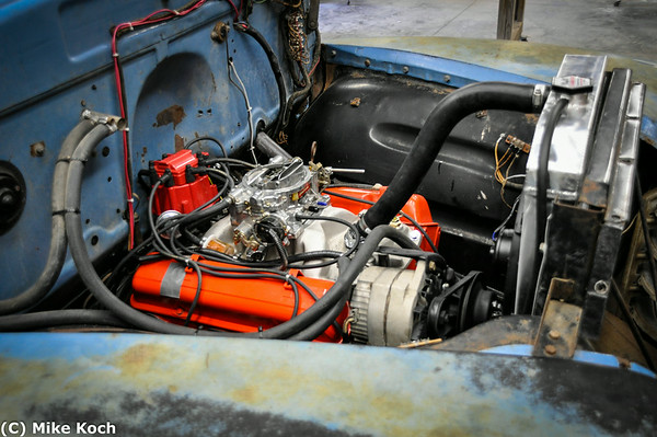

    Spent the last couple nights in the garage trying to get tings ****oned up.
    Last night I got most of the wiring done.
    I mounted the Lokar shifter. Looks I will need to buy the additional kit to ket the shifter a little further away from the seat. I have 3 people in the cab fairly often......the leg room can be an issue.
    Today after work I crawled under 20+ mid 70's 2 x 4 chevy and gmc trucks looking for a driveshaft and yoke for my TH350. Found the yoke, but no driveshafts.
    Also found a good donor for a long pump and alternator brackets!!
    When I got home I cleaned everything up and gave it a rattle can facelift.

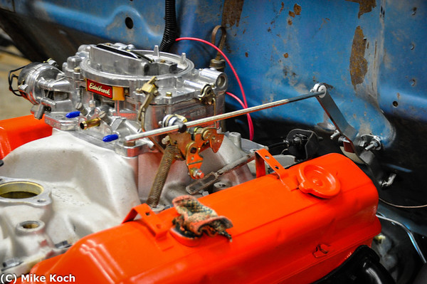

    I mocked up my throttle linkage, along with bolted up the bracket for the TH350 kickdown cable. The cable itself is short. Not the housing, it reaches fine, but the physical cable seems to short even after adjusting it.
    I ***ume they come in different lengths?
    I am pretty happy with the linkage, although the pedal sure feels different than compared to the old 6 cyl carb. Pedal travel is minimal.....

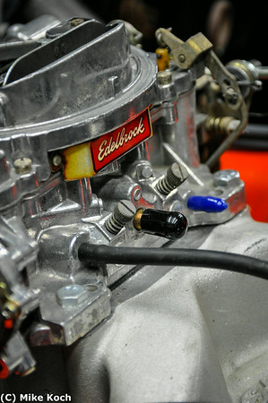

    WE HAVE A RUNNER!!!
    Today was the day.....fired it up!!
    Work has been a real ***** lately.....so time to work on Henry has been tough to come by. Slowly but surely, I was able to ****on it all up and do a test fire today.
    Fired right up and we were able to time it and do some tuning on the carb.

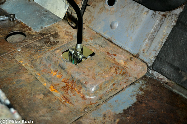

    Another solid day on the conversion.

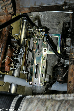

    Got my Lokar with Bell Crank kit all installed. Pretty slick set up. Happy with the install. Pumped it all fit through the stock floor hole.
    Ordered a custom driveshaft on Thursday. It was supposed to be done on Friday at noon. Drove 85 miles to Fargo and the guy forgot to build it.......UGGHHH. Supposed to be done on Monday now.

    Which lokar shifter did you did you go with? Do you have a pic of how it turned out inside?
    I am getting ready to order one and have been thinking of going with a double bend 32".

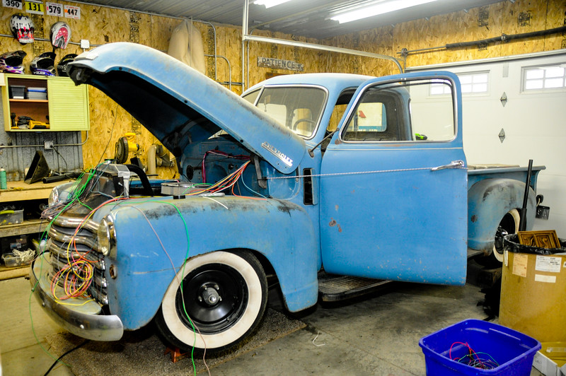

    Finally got started on the wiring. First things I did was gut all the old wiring out!! It did not take too long.
    After that I laid the new wiring and removed circuits and wires I would not be using. I installed the fuse block under the dash and starting pulling wires to the appropriate areas.
    After the wires were in the area's I tackled the dash. It is always nice to get the toughest stuff out the of the way first.
