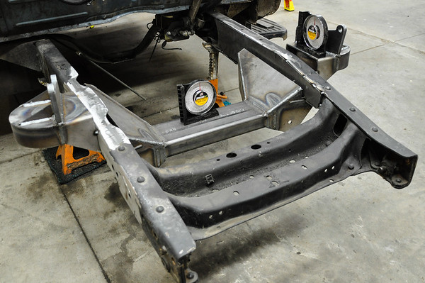

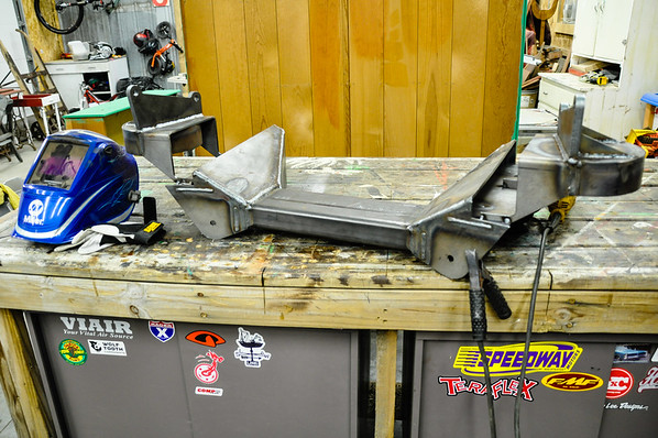

    After measuring.....then measuring again, checking the level, then measuring again.....I finally go the cross member tack in.
    Should be able to finish up the welding on the top half this weekend if all goes right. I then will mock up the motor and see if I can use the existing transmission cross member, or if that will need to be moved or modified. Hoping I do not have to modify my floor to clear my transmission. One I get that all done the can will come off and I will flip the frame to do the welding underneath.

    I had a couple hours available today and was able to ****on up most of the install cross member today!!
    Next step is to pull off the cab and flip the frame and finish up the welding on the bottom side.

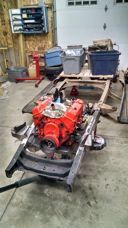

    Joined: Sep 6, 2012
    Posts: 437
    Coach529

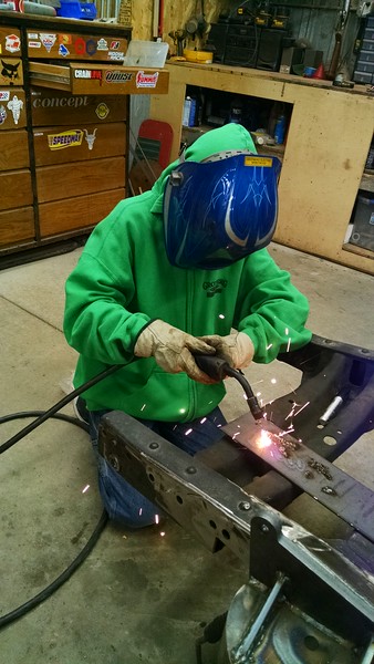

    Stellar day in the shop today. Started out with some welding lesson's for my oldest son Ryder. He showed a ton of interest, so I figured might as well get him comfortable with the machines. Got the hang of it real quick. He welded up a bunch of s**** for the fun of it.

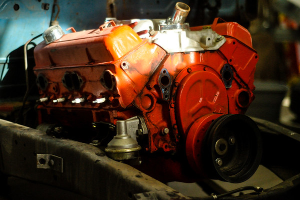

    After that Ryder helped my get the motor back in place so I could figure out what I needed to do for motor mounts. Sure if a lot easier placing that motor and ****** with an extra set of hands.

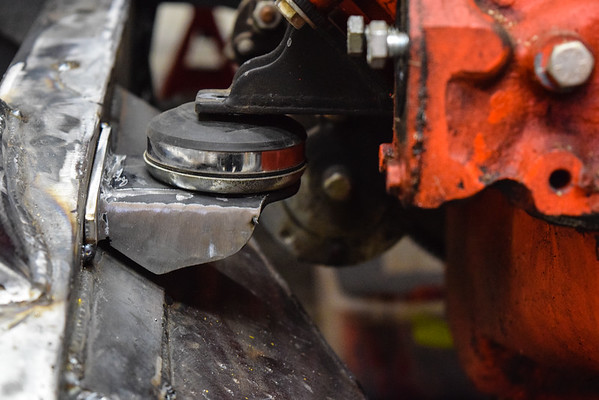

    I used a set of Ch***is Engineering Motor Mounts when I originally installed the SBC. I was hoping to reuse them.
    http://www.ch***isengineeringinc.co...evy-into-1940-1954-chevy-gmc-1-2-ton-pick-up/
    I was concerned about the placement of the motor above the cross member. Sure looked like the motor would be placed higher and I was nervous about having to modify the floor of the cab to make room for the transmission. Once we got the motor and ****** in place It looked a lot better.
    I modified the motor mounts and motor placement is about 1/4" higher than it was before. The intake is sitting at about 3-4 degrees without the full weight of the motor on the mounts. I think the full weight of the motor on the mounts will get me within the 2-3 degree spec. If it does not work, all it will take is a small spacer between the transmission and the cross member to get where I need to be.
    The next step is the pull the motor again and final weld the motor mounts. After that the cab will get pulled and I will start on install the rear IRS.

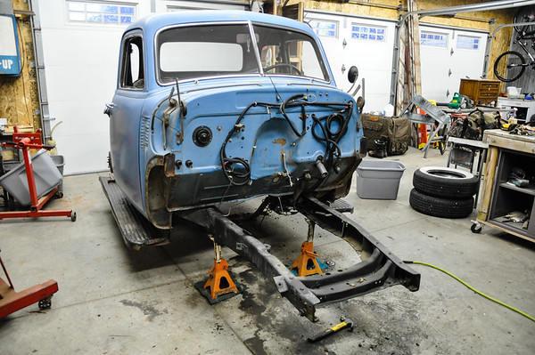

    Had a spare 30 minutes tonight before supper tonight......Just enough time to finish pulling the cab.

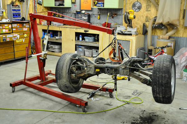

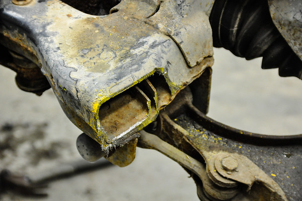

    Finally drug the rear end in from the driveway.
    The front mounts were trimmed off and will be boxed in.
    Inside to inside on my boxed frame is 31". I trimmed the back mounts on the IRS to 31".

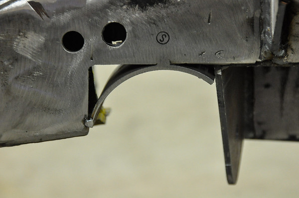

    Nothing huge accomplished the last couple days. I kind of butchered the relief for the rack and pinion, so I worked last night to close that up neatly. Use some 4" pipe and some 1/8" flat plate. 4" holesaw was also used......damn I need a Plasma Cutter.
