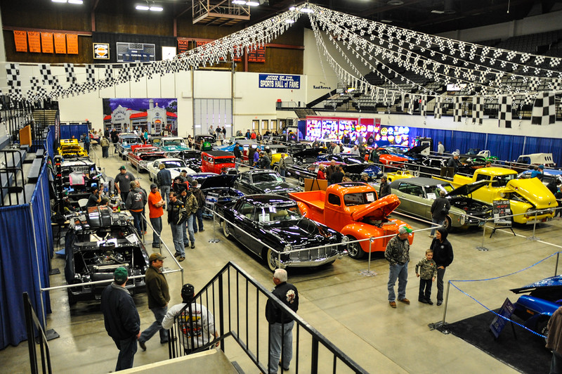

    I took my boys to a small local car show. Kind of neat. This '72 was super clean, LS on air.

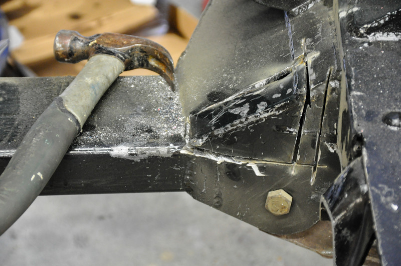

    I spent a bunch of time going over the ****py factory welds on the Ford Cross Member. 90% of the factory welds look horrible.
    Next step is to pull the rear end out of the cross member and flip the frame. Final weld the bottom side and then ready for paint.

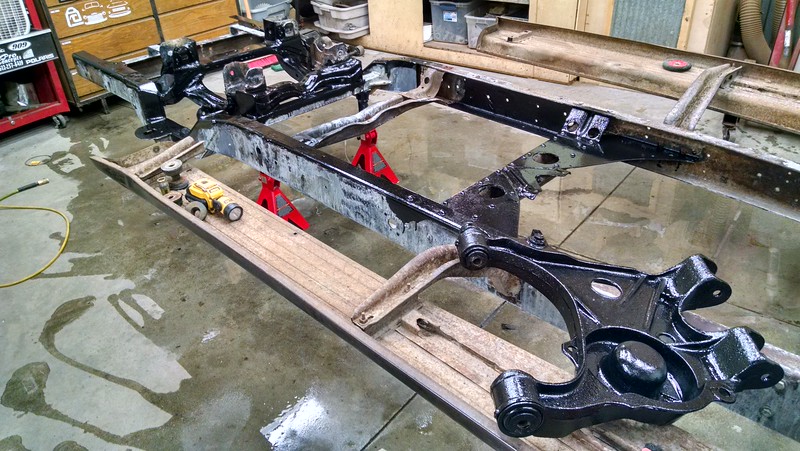

    Frame is finally painted 100%. There will be some touch ups, because I still have some misc welding to do. Shock mounts, mounting the rack and pinion, etc.
    I had some rubber belting, so I whipped up some cab mount rubbers with a hole saw. Cheap and quick.
    Air Compressors are mounted, also got the rear LCA's mounted and the center section of the dif.

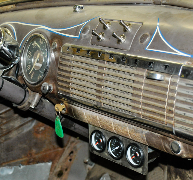

    Manual Air Ride switches are mounted as well as my 3 gauges.

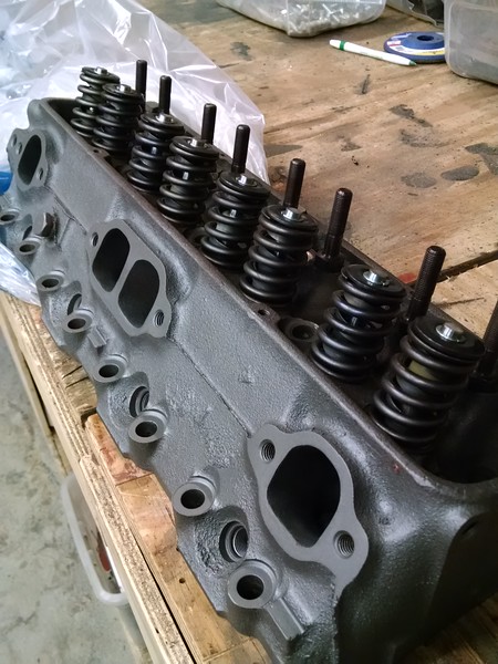

    Not much new to report. Waiting on my rear knuckles to come back from the machinest and some fab parts from my local fab shop. Those parts should allow me to be back to a roller and finish air ride install.
    Picked up a set of reworked heads from a local auto repair shop that had done some work for me in the past.
    They are 601 heads totally reworked. Deshrouded, fully ported, SS valves, whole nine yards. Price was right so I snagged them. Should wake up the SBC a bit.

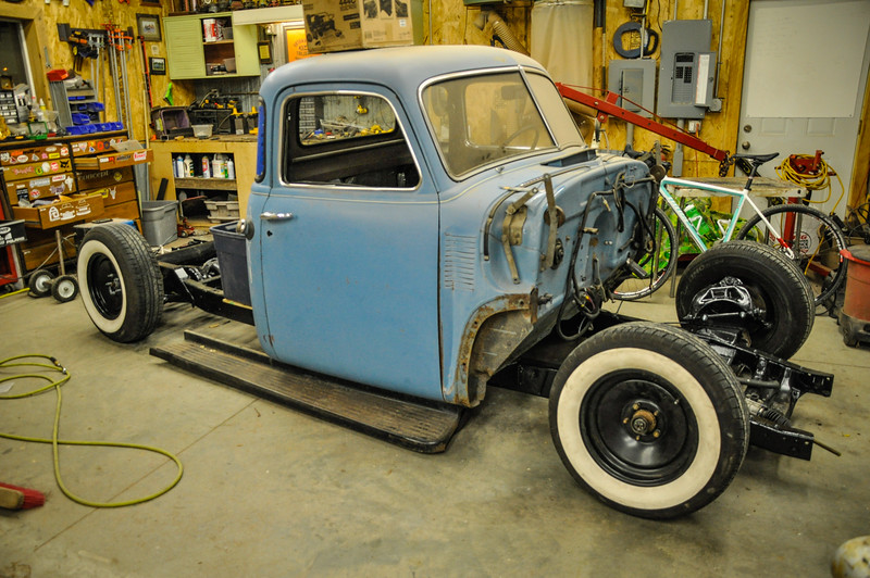

    Super busy day.
    We now have a roller. Such a great feeling.
    My Knuckles showed up from IRS Machining today. They look great!! That allowed me to ***emble the rear suspension.
    I am about 1/2" to 3/4" higher in the rear than during mockup, which I found out to be the difference in the stock T-bird wheels and my Cragars and WW. Looks like I could easily take 3/4" out of my lower cups to get lower. Now sure if I will or not. The only part that really bothers me is the running boards are not parallel with the ground at air out. Kind of a pet peeve of mine. The back either needs to come down, or I need a bumpstop to raise the front 1/2" at air out.
    The front is all loose mocked up. Just enough to roll.

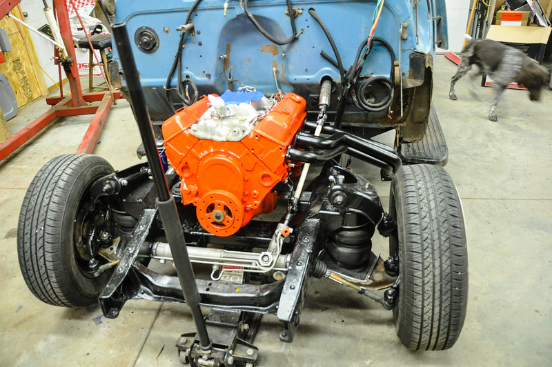

    I spun spun him around and put the 350/350 combo in to the rack and pinion mocked up.

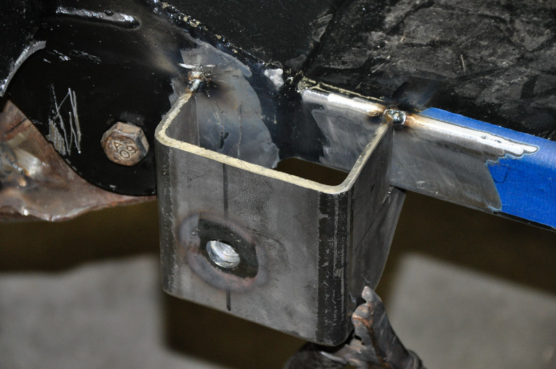

    The mounting on this rack was offset to the drivers side which makes mounting a bit more troublesome. I picked up some 4" x 4" x 3/16" tubing to make some mounts out of.
    Scott suggests a 3" notch to clear the rack. This WILL NOT work with a Ford rack. I had to open up my notch to almost 6" to clear the Ford rack. Frustrating to cut apart something that was finished.
    I had to remove some material on the p***enger side of the crossmember to clear the rack. I got a little overzealous with the skinny wheel and sawzall.
    mock up
    Making brackets
    Tacked in
    Fit test. I did end up opening up the notch after this.
    Both side welded in and the relief boxed in. I just need to rebox the bottom of the notch!!

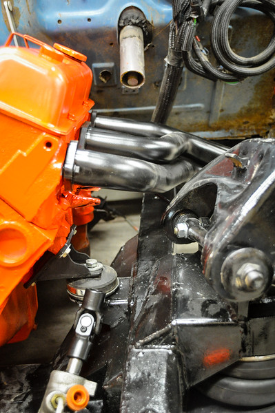

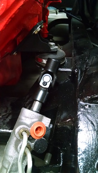

    Busy weekend with family and kid obligations, but I did manage a couple hours in the garage.

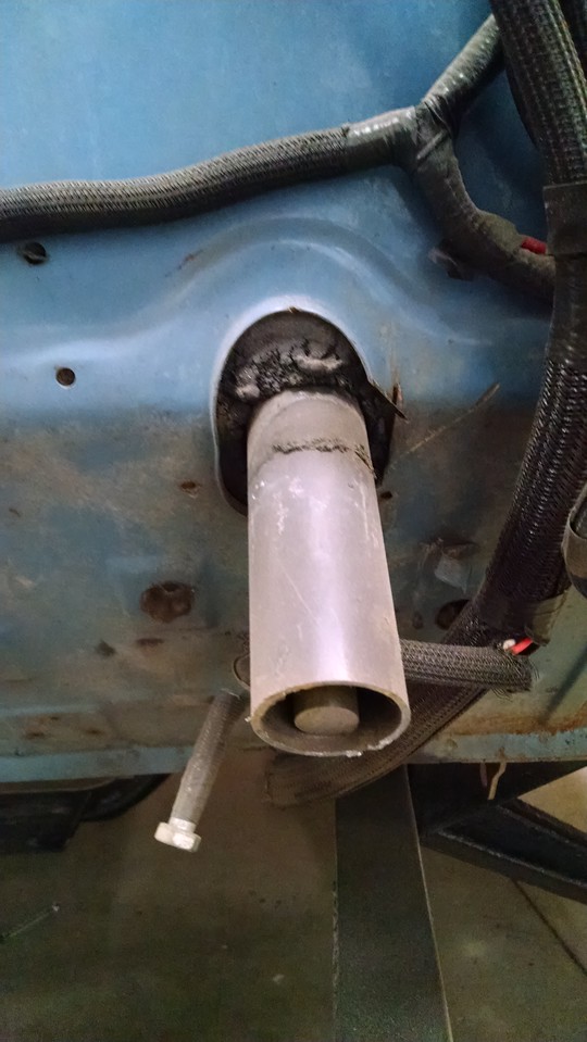

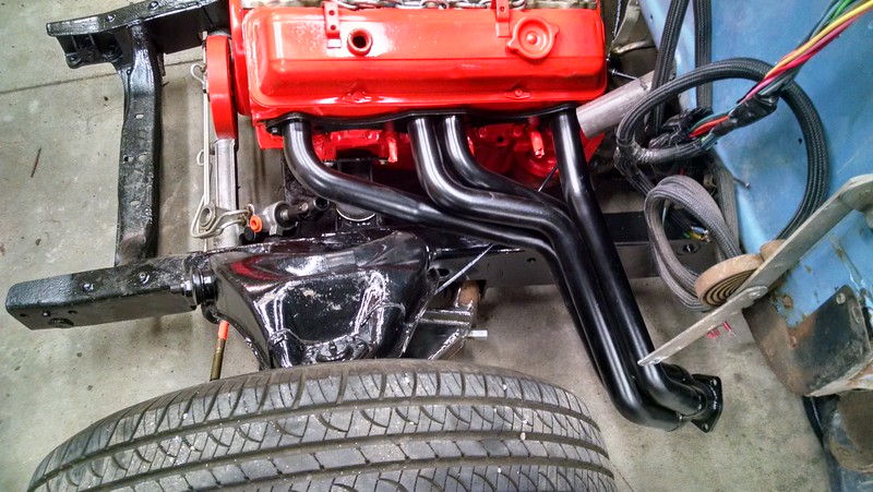

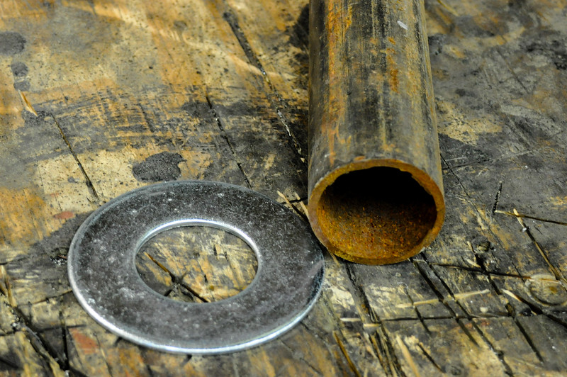

    I was pretty nervous about the steering set up before I even started. The input shaft of the rack was aimed right at my drivers side motor mount.
    The headers I am running gave me a couple good sized openings to get through.
    When it was all said and done it was not as big of a deal as I had dreaded in the first place. I modified the motor mount a bit so the bolt hole was closer to the block. This required extending the mount a couple inches and cutting the biscuit. Once I did this it allowed the clearance I needed.
    I mocked it up with a piece of dowl rod and it works great. Now I am going to pull the motor and weld up the modified motor mount and paint the area. Once that is done hopefully the motor will go in to stay.

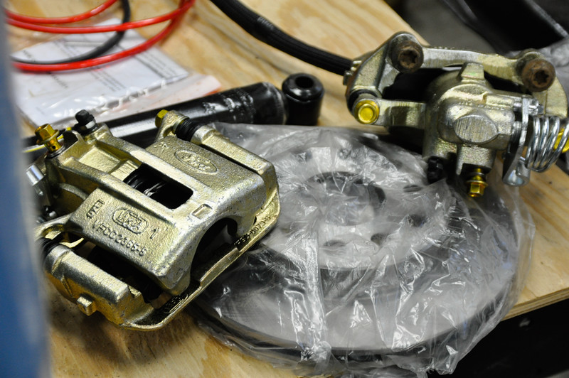

    New parts are arriving daily.
    New rear calipers for the Ford 8.8.
    CPP Firewall mounted Brake Booster.

    My header really melted out the original grease in my Borgeson joint that is beside it. I put a bunch of high temp red grease on it and it fixed it. Never has been a problem since.
    Don't know if you'll have that problem. Mine is manual steering and it had a catch in the steering when the grease melted out.
  27. Coach529
    Joined: Sep 6, 2012
    Posts: 437
    Coach529
    Thanks for the heads up. Maybe a little header wrap in that area will help.

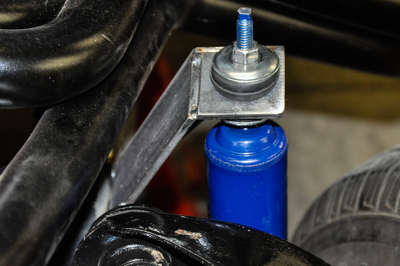

    Spent the night trying to figure out front shock mounting. I kept thinking about straightening out the shock a bit, rather than leaning it back towards the frame. I took some 2" flat and bent it up and put a quick gusset on side to brace it and tacked it on the frame.
    First I bolted the shock to the side of the LCA but I was not happy with the minimal clearance. I then made a quick mounting tab and tack it to the LCA and that gives me almost 2" of clearance when the spindle is on the stop. I might bump the bottom of the shock out towards the ball joint another inch or so.
    I plan to gusset the other side of the mount as well as build another mounting tab on the LCA.

    Pinned with roll pins and started welding.
    Motor back out and the modified motor mount was final welded, as well as the shock mounts.
    After all that.........it got a coat of paint.....
