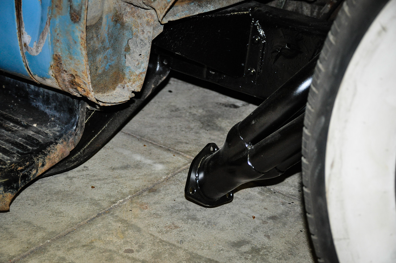

    Bolted the headers on while air out......which brought up another obstacle.
    Looks like I will need to get creative with the exhaust. I had plans if running right below the frame and exiting out wither the running board or the fender in front of the rear wheel.
    Plan right now is to get a 2-1/2" dia ,mandrel bent 45 degree and cut the flange off the collector. If I can get it that welded in parallel to the ground and pointing towards the inside of the truck slightly I should be able to make it work.

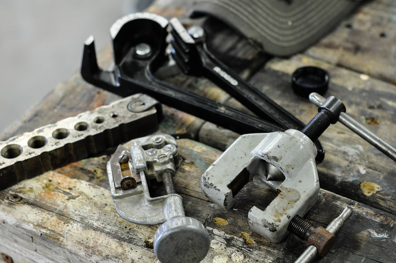

    I am not sure why.....but I really hate bending, cutting, reaming......flaring brake lines..........I guess I just really hate doing brakes......

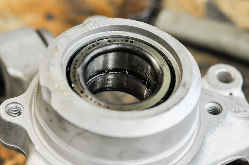

    Having a heck of a time with one of the rear knuckles/ hubs on the IRS set up. Once torqued the bearing has a ton of drag. After pulling it and reinstalling it a couple times and having the same result, I swapped it with the other side today to make sure the problem was the bearing. Same result on the other side. New bearing is junk. I need to pick one up and reinstall.

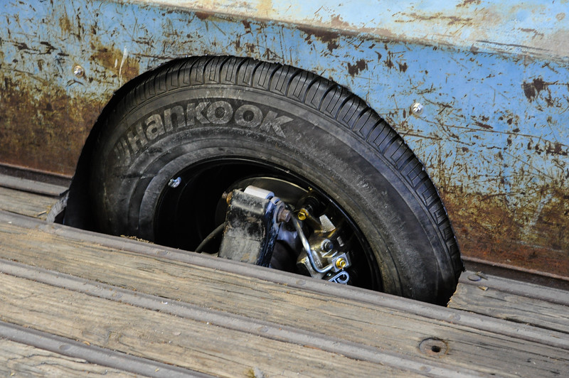

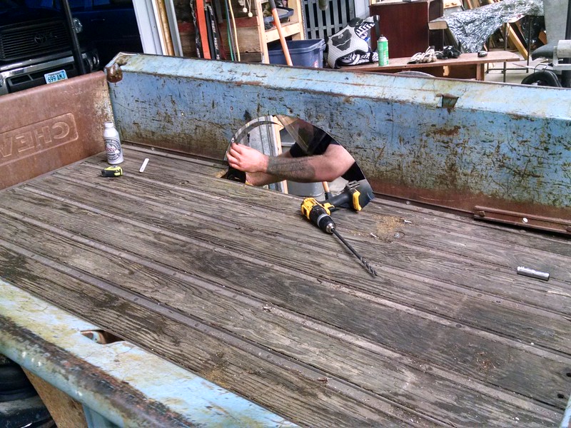

    I had some help and we got the bed sides cut out for the wheel and UCA clearance and got the bed mounted.
    I did not anticipate removing so much material. The bedsides clear the tires now but just barely. I will probably take out a bit more to have some clearance. I will also have to remove some of the fender flange.

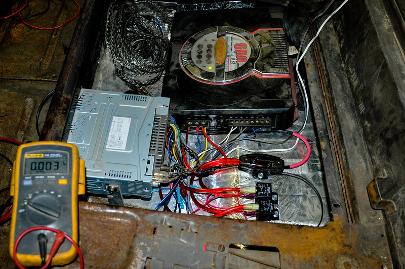

    Not much photo worthy to report. Getting everything wired up. Battery will be in an old Hamm's cooler in the box. Running battery cables, etc.
    Relays for my compressors are under the seat with my stereo stuff.
    Chasing some leaks in the air system. So far I have a couple in the fittings in the air tank,

    looks like wheel spacers would of saved you a lot of work
  15. Nostrebor
    Joined: Jun 25, 2014
    Posts: 1,333
    Nostrebor
    It's IRS, so I ***ume that it's tucked in at the top at full dump. A spacer may have him pushed too far out at ride height or at full lift because of the range of travel of the IRS.
    One of my favorite threads to follow. Your photography is top notch, which makes the thread extra leet! I have a 54 on deck waiting for my workshop to go up. You are causing me much agony over which way to go on my ch***is.
  16. Coach529
    Joined: Sep 6, 2012
    Posts: 437
    Coach529
    Spacers might have worked. I have close to 1.5" of clearance from the tire to the outside of the fender at ride height.
    Regardless I still would have had to provided clearance for the UCA's at air out. Decided to bite the bullet and open it all up now in case I decide to put wide rubber on the back at some point.

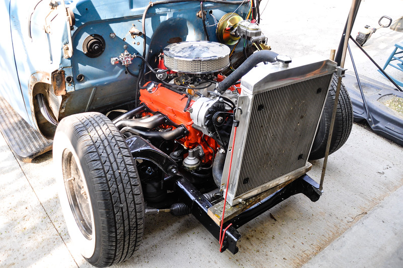

    I have been doing a little tinkering as time allows. I got my fuel pressure regulator mounted to the firewall and got all the lines ran.
    Yesterday I spent a little time rigging up a temporary radiator support and we fired up the SBC for the first time in the updated ch***is.
