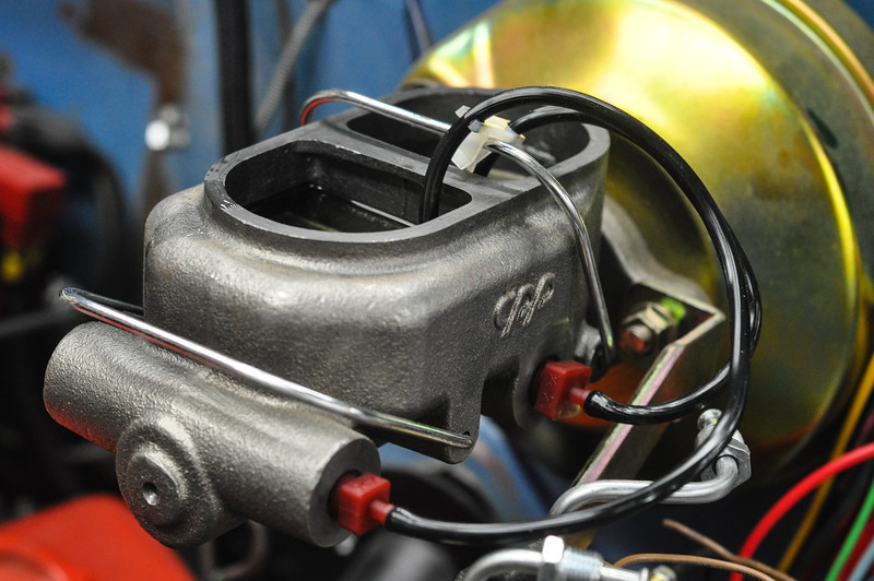

    MC bench bled and bled the rest of the brakes.

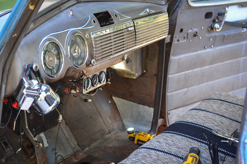

    I set out to get the interior wiring finished. Get the gauges back in, column hung. I had some misc gauge wiring to do.
    The truck fought me every step of the way. A lot of it was my errors. I put the gauges in first and then tried to hang the column. I could not get my hands up underneath to spin the nuts on the column bolts.
    Finally I decided enough is enough and start the truck up to pull it back in the shop. I walk away and let it warm up for a minute and come back to oil all over the floor. Pulled the gauges back out. The oil pressure line looks good and is tight but leaks like crazy once the truck is started........another thing to add to the list!!

    Fought with the brakes for a couple days before I discovered I had a bad prop valve. Contacted CPP and they said they would take care of me once I emailed them a receipt. Was hoping to get the truck down for a local car show tomorrow. No brakes means no pressure......hanging out in the shade......it is HOT.

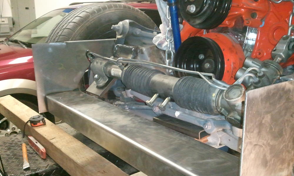

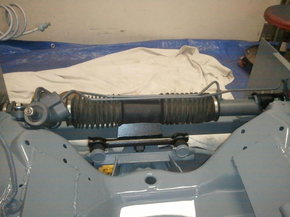

    Those of you who are following along on the 47-55 page on Facebook know all about this damn Danforth Crossmember. After spending some time chatting with Steve Szymanski, the owner of Industrial Ch***is Inc it was pretty clear this may never work the way it is supposed to. With the current T Bird Rack I have a horrible turning radius, and no Ackerman Effect. Steve was amazing in the explanation of the theory behind the steering geometry and possible solutions. It was very clear he has a wealth of knowledge and was very willing to lend a hand with no monetary gain.
    Possible solutions include finding a rack with more travel, but it is unlikely I will ever get the turning radius I am looking for. Ackerman will always be an issue. The best solution may be using an S-10 steering set up mated to a center steer rack and pinion set up. After some digging on the interweb I found the pictures below.
    This setup (Found on Killbillet) is a Intrepid rack on S-10 ch***is.
    The last straw would be to hack this thing off and install a M2 or a Dodge Dakota Crossmember from Industrial Ch***is.

    Can you shorten the steering arms? That has been done with some success on Mopar rack conversions.
