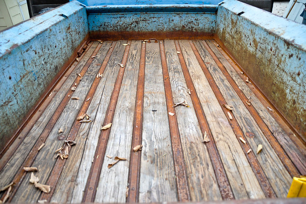

    And my son Ryder vacuumed up 30 years worth of mouse ****!!
    And we cleaned out the bed.

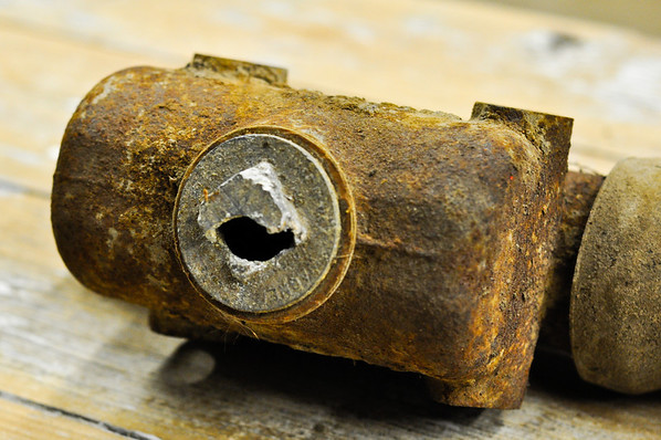

    Tried to remove the cap on the master cylinder today.....apparently someone else did at some time with no success.
    I could not get it to budge......looks like a new master cylinder is needed!!

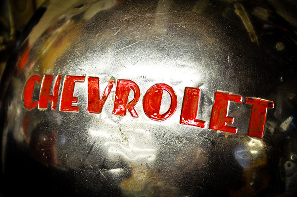

    I also spent 30 minutes cleaning up one of my stock caps with some scotchbrite and some gl*** cleaner. Probably not the best choice......but it was sitting on the bench in front of me. It cleaned
    up so well I stole some of my son's model paint and a bush and painted in the letters. Couple more coats of red and it will look good I think!!

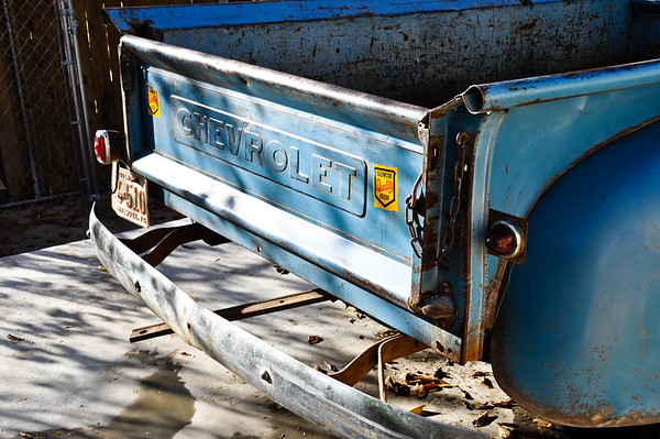

    Scored this baby today!!
    Anybody have a source for the drip rail mounts for my truck?
