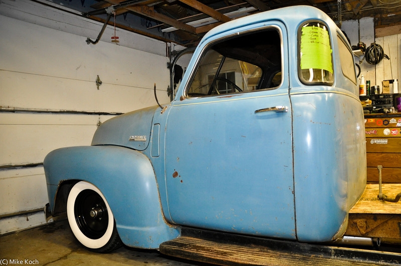

    ...I would think it'd be mounted lower than you now have it temporarily mounted once you put the bed on there...your outdoor pic looks pretty low or about level now.
  9. Coach529
    Joined: Sep 6, 2012
    Posts: 437
    Coach529
    In that picture it is sitting with about the perfect amount of rake, in my opinion anyway. About 2-1/2" from front of running board to back of running board. This amount of rake makes the bottom of the windows parallel with the ground which looks great.
    Only problem is my tires I order are 1-1/2" taller than the tires that are on it now. With those mounted it will be too much rake I am afraid, but before I make any decisions the bed will get set on the frame and see how it settles.

    ...if your tires are 1 1/2 " taller, that only raises it up 3/4"...

    Very good point......

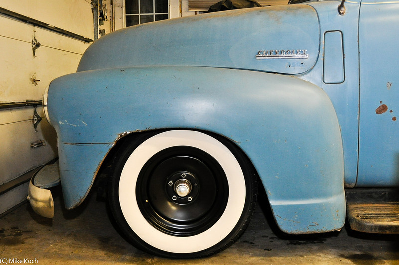

    Desperate times call for desperate measures. New tires and rims sitting here......and know body can mount and balance them until Monday. Ha.......I have done close to a thousand moto tires.....how hard can it be??
    Easy....about 5 min per tire.

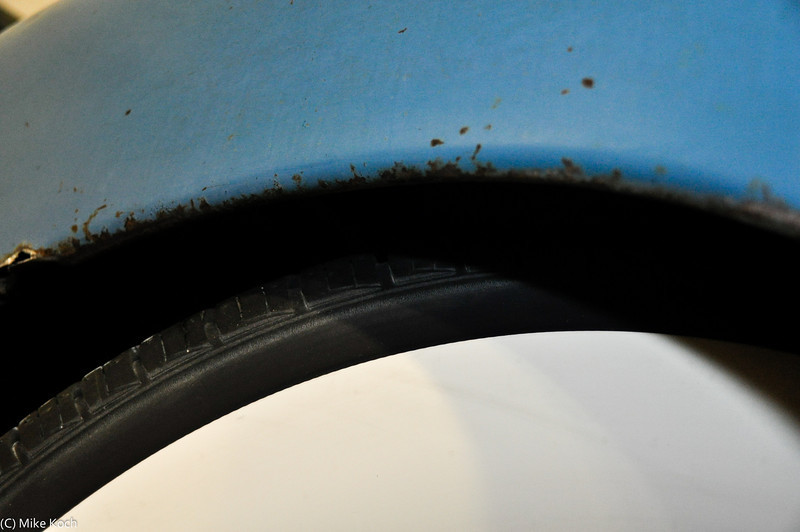

    Nice clearance at full lock.

    How wide are your front wheels with which offset?
  21. Coach529
    Joined: Sep 6, 2012
    Posts: 437
    Coach529
    6" wide, 3.5" offset.

    After some carb cleaner and some fire (on the backside of the tire) the rears seated easily.
    Bolted them on and am ready to rock and roll.
    First impression......wow they look awesome.
    Second impression....damn they look tall. 28" with 40 PSI in them......about 1" taller than advertised.
    Love the look though. Still waiting on my Shannon cones.
    Measurements show I will need some wheel spacers to clear the box sides. Probably 2" to fill up the wheel well as much as possible.
