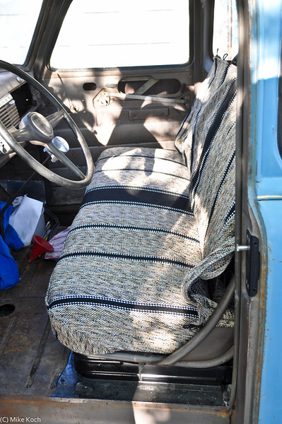

    Picked up a seat cover and seat rebuild kit from LMC. The cover is nice. Wish it was 2 pieces so I could removed the bottom. I bought a seat rebuild kit. Not overly impressed with that. Basically just some foam, a chunk of carpet and some hog rings. And only enough to cover either the back or bottom, not both. Live and learn.
    Anyway, got the bottom part of the seat cover done and installed.

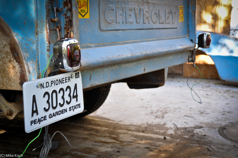

    Bolted on the taillights that I got from Wood1 last night. Still need to wire them. I found some awesome old 3/8" rusty galvanized flex I am going to use to cover the wires.
    Still need to get the fenders bolted up solid and bolted to the running boards. The bolt the bed down.

    This morning I finished up the rear tail lights and put the rest of the cover on the seat and we set out for a test drive.

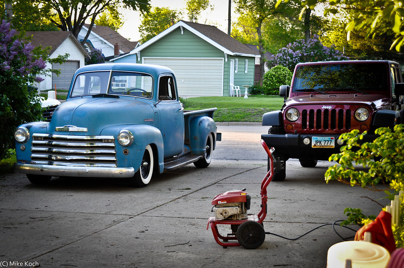

    OK.......so a little playing and working on the truck the past weekend.
    Last night my son and I flushed the cooling system with water and replaced the old thermostat. Topped it off and let it warm up. Comes up to temp perfect now.
    Went for a spin around the block and the temp rose again. Came home and checked coolant and it was a little low. I am guessing I had an air bubble. No problem. Topped it off again and went for a longer spin and it stayed right at 190 the whole time. I am holding out hope the cooling system problems are fixed.
    It runs great and the more I drive it the better it gets. Getting a ton of looks, and thumbs up around town. What a hoot.
    Last night after a 20 minute cruise the brakes seemed to be dragging. I am wondering if I have the pedal set a little tight and it is building up pressure.
    I still need to align the truck but it drives straight and so far is a delight. Obviously it is not a fan of rough roads. :cool:

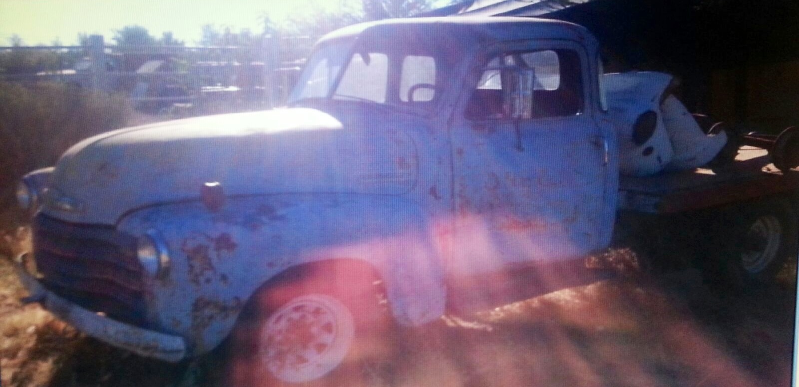

    Great truck read the whole thread and inspired just got me a 1950 3600 and can't wait to bring it home and start on it. Got good info hear thanks a lot and keep on it good stuff here is my girl. image.jpg
