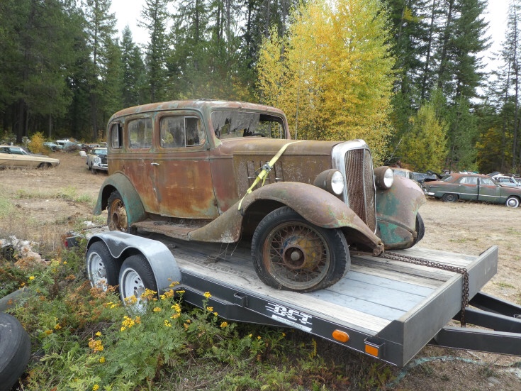

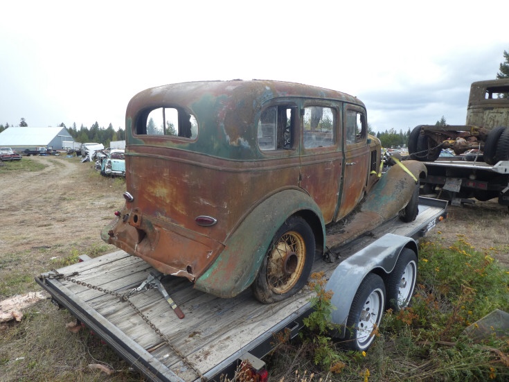

    Also, please to announce I just bought a 33 chevy master eagle 4 door!! Let the work begin. [​IMG][​IMG]
