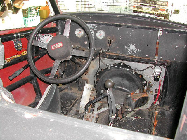

  16. Here's a pic of a LakeWood Bell Housing I converted to clutch fork on the passenger side. I needed more space for my feet on the drivers side.
    Wasn't any big deal to do. Just took some time.

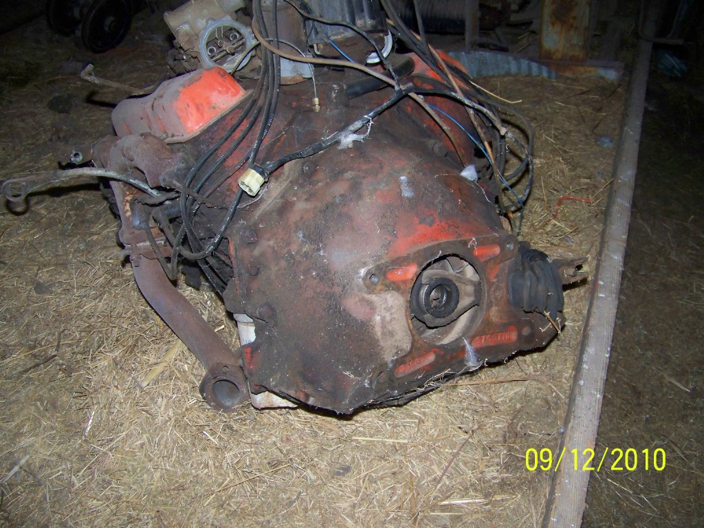

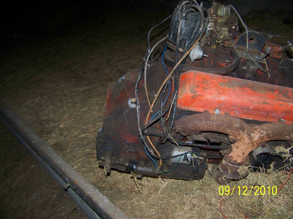

  18. Okle Pete sent the following pictures of one that he has offered to sell me.
    Looks like the real deal.

    As mentioned earlier, not a big deal to move the arm to the right side. Toughest part was to find someone with a 13/16ths X 16 TPI tap for the pivot ball
