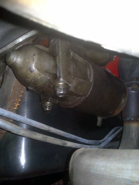

    thank you, that helps alot. I ordered a new starter and it looks nothing like the one that is in there. Now I see that it came with a powerglide behind it and they installed a 350 turbo. Might be some of my grief. I may pull the starter thats in it now and compare it to the new one. Good possibility it could work anyway.

    The info about the block won't really help you figure out the starter...like you said, you need to take the old starter with you to match it up. Although if you post a picture of it, we might could help you figure out what it's from.

    The old one just clicks some times. It will do that about 5 or 6 times then it will start. I'm headed to the shop. Gonna pull it and compare the nose angle to the old one. The bolt pattern on the new one is side by side. The old one is staggered. There is a threaded hole in the block for either

    If the nose cone of the starter is different, then you have the wrong starter. Usually, staggered or straight bolt pattern is determined by the size of the flexplate, and if the new starter uses a different bolt pattern, the gears won't mesh by about half an inch.

    Angle of the nose cone looks different holding the new up to the old. Found a part number on the old one. 10465065 and 323-465.

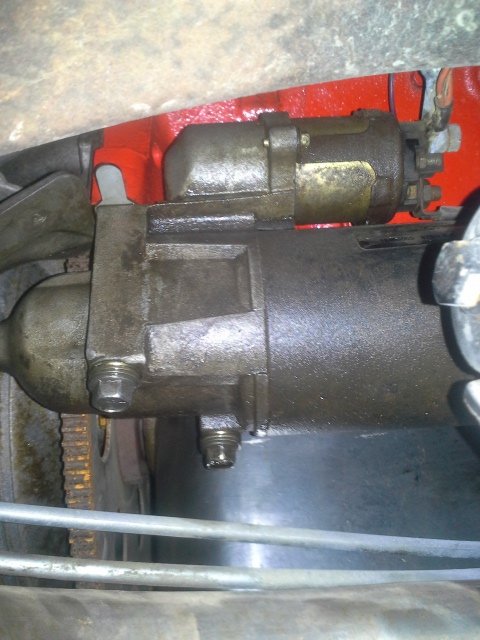

    It does look like the one in your link. And the new one i got came from O'Reilly's. Think I'm going to call and exchange. Got a part number now. Thank you sir

    Make sure the two starter bolts are the oem style, they will have a knurled (raised) section where they register in the starter nose housing holes. Sometimes they get replaced with plain 3/8in. bolts, leading to starter misalignment issues.

    Also make sure the bolts are the correct length. That starter takes bolts that are a little bit shorter than the older, more common 350 starters. The way to tell the bolts are the correct length, is that when you put the bolt in the starter, half of the knurl will be poking out past the starter nose. They work by having half the knurl in the starter, and half in the block.
    i have that starter on a 1987 350, but the starter bolt holes on most small blocks (and big blocks) are the same from the early 60s to the end of production. And they're still producing them, in Mexico, as crate motors.

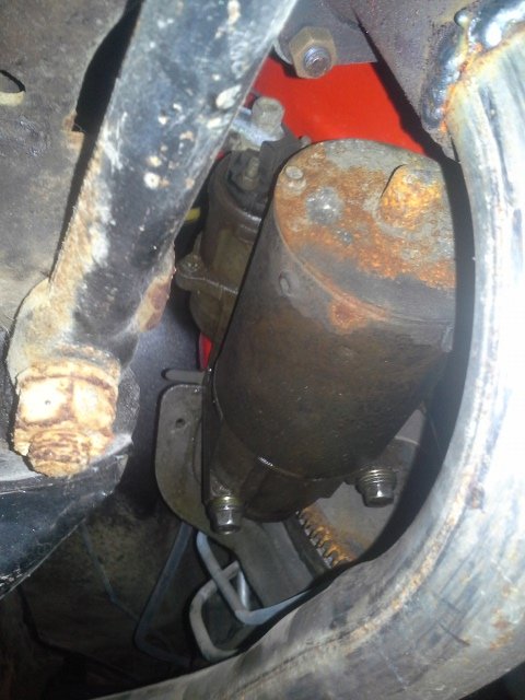

    I took the bolts out and the PO had sanded the knurling off. The bolts are to long which is why he had put the washers on them. I dug thru my magic bucket but no luck. I did find two that had the knurling but I had to put washers on them. I measured with my caliper and tightened them down while prying the starter to ones side. It starts the same so I'm guessing that there is a bad spot in the starter or sylenoid. So I'm going to use the part number on the existing starter and take back the one I have. I'm going to get the right length bolts also. Thanks to everyone for all the help. Great site with a lot of useful knowledge. I did use the rest of the day to clean up the interior some. The old hounds tooth looks great cleaned up.

    Called O'Reily's today. I always run everything thru the shop. That way I get cost and they give you the number to the business line. Your always dealing with the same guy that way. I won't be able to get there till friday, but he is going to have it set aside and said he would line up the new starter bolts for it too. It was $32 more but this one is a lifetime guarantee starter. Works for me.
