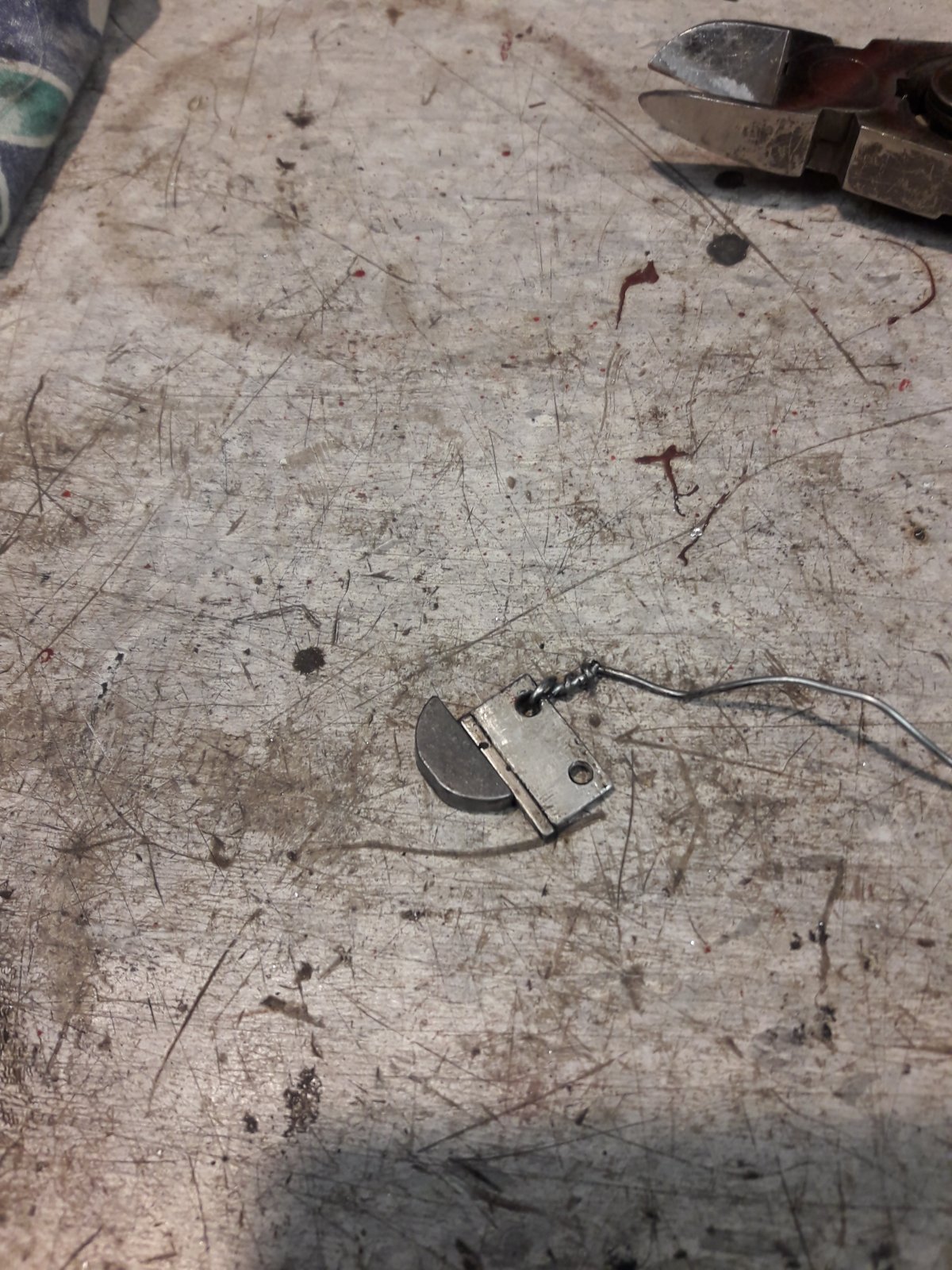

  13. Got the little *******. Thanks for all the ideas, but the little magnet did the job. I managed to get it past the seal, and hooked it out with another bit of wire. 20230421_144322.jpg 20230421_144355.jpg

    BRAVO !!!!!!!!!!!!!!!!!!!!!! @36roadster
    Good show indeed!
    Patience and persistence, pays off big time, plus a little bit of creative tool making, helps as well!
    Glad you got the half moon key out!
