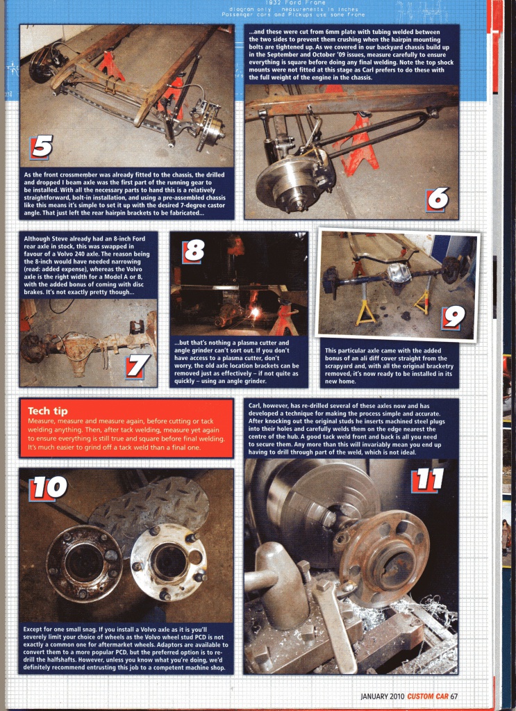

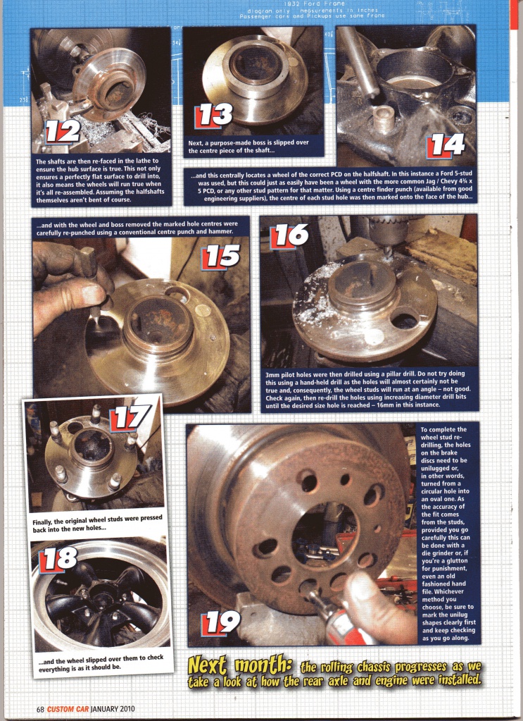

    Or else REDRILL the needed pattern on your present brakes providing there is enuf room to make the change!!! IMG_1273.jpeg IMG_1256.jpeg
    billsbird likes this.

    I’ve drill new bolt patterns in axles and drums for years using a floor mounted drill press and a dual (or more) template. The plastic ones work fine. Put the template over the Ford pattern studs first and mark the 4-3/4 circle pattern, remove the studs, then center punch and drill.
    The main problem with this is the Chev wheel could be 7/16” instead of the 1/2” of a Ford. Wheels and drums should be centered on the axle center hub.

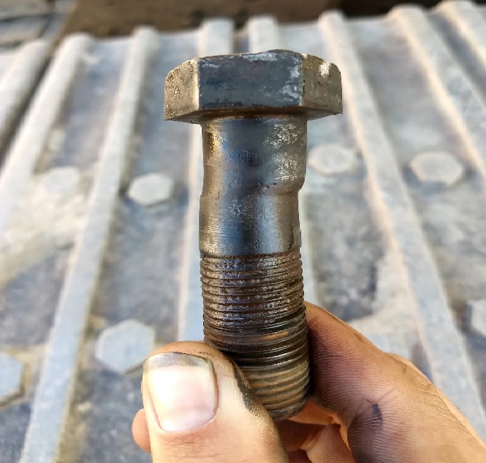

    If it is not possible to drill another set of stud holes in the hub you could do it this way using the original stud holes.
