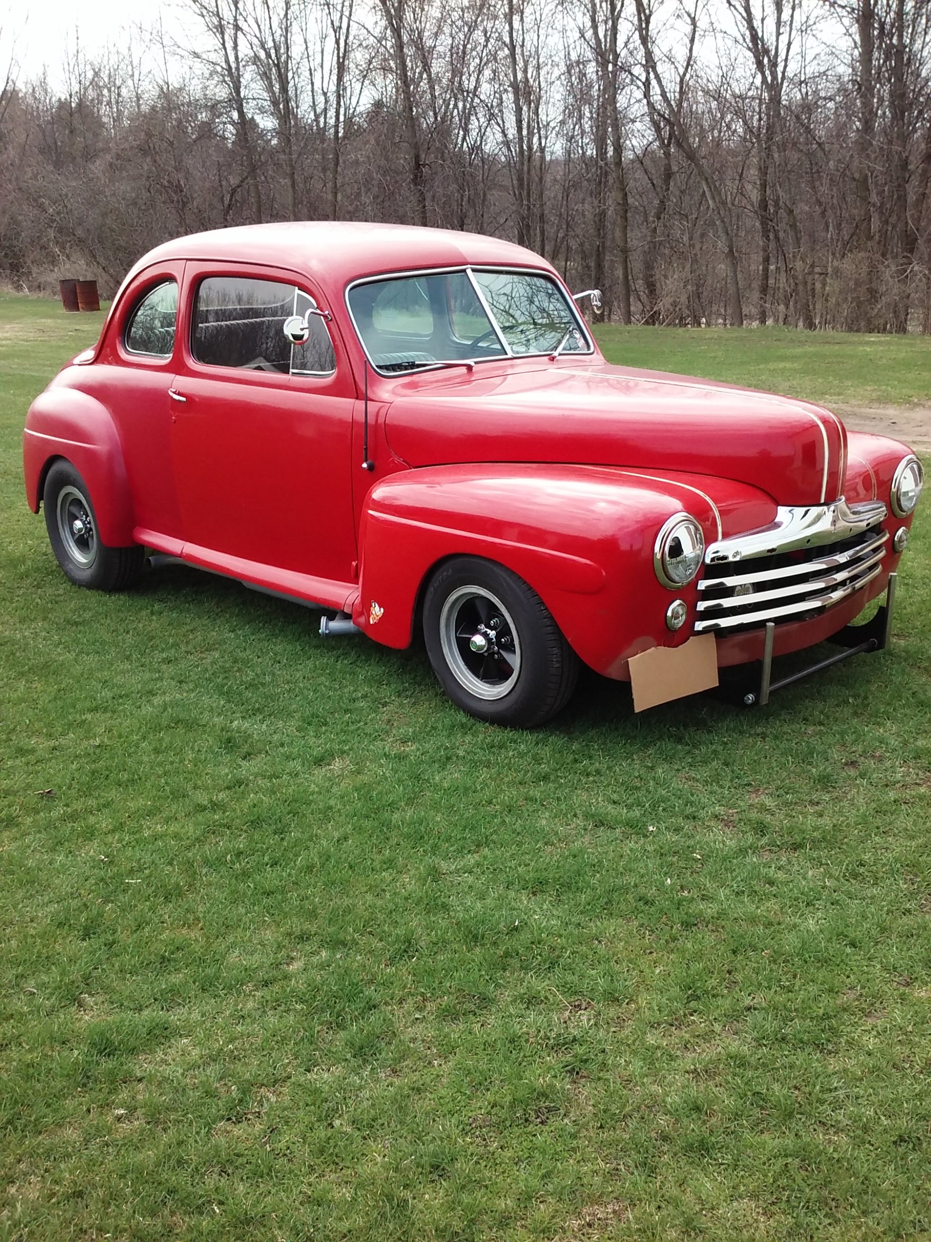

    What is the bolt pattern on a 55 ford ?
    I have a set of adapters Ford pattern 5 1/2 on 5 to Chevy 4 3/4 on five, they were on a 48 Ford that I recently sold with the original steel wheels, kept the 5 spoke wheels and adapters,
    PM me If you're interested in the adapters, they would be a lot cheaper than new ones
