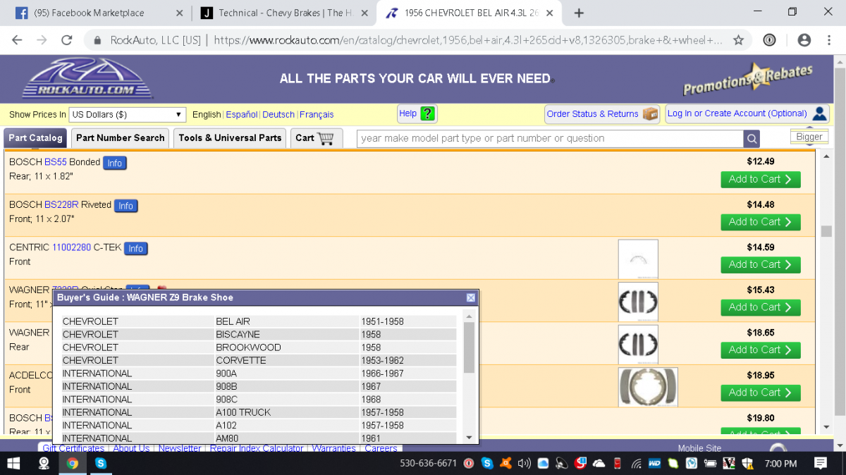

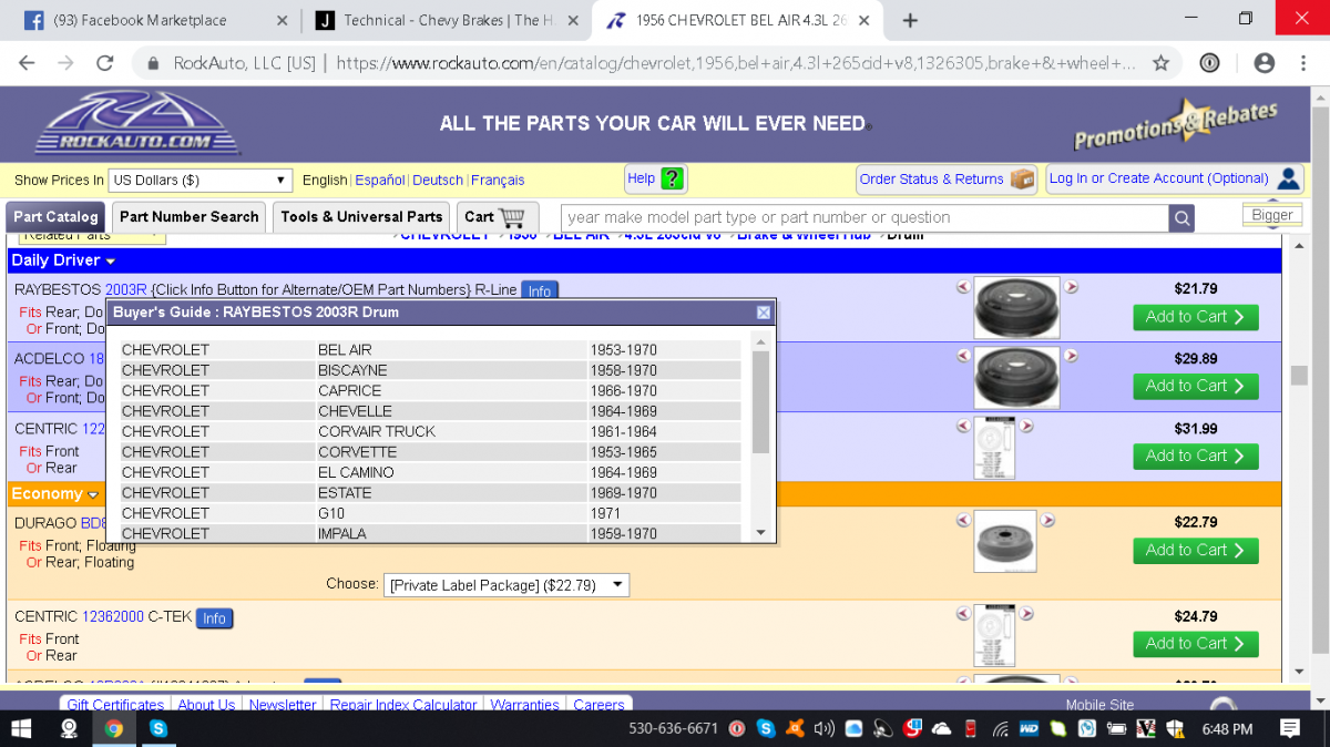

    Car? Truck? or ???? According to the Rock Auto cheat sheet (click on the blue part number and it tells all the rig the part fits) the drums fit 53/later while the shoes will fit 51 up into the 60's on some models. 2019-04-08 (1).png

  7. According to the "BIBLE" Hollander interchange this is for your Brake drums #587
    Now for the shoes.. #64G
    I TRUST these Books 100% over a online parts house interchange.. And even the box store at times.
    Wreckers have used these for decades with no problems, Until they put the books on CD and removed all the foot notes... BASTERDS !
    And the look up was for a car...……
