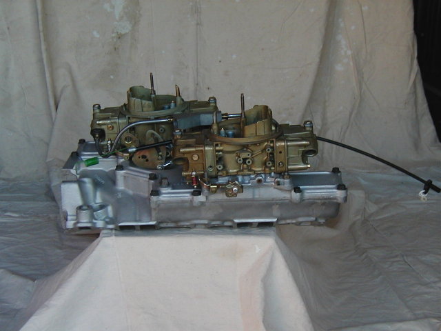

  11. Deuces
    Joined: Nov 3, 2009
    Posts: 26,386
    Deuces
    Here's a pic of the GM version setup with the 600 cfm Holley DP's.... Brand new systems complete with the air cleaner and inline 6 thottle cable are fetching around 8000.00 bucks!....... Yikes! :(
    henryj1951 likes this.
