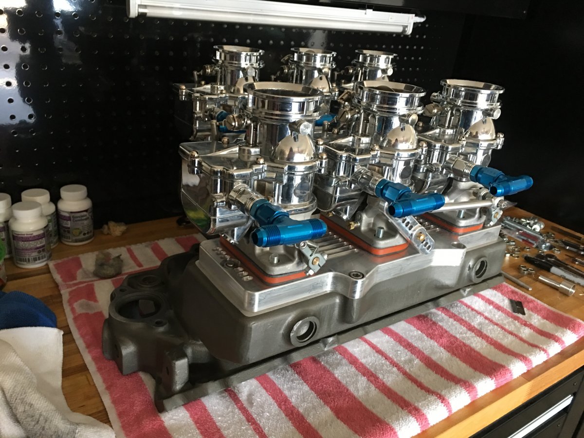

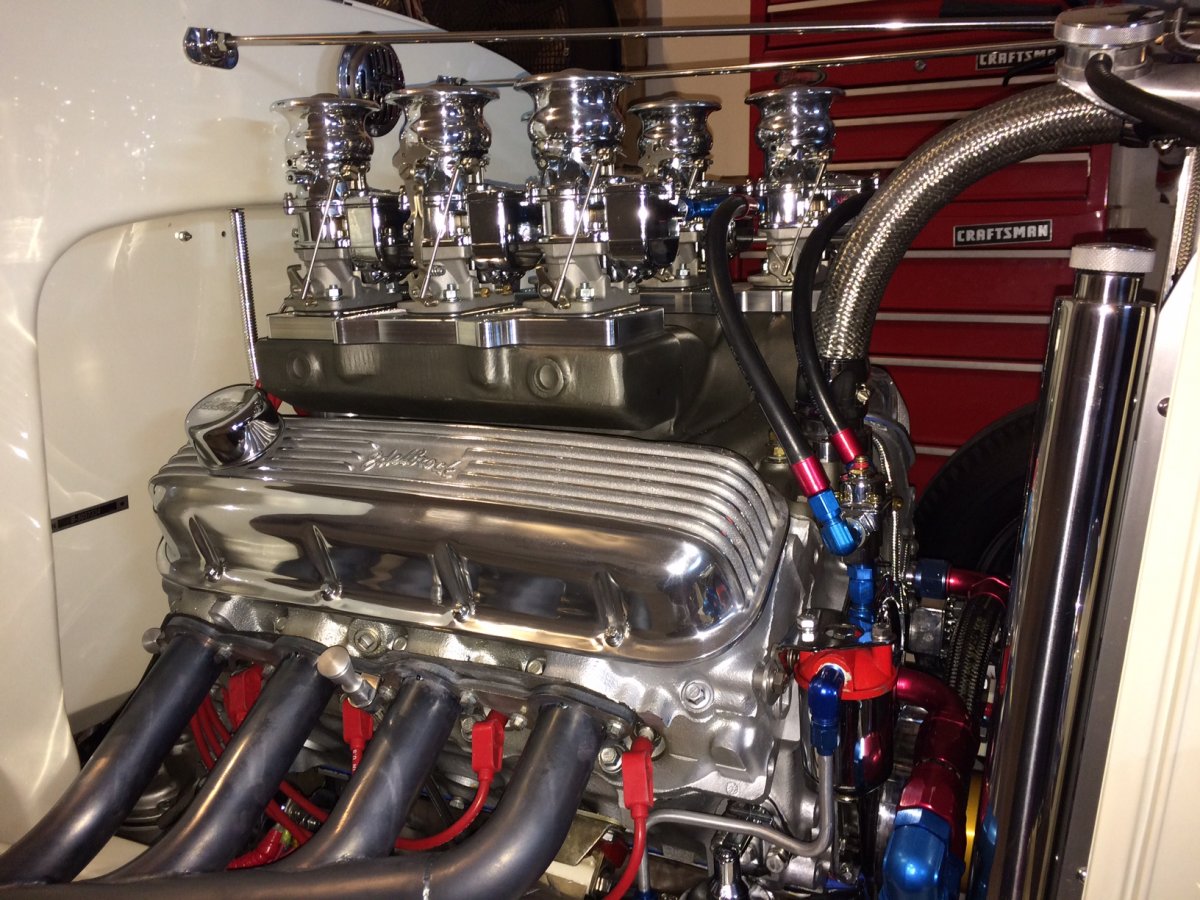

  5. boutlaw
    Joined: Apr 30, 2010
    Posts: 1,254
    boutlaw
    current crossram with quik change vac housing and interconnected carb vacs
    Deuces, GlassThamesDoug and swade41 like this.

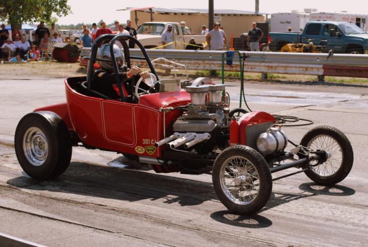

    Ran one on a Drag T with a 301. Call Edeldrock tech line. They say that the jets in the carb are diffrrant from side to side. Something like 90 on the inside and 100 on the outside.

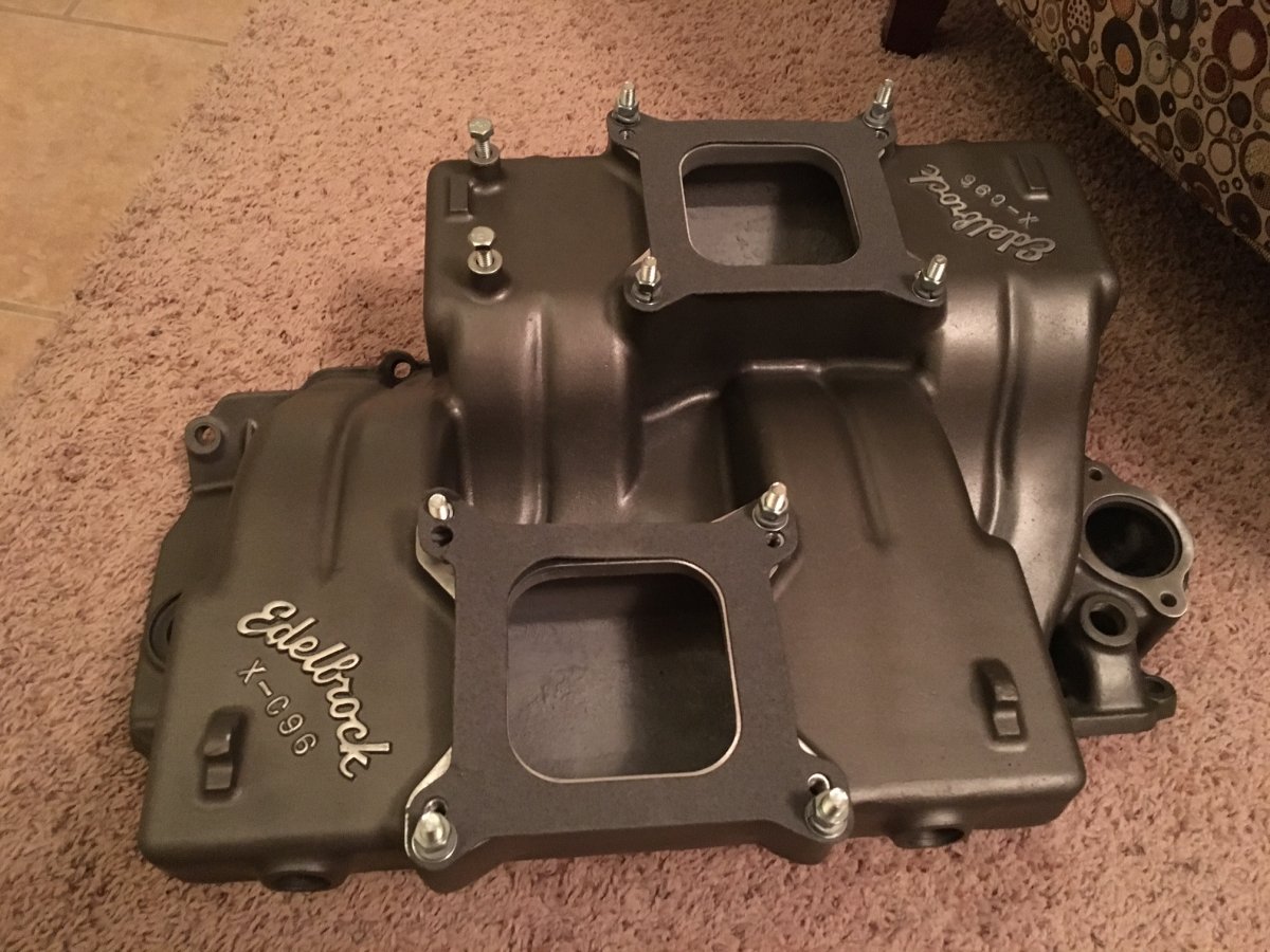

  17. johnybsic
    Joined: Oct 8, 2009
    Posts: 612
    johnybsic
    from las vegas
    Heres mc XC-96
    I've never run it yet. I don't have the funds or time to play with it, It's also for rectangle ports and i'm running ovals right now. When i'm out of school this thing will feed my 55's 454:cool:
    I enjoy reading everyones tips and experiences while i'm dreaming
    Deuces and swade41 like this.

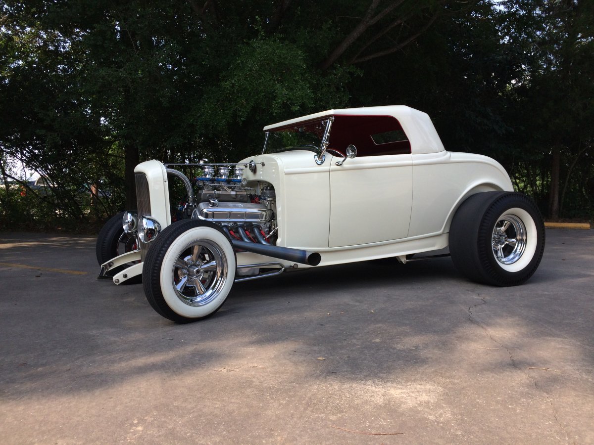

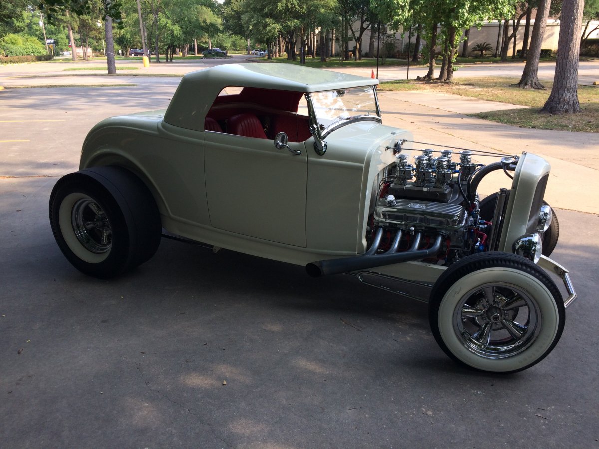

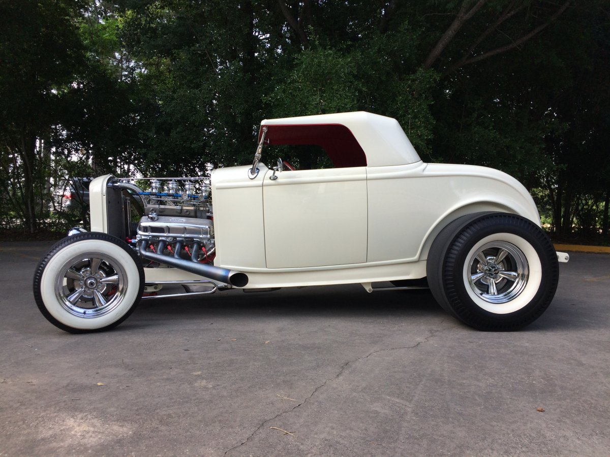

  27. 6X2 HiBoy
    Joined: Jul 10, 2017
    Posts: 1
    6X2 HiBoy
    from Spring, TX

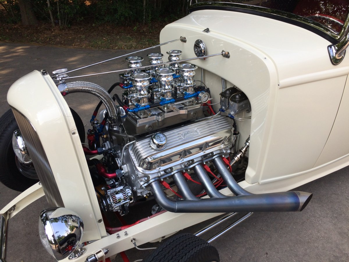

    image.jpeg image.jpeg image.jpeg image.jpeg image.jpeg image.jpeg image.jpeg image.jpeg image.jpeg Hello all. Wanted to thank everyone who contributed to this string. Kept my project on track and never derailed! MSD -6 kept me idling whenever I veered off course! Adjusted the primary carbs (middle) always at idle with linkage off. Actually had to adjust secondary carbs (the other 4 on the corners) to zero CFM's because the progressive linkage, adjusted incorrectly, would open the ****erfly's at idle contributing some CFM's to the imbalance. Finally adjusted the actual linkage at 2000 rpm's (primary cruising rpm) to provide balanced flow while actually driving. Two Lokar throttle cables connected to the gas pedal are pulled simultaneously with the p***enger side also working the 400R transmission cable. Again, many thanks to all the experiance and for p***ing it forward.
    brigrat, enloe and Deuces like this.
