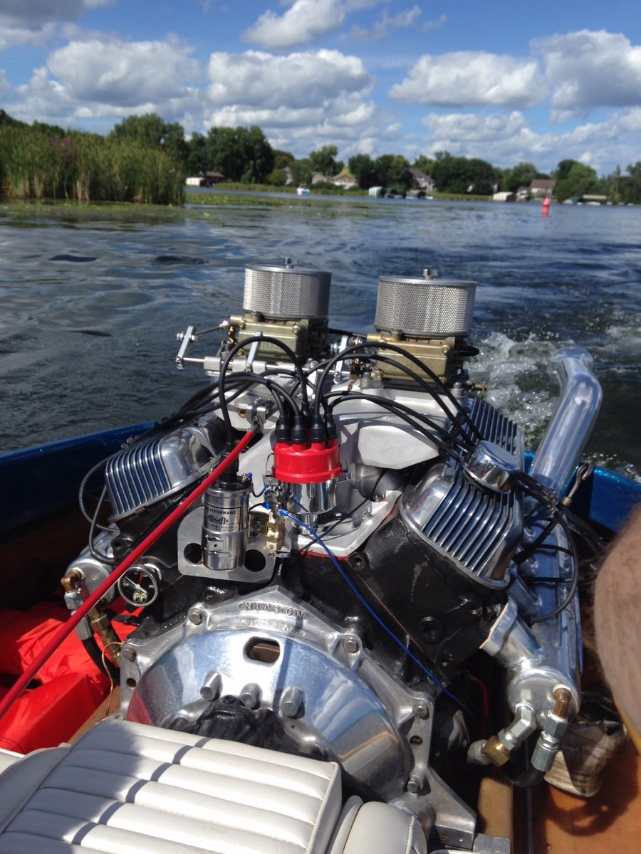

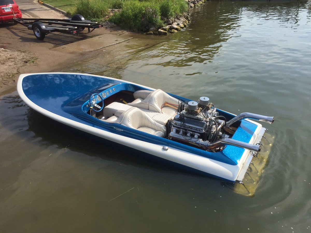

    I have a Weiand cross ram on my boat with a pair of 450 holleys on it. It is a 396. When I first installed it , it seemed to run fine idling on the trailer but had a terrible stumble when I tried to drive it. I ended up putting a pair of 50cc acc pumps in it and it really runs beautifully now. I had 2 cross rams, this Weiand and an Edelbrock C096 sitting on the bench side by side and they are virtually identical. I could have used either but I opted for the cool factor of the one that said "say why and" on it...

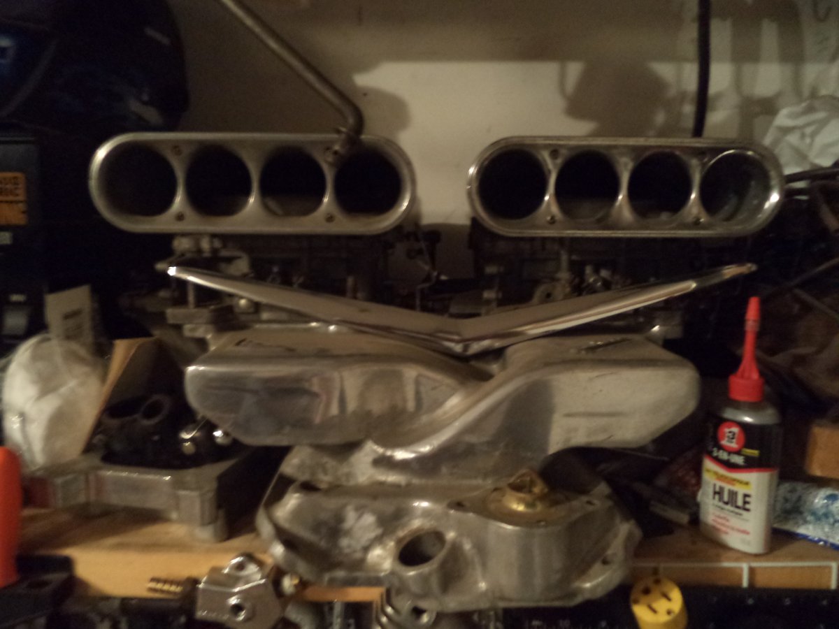

    I bought a Weiand with the say why and on it also. Believe it's from 1966 and it came with Carter 500 compe***ion carbs. Was going to rebuild these for my 283 but now this threads got me thinking. $(KGrHqFHJEIFDN-Tl4PGBQ8y740M-!~~60_57.jpg DSC00802.JPG

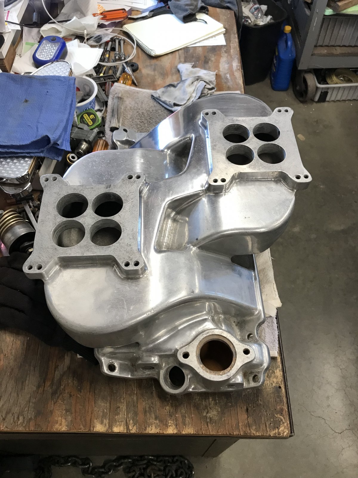

    I had been thinking of putting a cross ram on the 355” SBC in my Austin g***er. I mentioned it to a friend of mine and he said that he knew of one for sale. So today I scored a polished M/T cross ram in great shape. Unfortunately they polished off the M/Ts but it’s pretty obvious what it is. And best of all no corrosion and no “porting” was done on it. I have two 500 and two 625 AFB compe***ion series carbs to try on it. The current cam is an old Comp Cams 292 Magnum.
    Can anyone post some pictures of the linkage commonly used with this offset setup?

  11. GlassThamesDoug
    Joined: May 25, 2008
    Posts: 2,143
    GlassThamesDoug
    Nice manifold. Looks like it has rear water ports for cooling lines. As for linkage... swap meets, and a note in wanted section. Bet this manifold had chromed linkage ... still hanging on someones wall.

  12. This is a edelbrock intake. It has bosses that are tapped for the linkage. Right upoer cornef. 20210803_214212.jpg 20210730_111832.jpg

  13. bchctybob
    Joined: Sep 18, 2011
    Posts: 6,622
    bchctybob
    I remember that linkage but with out the bosses on the M/T manifold I’m thinking that I’ll probably have to make something that bolts to the rear studs of the rear carburetor.

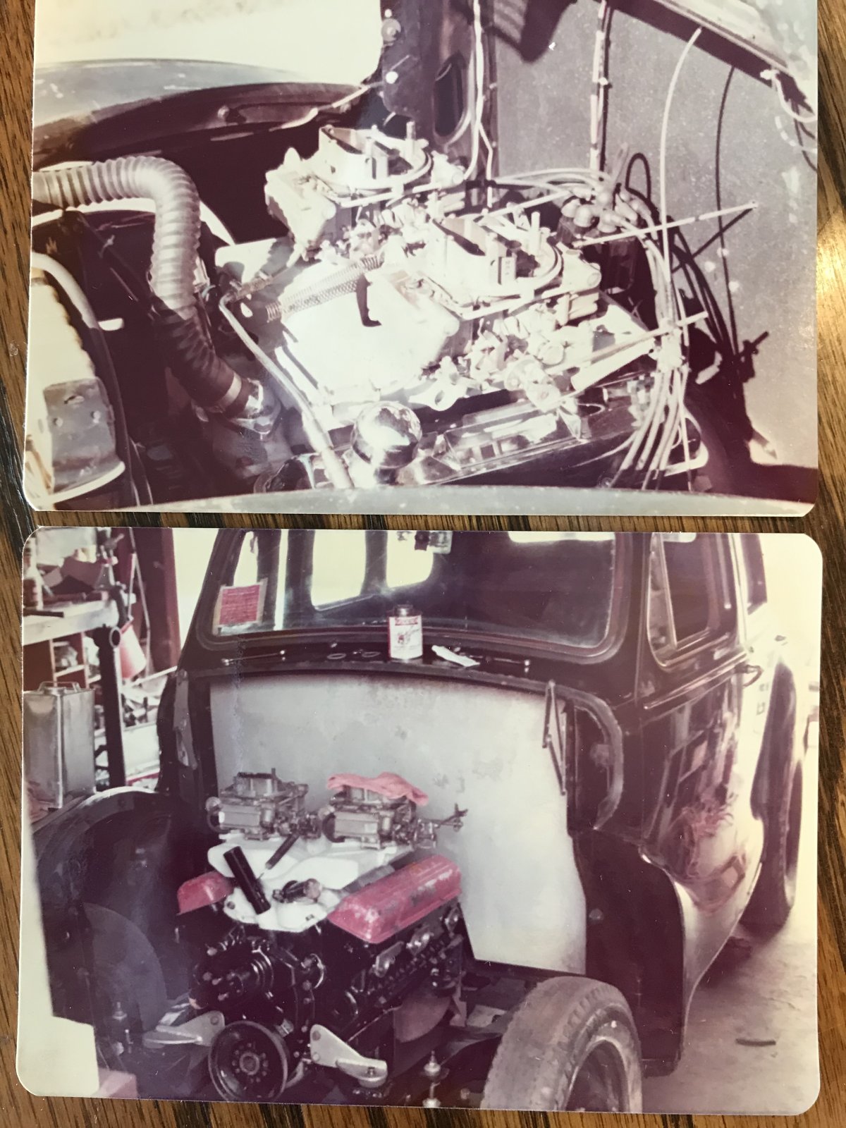

    Here’s the cross ram I had on my first Austin. Sorry for the ****py old photos. Everything you see and more came with the car for $350. A 292 Chevy, a new C&O 4 spd Hydro, narrowed Chevy rear end w/4.11 posi, and new M&H slicks. An unfinished roller. The cross ram setup never gave me any problems but the hydro wanted to stop the little Chevy on the 2-3 shift. Fun car.

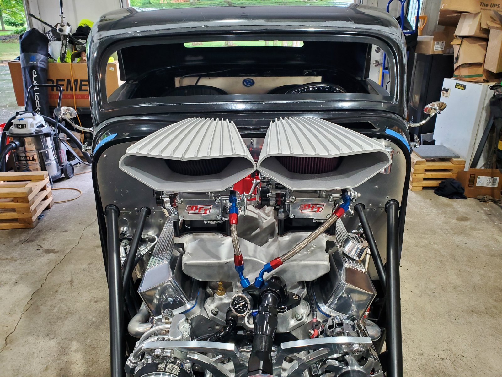

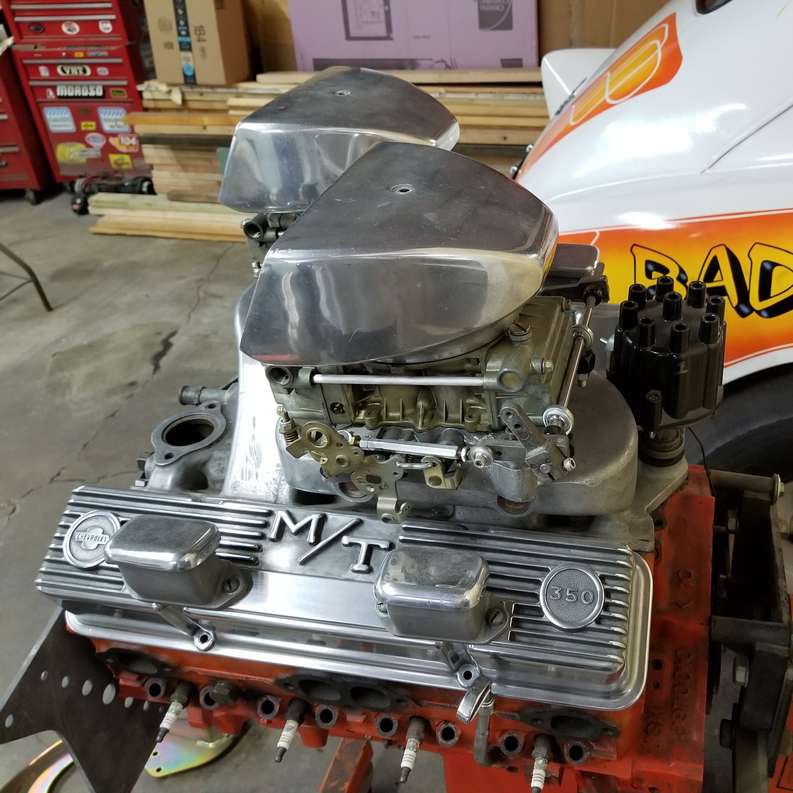

    swade41
    from Buffalo,NY
    This is what I came up with, just need a longer rod for the right carb, some of the vintage photos I've seen of M/T had the linkage mounted to the front of the carbs.
