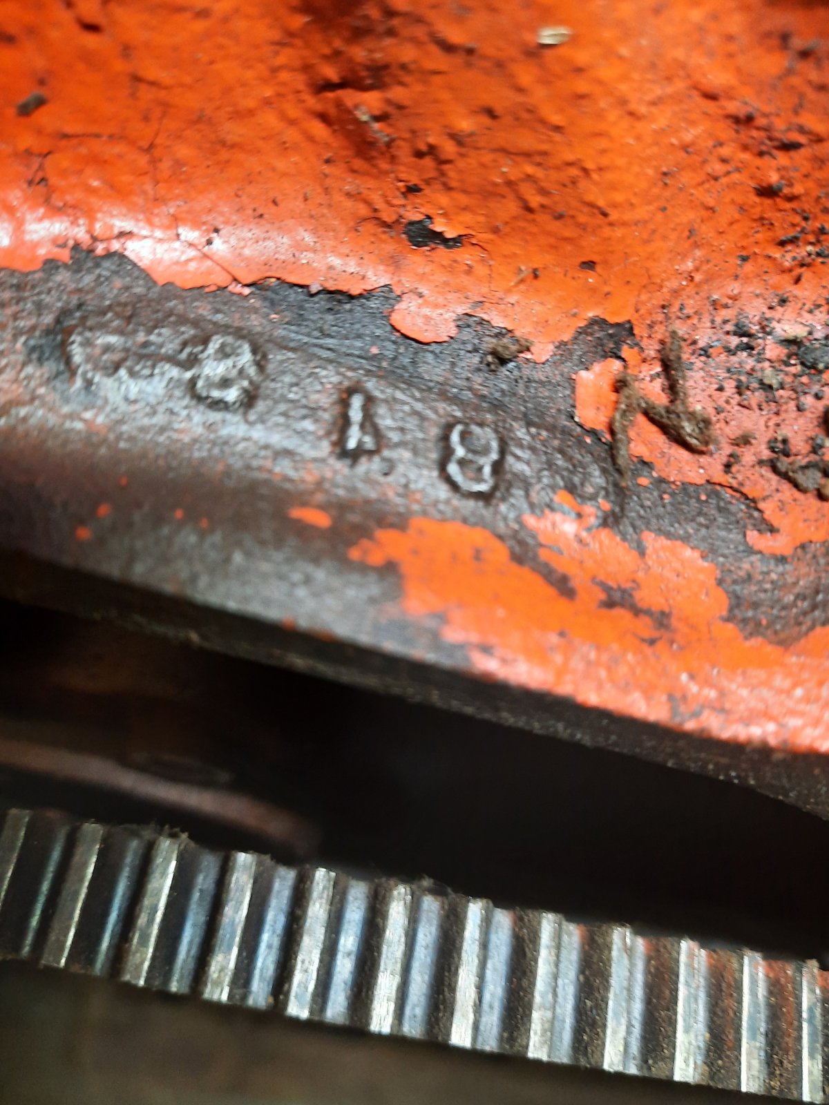

    Trying to identify this Chevy engine for a buddy. I'm a Chrysler guy. Any ideas?
    Thank you.

    What is the casting number on the left rear near the head?

    I am going to have to go to Ron's garage and get that.

    TJC = '73 350 truck motor on a suffix code list.

    How about 3970010?

    Thank you. We thought it was out of a 74 truck.

    That casting number was used on most truck 350s from 1969 to 1979.
    The casting date looks like 8 to me, meaning 1978, and the suffix code date on trucks online isn't complete, so I'd guess it's from 78, also due to the shape of the stamped characters. But it doesn't really matter, a 1973 and 1978truck 350 are about the same engine. 4 bolt mains, cast crank and pistons, 1.94/1.50 valves, low compression, Quadrajet, etc.
    The engine was not originally in a 74 truck, they did get swapped around a lot.
