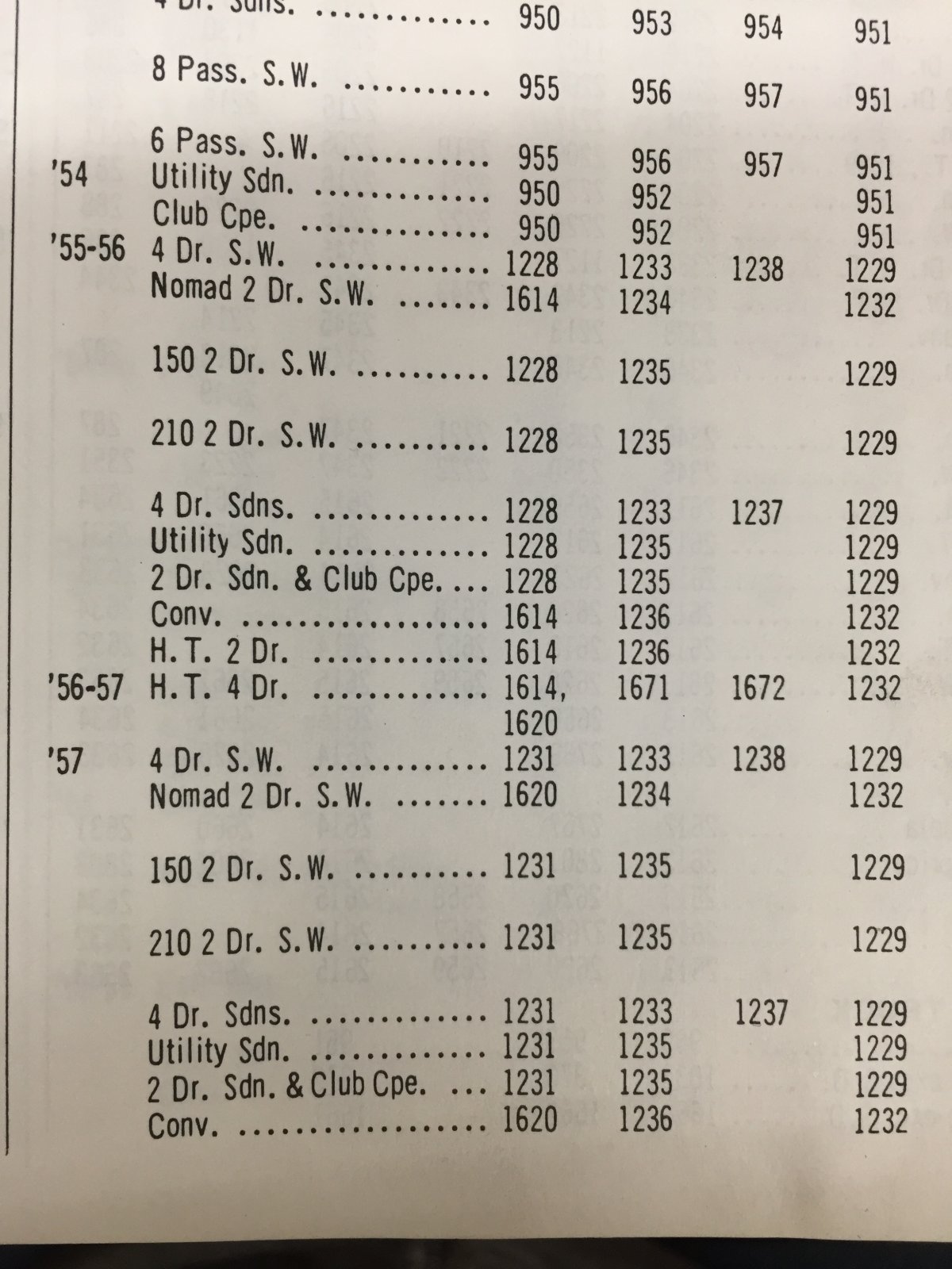

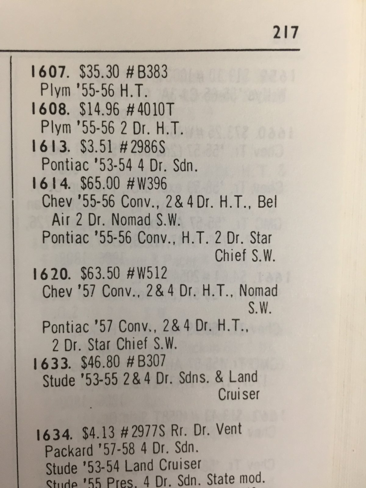

    Hollander says 55 and 56 are the same, but 57 is all by itself
    55-56 hardtops are 1614 and 57 is 1620. these are hardtops

    I stand corrected. Because the 57 did away with the cowl vent it is an inch longer on the bottom.
