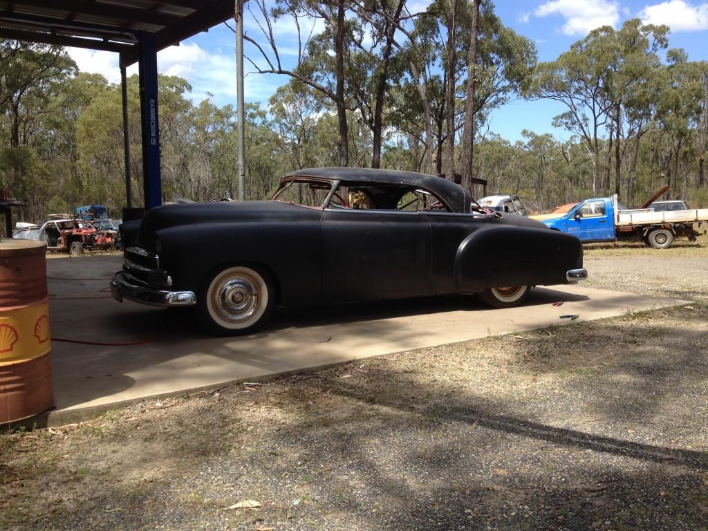

    So the time has come to cut the roof up. I've never done this before so I'm sure I'll run into a lot of problems but I can no longer stand looking at the ugly roof line.
    This photo was taken a few weeks ago, just after I got back from Greazefest. Roughly 1400km trip over one weekend, big trip for a 216.

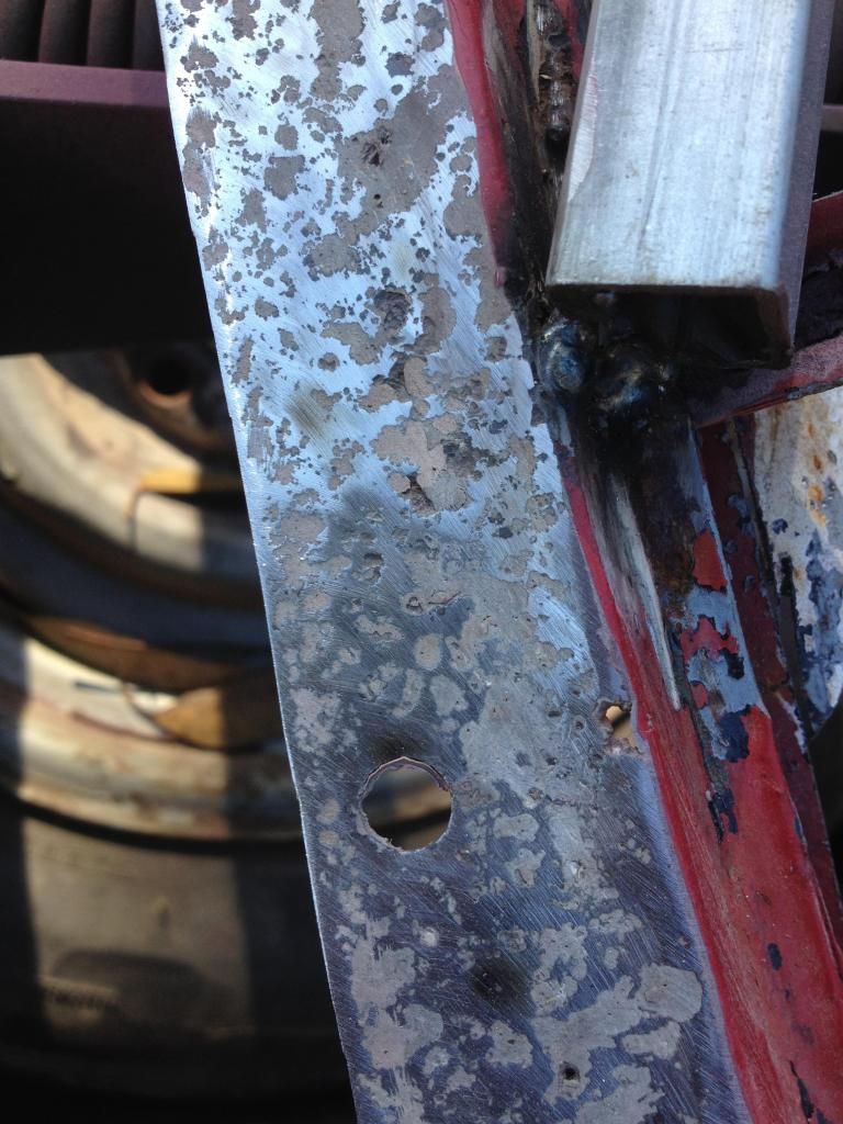

    Found this when I stripped it down. So that set me back a little while. Had to do both sides.
