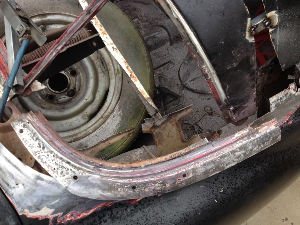

    Alright guys. So I've been pretty busy and haven't had much time to work on the car. But I did abit today on it. I talked to the gl*** guy and he said to go with Lexan. So, with that in mind I decided to re shape the rear window section a little.
    I never liked the wide pillar section on the Ernst car, but it has grown on me alot the last couple of weeks and it just seems like the way go to. I don't know how the Barris guys did it, I can't figure it out but I've got it pretty close I think. I took measurements of the pillar and scaled it up and all that so it should be pretty close.
    Also, I found more rust and ****. Pretty annoying but I was expecting it.

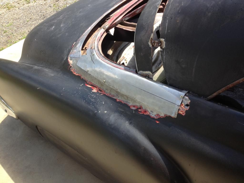

    I couldn't get the side window bottom sections to lay right so I cut them out and have tacked them back on where I think they should sit.
    New cat walk section. Decided to do it in a couple of pieces, just to make it easier to handle etc.
    Making the paper pattern for the side area. Helps to know what size to cut the steel out, where to put the bends and gives you an idea of what part needs to be shrunk/stretched.
    Panel started. It looks abit funny in the picture, Not so bad in person. I'll take it to work tomorrow and use the shrinker rather than putting hammer marks in from stack shrinking with the hammer.
    Here's a comparison to the old gl***.

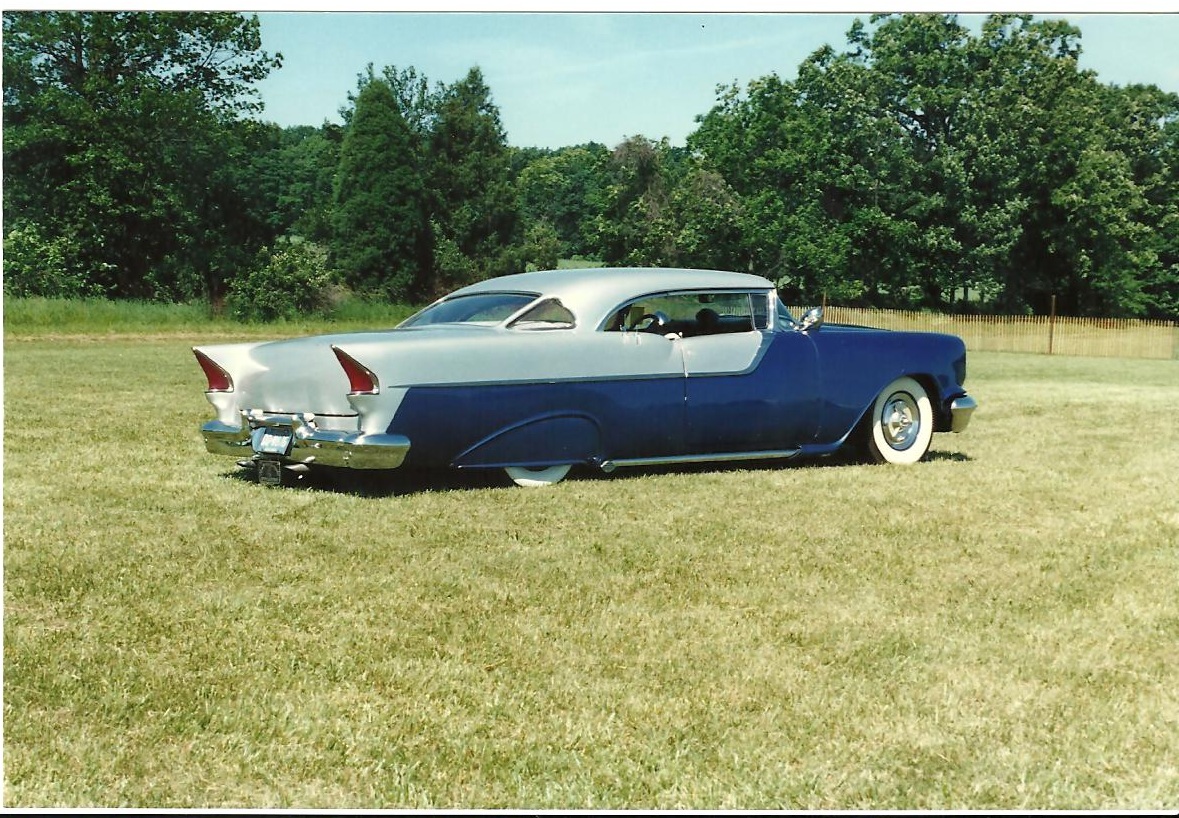

    I did the same thing as Keith (FASI) on my 55 Olds (with a 57 back gl***). Lean the center until you have the look right, then make new side windows out of Lexan. I usually don't like the use of plastic for gl*** on cars, but here it was unavoidable.

    R/H panel made up pretty much ready to weld in.
    Both catwalk sections made up.
    Hard to tell in the ****ty photo but the L/H sail panel or whatever you want to call it is not far off being done. Just need to order an Oxy set then I'll be on my way to having the outside done.

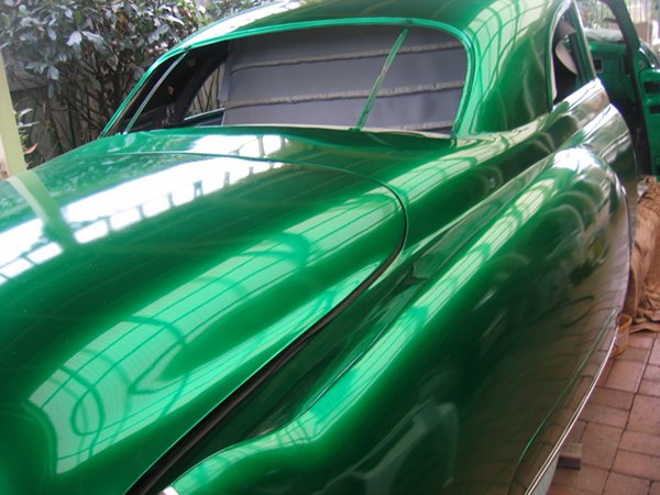

    Grant, I snapped these photos of an Olds at TRJ show this weekend, with your car in mind.
    Unfortunately, I could not find the owner to ask questions, but the rear window appears to be all gl***.
    Anyway, it might inspire, if not inform.
    Eric H likes this.
  25. Grant_Maclean
    Joined: Nov 11, 2013
    Posts: 52
    Grant_Maclean
    They're interesting photos. It's hard to tell if the catwalk has been played with, but looking at the trim at the top of the quarter it looks like he may have lengthened the roof, that could solve some issues with the wind up quarter gl*** as well.

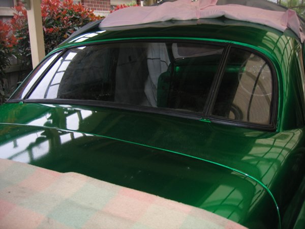

    Hi Grant .... Gotta keep the 3 piece rear screen....have done the same on a 49 Caddy and kept the 3 piece screen....find an old timer glazier he will cut the 2 end toughened gl*** pieces to shape...a few pics of the gl*** this is a 5 " chop at the rear had to extend the cat walk 5-6" lay the gl*** frame forward about 12" to get a smooth body flow
