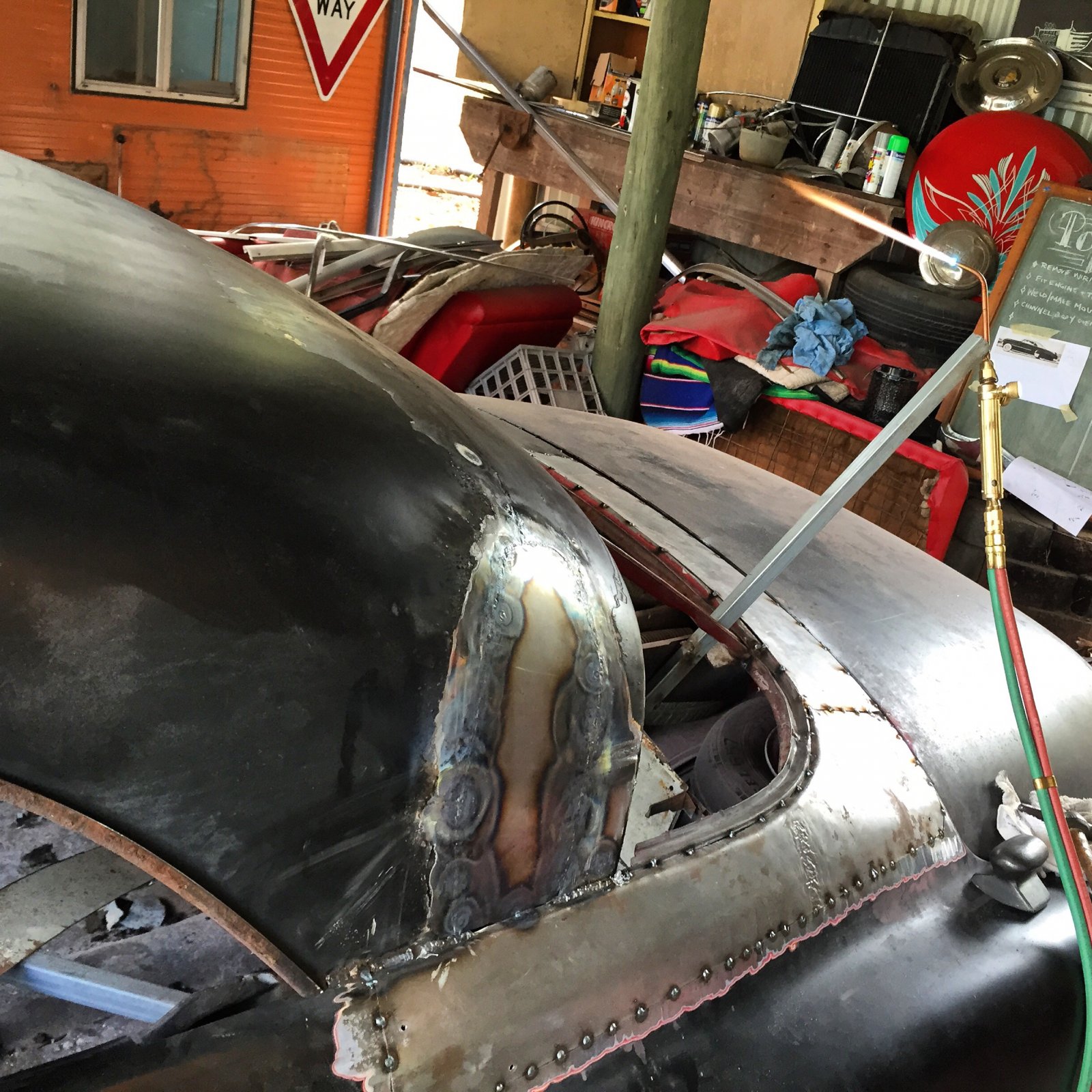

    image.jpg image.jpg So it's been a while since I last posted. I've been busy as hell and not a lot of that has been spent on the chevy. But I have done a bit.
    I'M posting photos from my phone so I hope they work. Some of the welding was done with the oxy and some done with the mig. Just depended on how easy it was to get in there to hammer it up. Second photo was just before some planishing and expoxy.

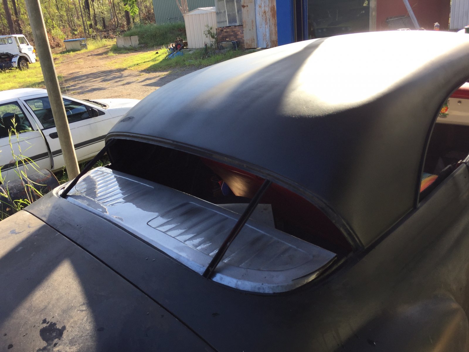

    image.jpg image.jpg This is how I did the bracing. Not sure if it's right or wrong but it was quick and easy and it's quite strong. I couldn't find any info on how the other guys did it. Also, I wanted some experience on the bead roller at work so I made up a new parcel shelf. It will get covered when the interior gets done but I just wanted to have a go at something different. And it's a damn side better than the old one.

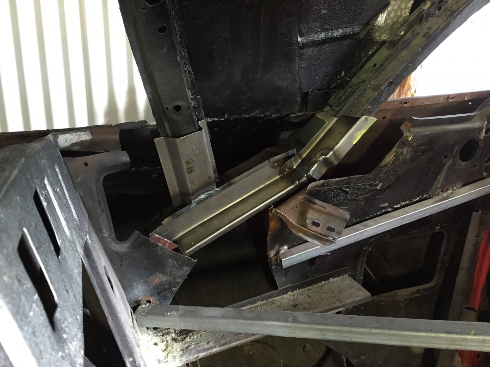

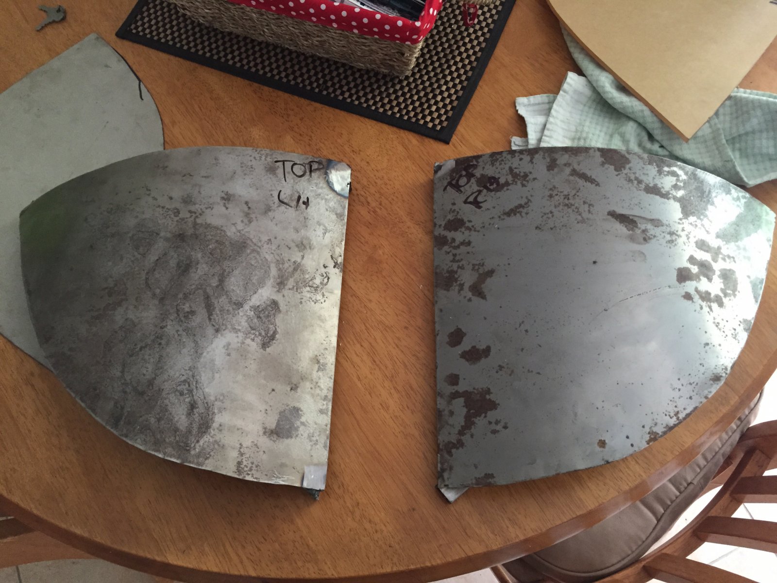

    image.jpg Started making the steel template for the corner gl*** pieces. image.jpg More rust repair. image.jpg Oxy welded in. image.jpg

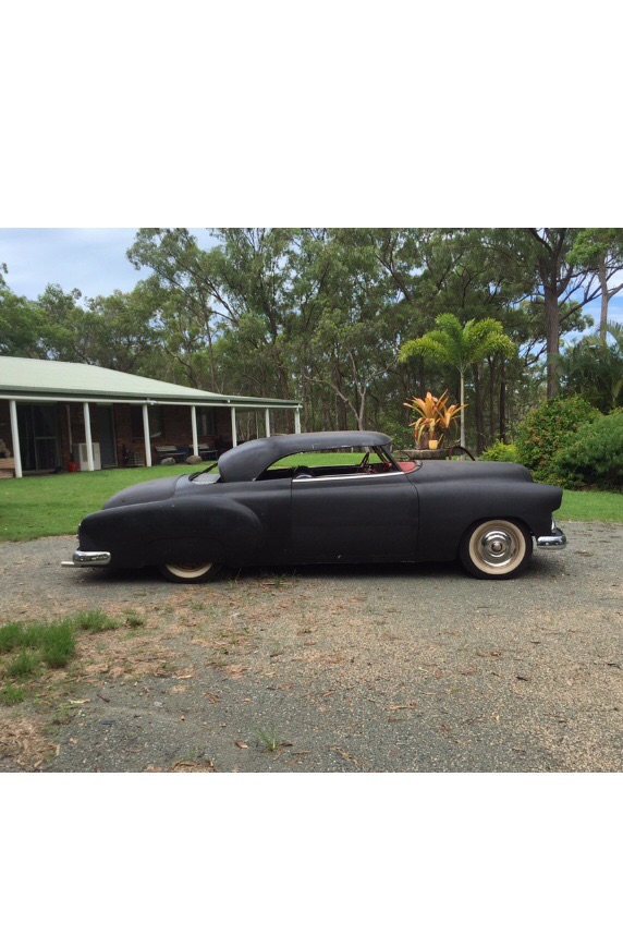

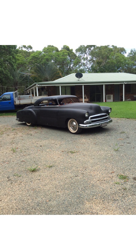

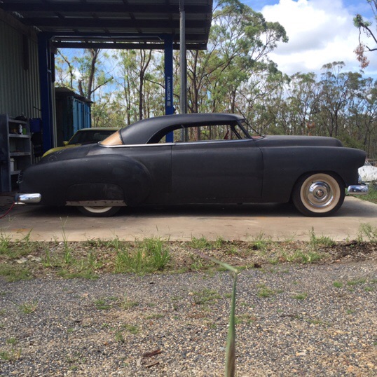

    image.jpg Got some time to get the car out and I got some photos. Waiting to get the gl*** sorted before I put the trims and mouldings back on. We have a local bi-annual car show on in May so I'm hoping to have the car in a dark red primer with the moulds and trims back on. There's also a heap of mechanical issues to fix before then so I'll be busy. We also just went through a category five tropical cyclone which pretty much flattened all the trees on the property. Luckily no sheds or cars were damaged but a tree fell on the house and did some damage to the guttering. So once everything is back to normal the work on the car will resume. image.jpg image.jpg

    Looking very good. It is a job to chop one and it looks like you nailed it.

    Thanks Keith! It means a lot coming from you, hopefully one day it might be comparible to the Ernst Chevys.

    Agree with Keith.
    You nailed it. And that parcel shelf looks too nice to cover with upholstery. Great job.

    Very nice. Great profile.

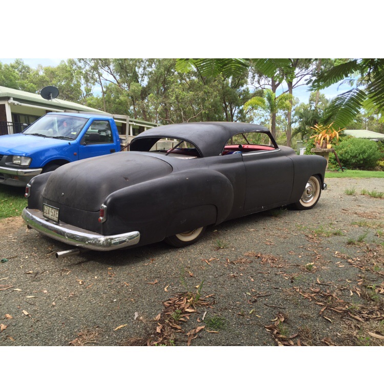

    Finally got a chance to do something I've wanted to do for a long time. The oxy was playing up though, need to get me a TIG. Need to do something with those tails lights now! image.jpg image.jpg image.jpg

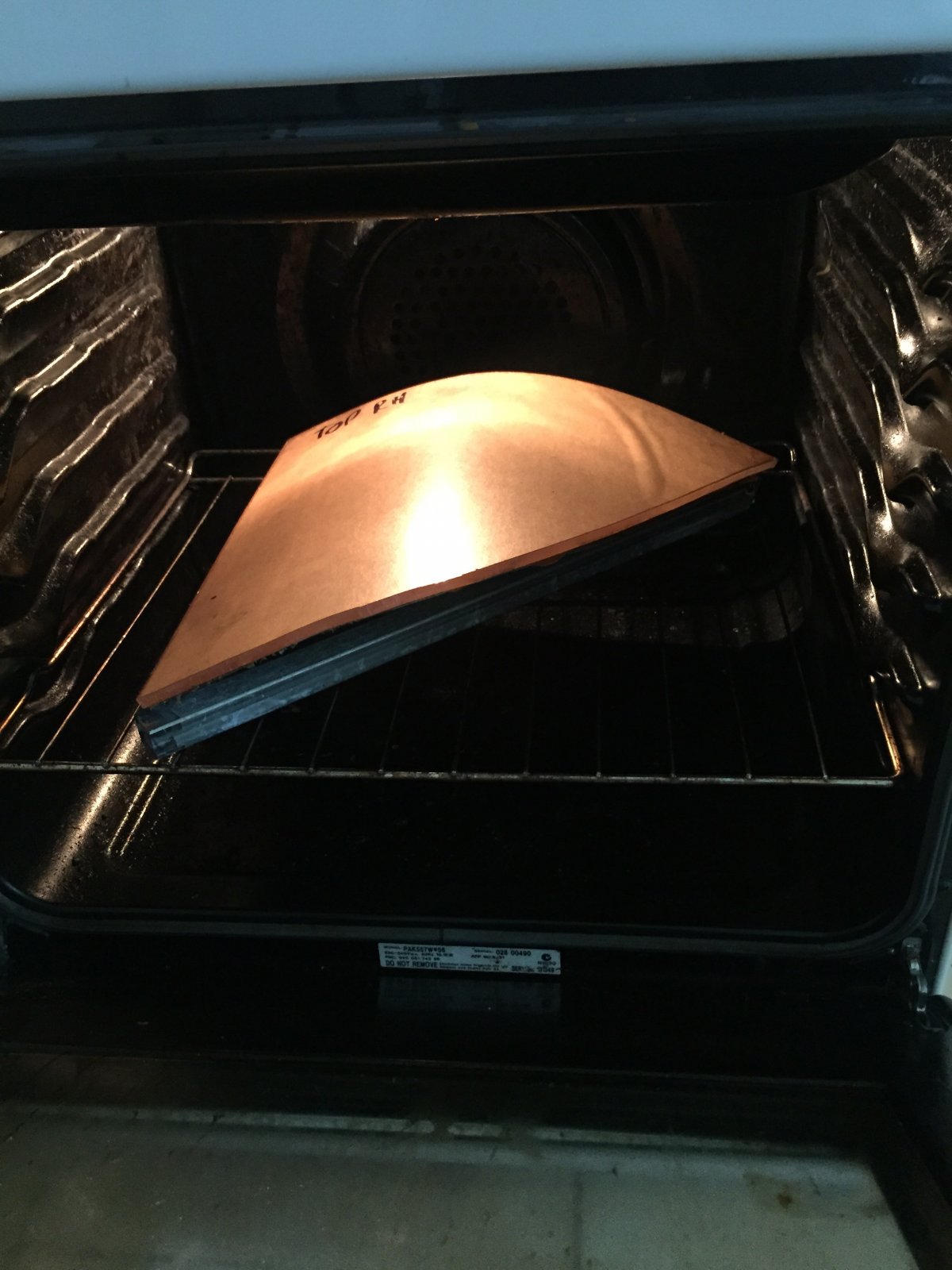

    Making slow progress on the chevy. Here are the rear window moulds I made up. Used 6mm cast acrylic in the oven at 200. image.jpg image.jpg image.jpg

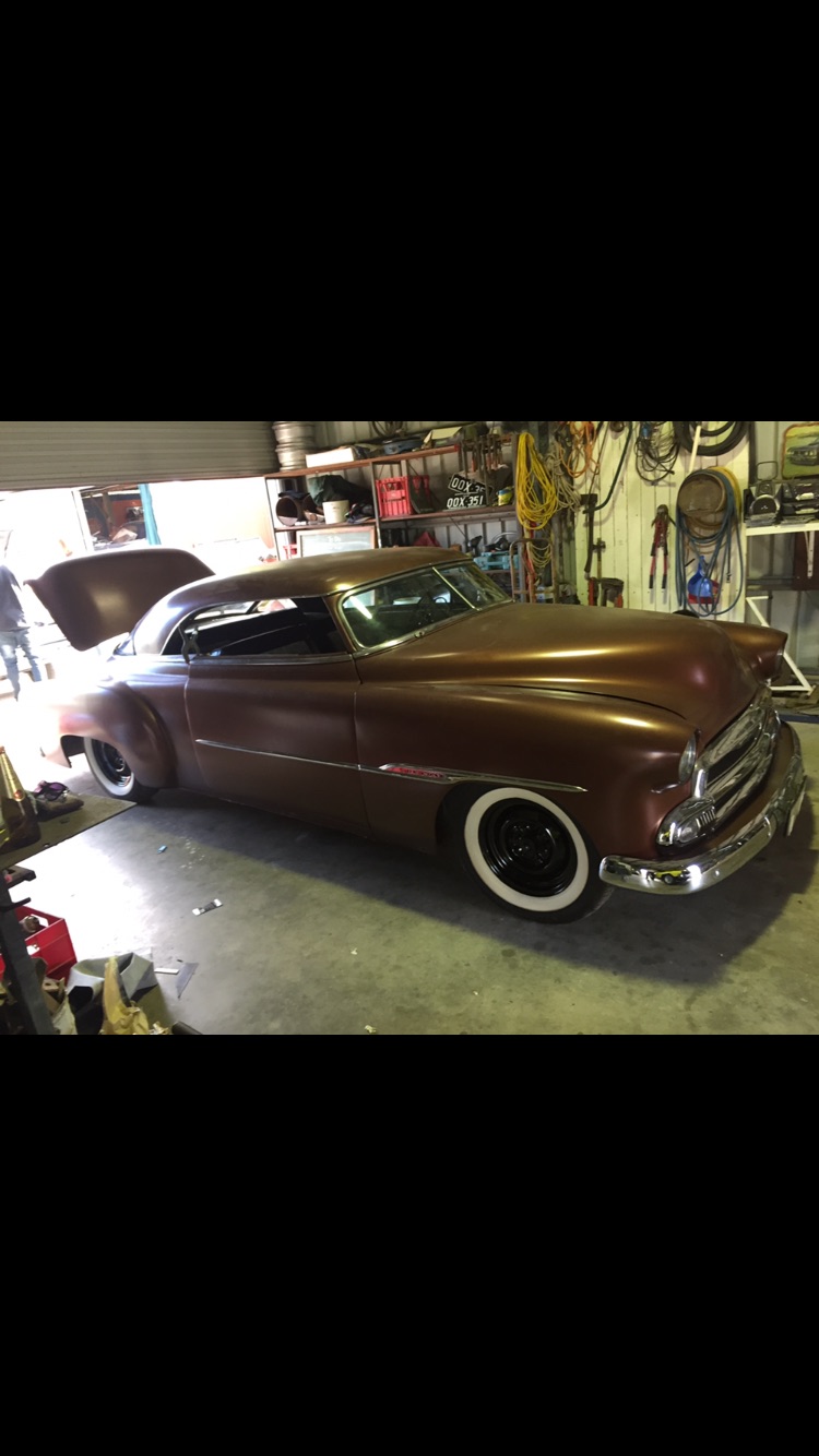

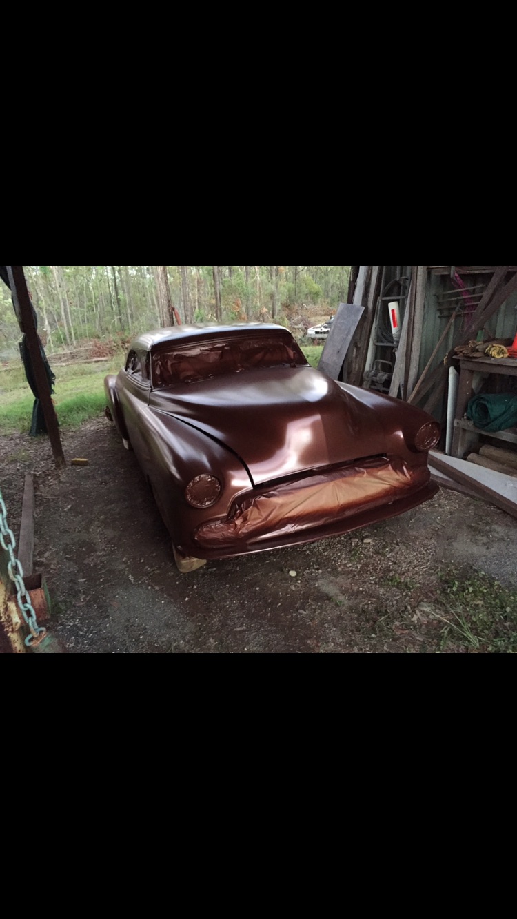

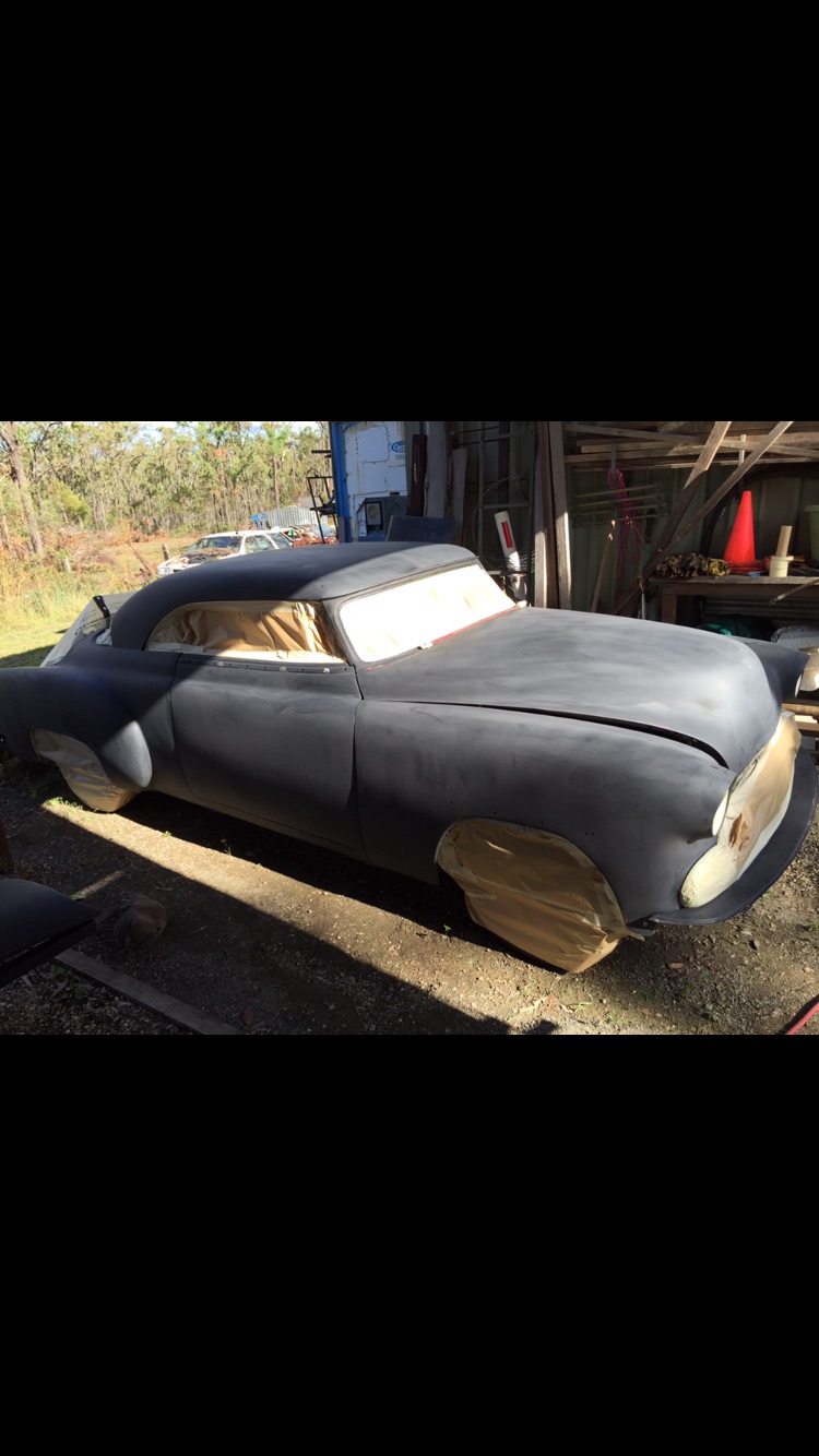

    I've been busy, masked up for paint! image.jpg image.jpg Sandblasting the gl***. image.jpg image.jpg image.jpg image.jpg image.jpg
