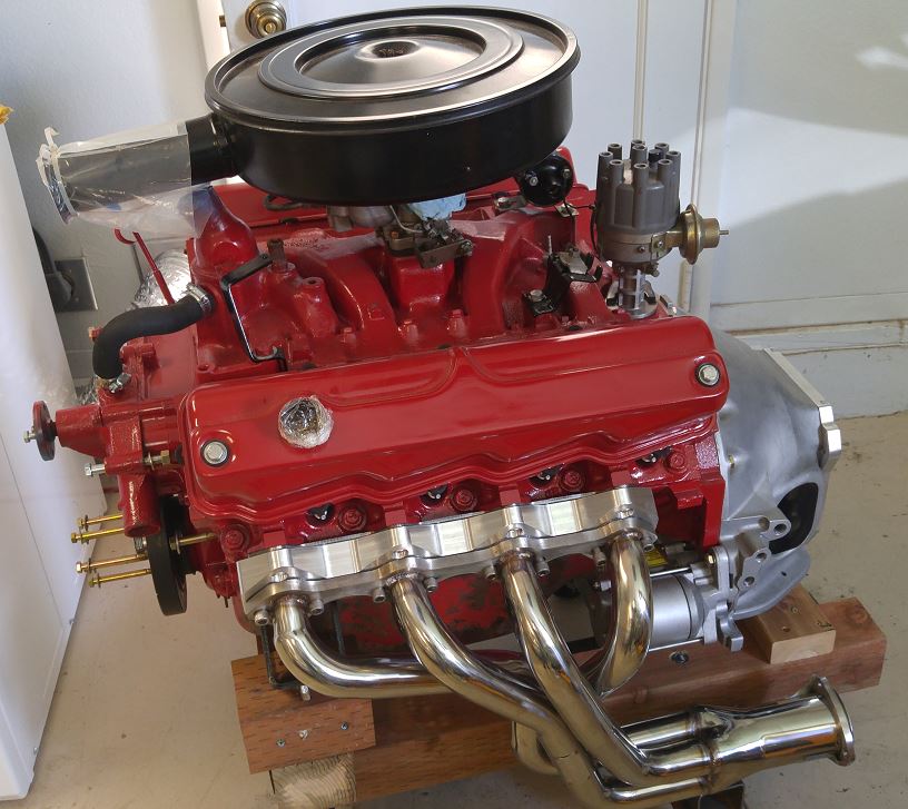

    Absolutely Slayer. I have 302-351 Ford Headers on my Poly 318 because they were (alot) less expensive and available in stainless. Port center on the worst of the cylinders was only .040" different between the Ford and Poly.
  18. Earlymopar,
    That Poly looks beautiful,,,,,,and the headers are very slick,,,,,wise decision.
    I can’t get over the exhaust adapter,,,,,now that is what I call craftsmanship !
    Tommy
    Hnstray, unforgiven, Deuces and 2 others like this.

    Thanks much Tommy. Interestingly a year or so after I made these, a poly entry in the Engine Masters compe***ion made a similar adapter for sprint car style headers and they found through dyno testing that the length added to the exhaust port by adapter was also an H.P. adder. They also did further research and found that intake port centers are similar to the Chevy LS platform so that opens up a boat load of possibilities.

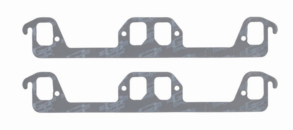

    After laying a gasket over the flange it looks like I will need new flanges welded on.That's not a real big problem.I was just hoping that I could get away with re-drilling what was there.Thank you to those that posted useful advice.
  23. RodStRace
    Joined: Dec 7, 2007
    Posts: 9,912
    RodStRace
    Yeah, that wasn't going to be a drill and go...

    However after seeing the gaskey mismatch, I'd say I am now not warming to the idea...

    The chevy ports look awful small compared to the Dodge ones. They would probably hurt HP more than help anything. Even re-flanging them unless you open the tube size they would hurt exhaust flow.

    I’ve a set of SBC manifolds and a set of 318 and a set of 360 manifolds. If I can locate an old set of SBC header gaskets I have somewhere, I’ll post pics of them laying on the Mopar manifolds.
