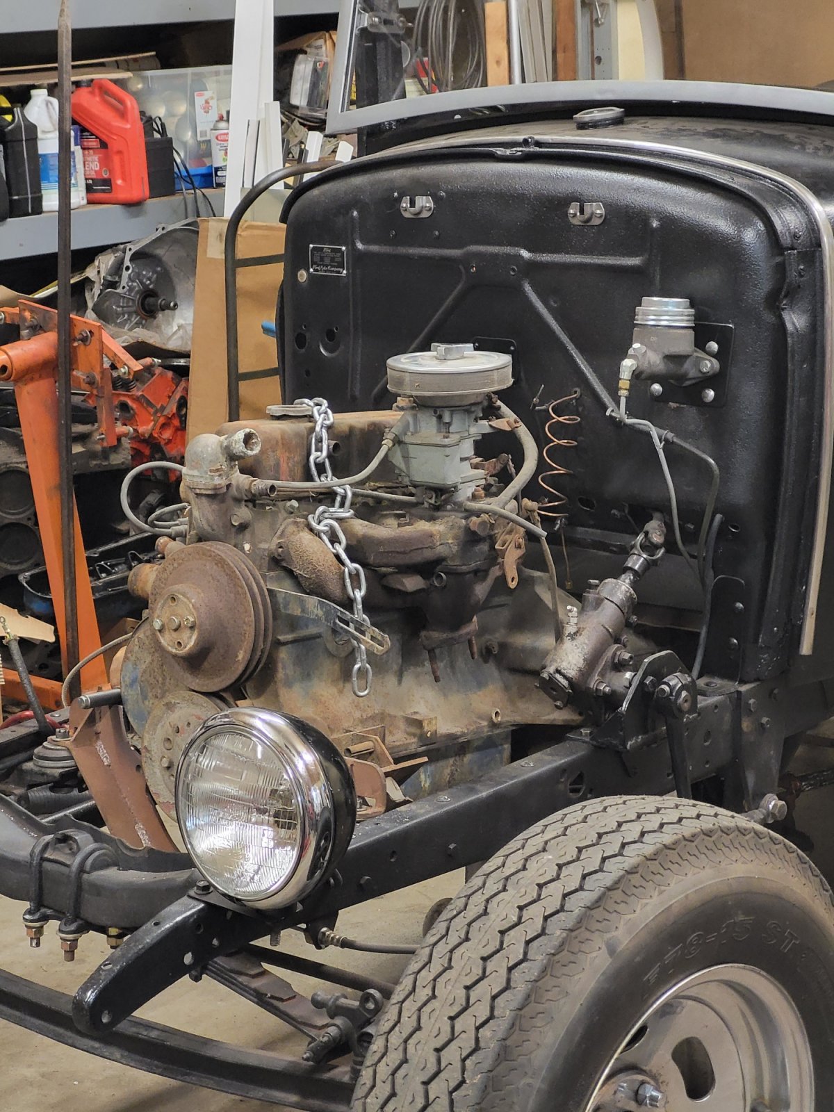

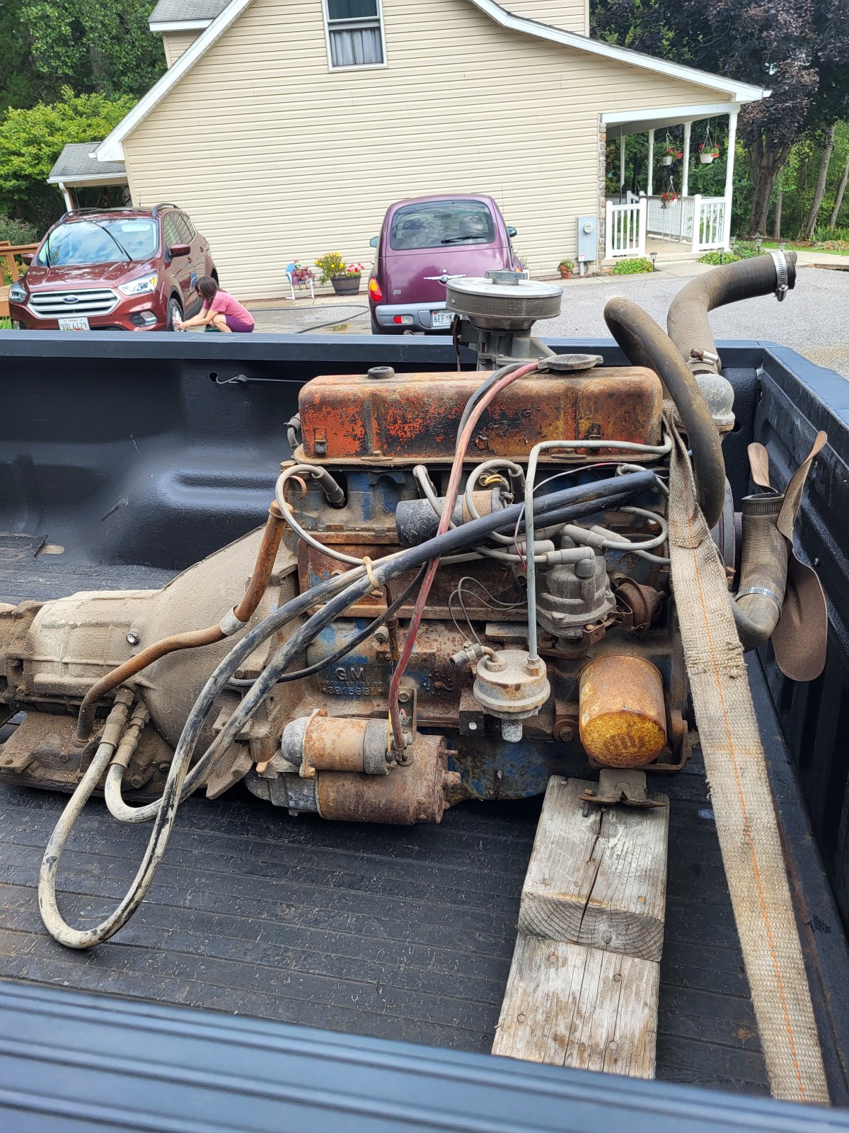

  1. 20220919_135551.jpg I just bought, what I think is a 153 with a Powerglide behind it. It came out of a 1970 Postal Jeep. I'm thinking about doing something for the intake and exhaust, if nothing else for looks only. Are all of the marine intakes water cooled like the exhaust are??? Thanks, Gene.

    I think so but the umc offers a dual carb set up! I think you could just plug the water ports if you wanted to but the boat motors I have see. have a different thermostat housing/ water neck that has a port to run a short house to the intake and wouldn’t be to visually distracting should you decide to water heat it

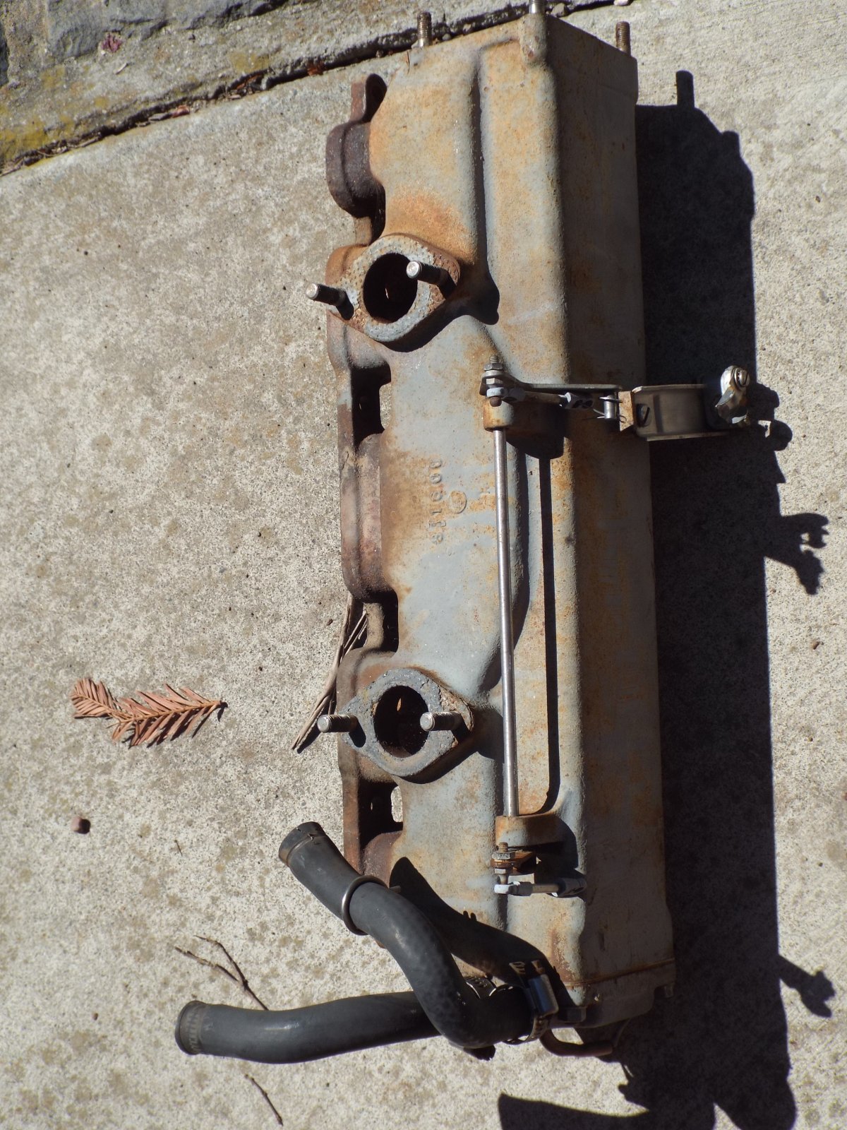

  3. I believe the marine manifolds intake and exhaust were all one piece. Be careful there are also 140hp marine manifolds that fit a different head for the 181 cubic inch version. What are you going to put it into? Look for "Clifford" and see if they are still in business for manifolds.

  4. Charlie, I plan to put it in a Model A kinda thing I have been working on. My father had one in a boat with twin carbs, but I couldn't remember exactly what the manifold looked like. And thanks, but I did check Clifford, however, they didn't show anything. Gene.

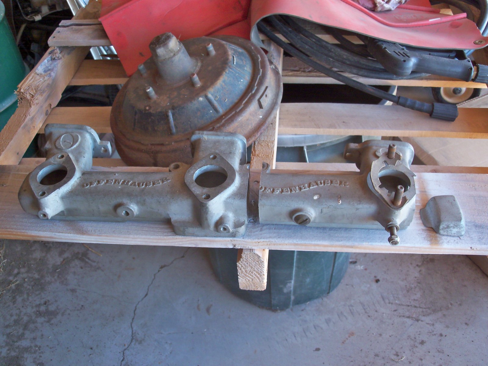

    That's a nice solution, I wonder who came up with that idea? :D 100_0810.JPG 100_0812.JPG
    CNC DUDE on this site & maybe this thread makes a dual Weber side draft manifold. The guy I got my 153 from had a marine two carb manifold that he had cut all the water jacket stuff off of. I wasn't pretty but it worked. He was thinking of wrapping it with exhaust wrap.

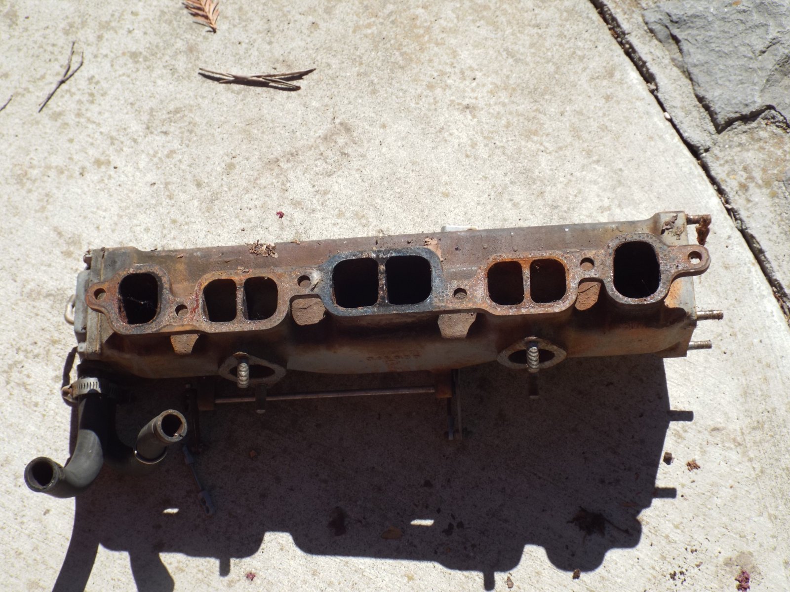

    The Mercruiser 153 2 carb manifold was water cooled and quite ***bersome looking for a street rod. I have a complete engine if anyone need parts.

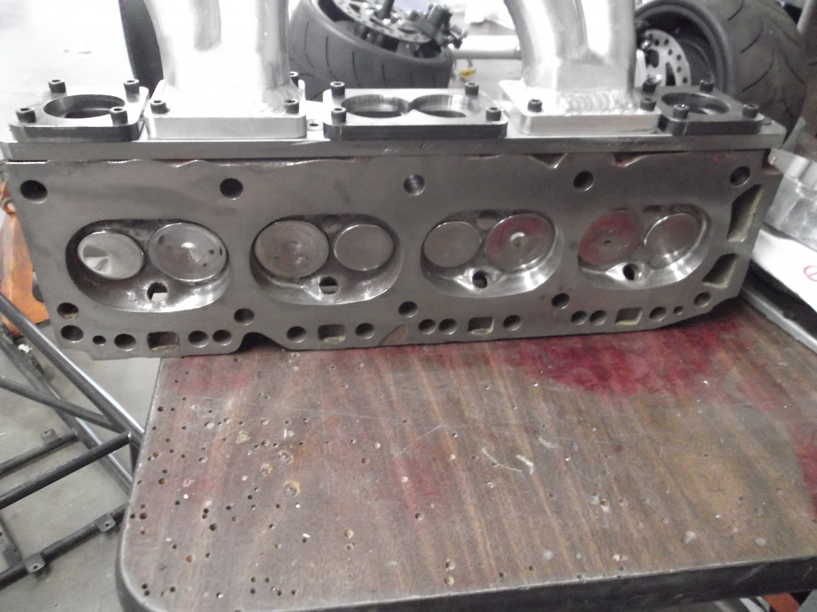

    I dimensioned the head and drew it on Mastercam software, sent it to a company who lazered it out for cheap

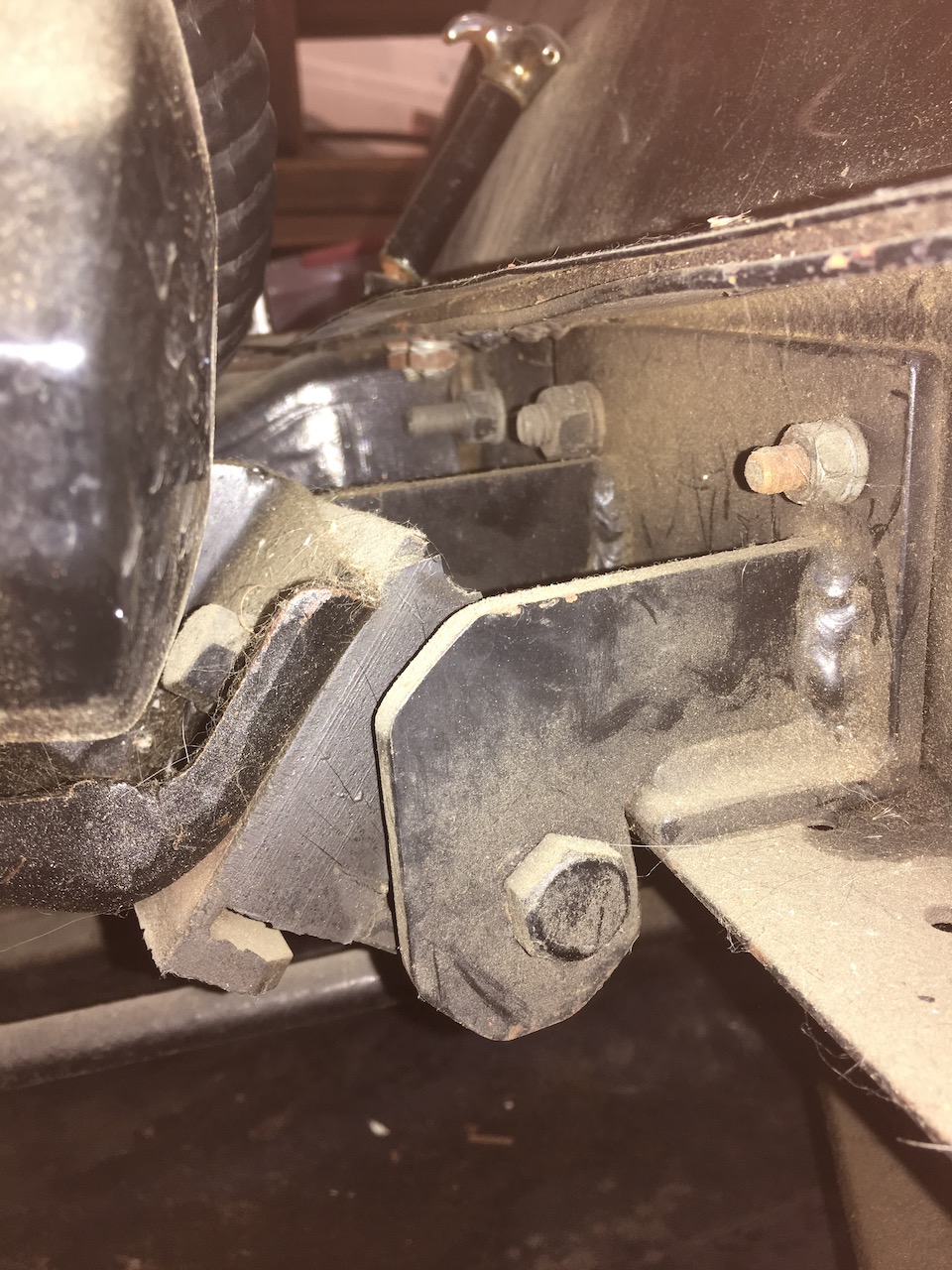

  16. For your info here is how I set up my motor mounts.
    OFT, Six Ball and alphabet soup like this.

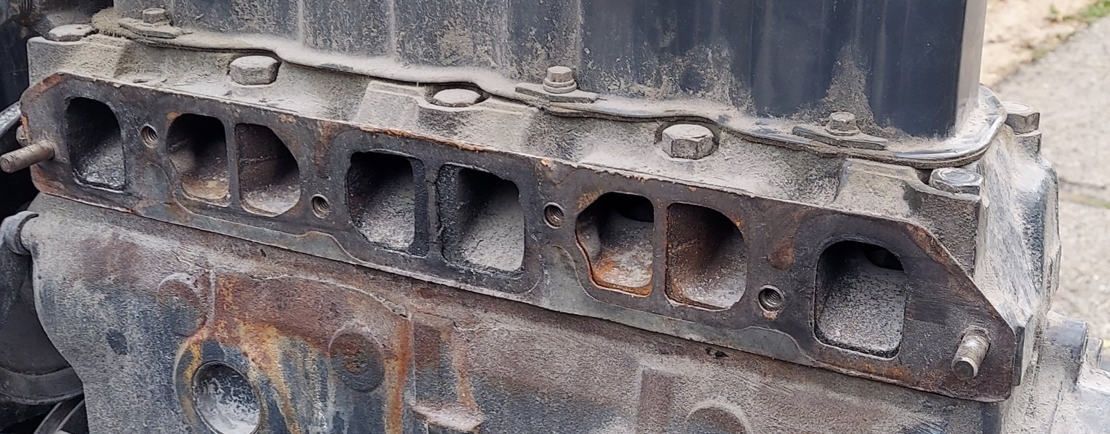

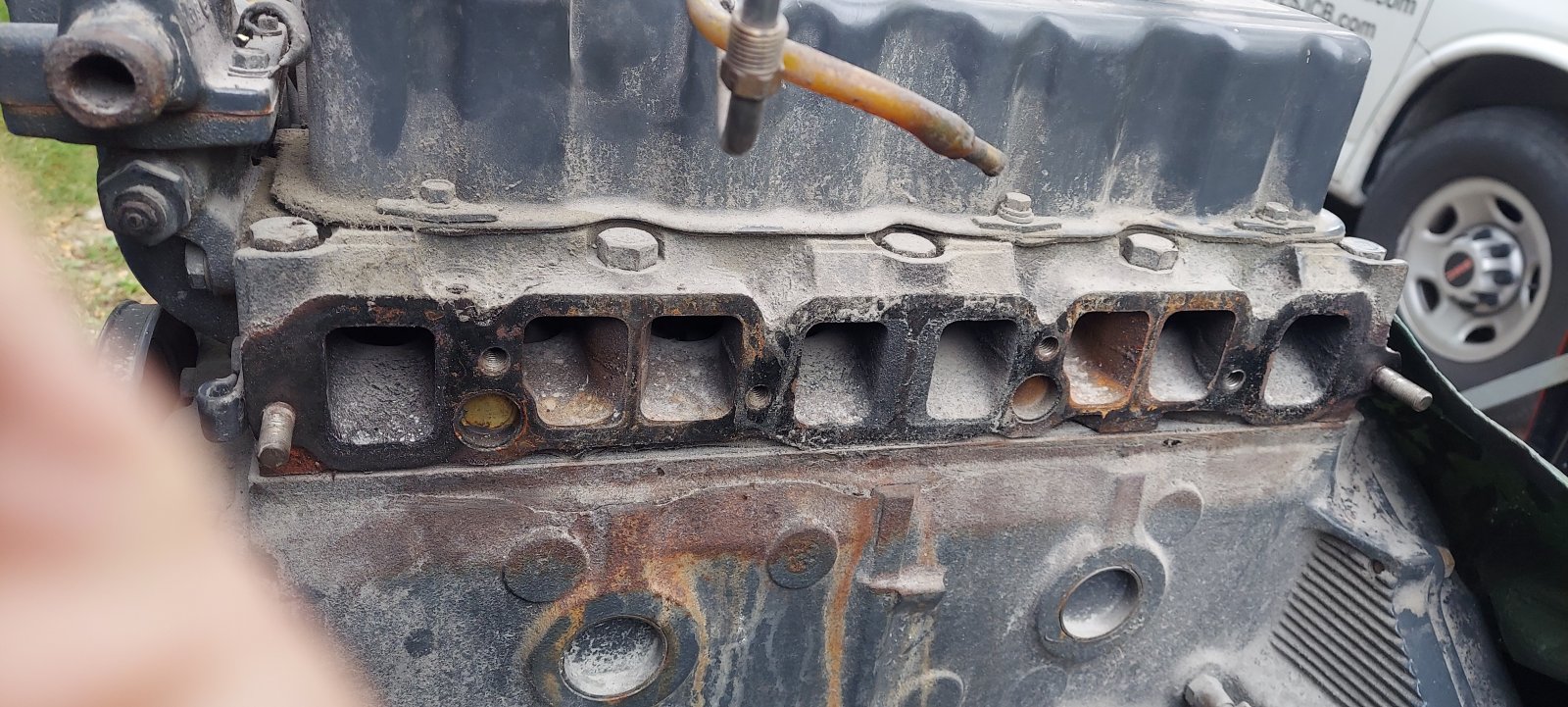

    Any of you guys seen this port configuration on a 181" head?
    I picked up this cracked block OMC with a center sump pan complete engine yesterday at a swap meet thinking I was maybe getting a better head for my 153" project.
    Pulled the intake/ exhaust off and noted the odd D and other misshapen ports.
    Good / bad / OK ???
    I always get the odd ball weird one year only stuff.

    I think it is one of the 8 port 181 heads. OMC may have used them in 153s I don't know. I don't know if it's the best one but it is probably better than the 153 head which is really not a bad head.

    Well now I feel like a idiot .
    It stopped raining and I went out and pulled the tarp off and took a closer look .
    The GASKET has odd port shapes as did the intake BUT after pulling the gasket it's pretty a pretty normal 181 layout after all. Sorry for wasting people time.
    Block is made in Mexico and it's got a points distributor so I'm ***uming for now it's a 2 piece crank seal .
    Shame the block is cracked .

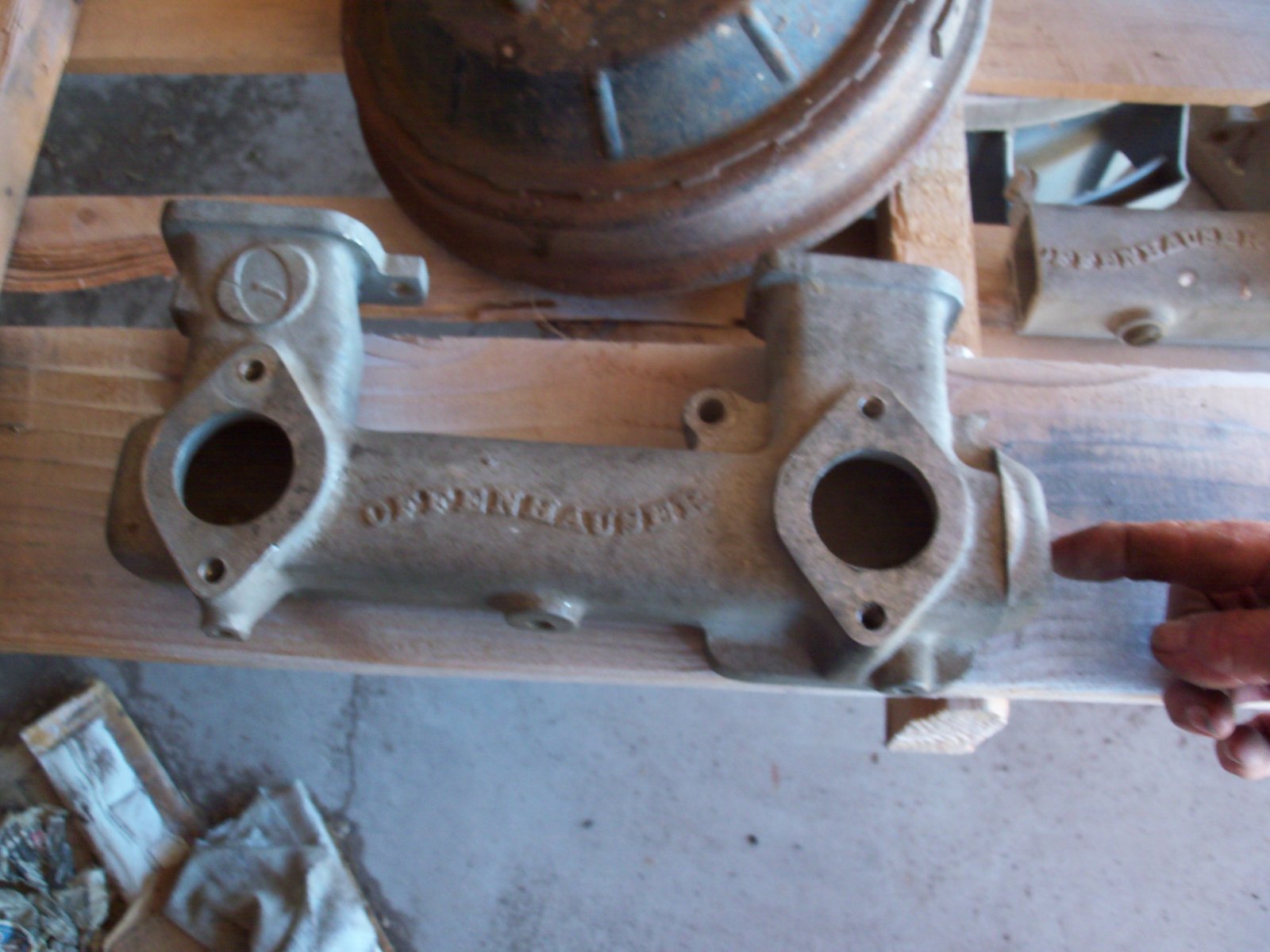

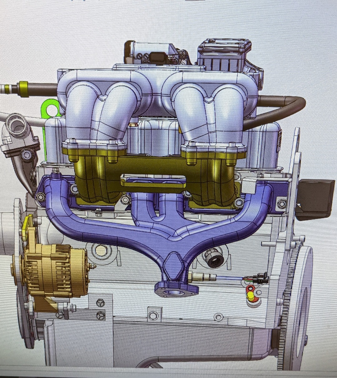

    Here is the lower intake I'm trying to get my hands on. It fits a Clark forklift I have seen in person.
    I may be able to get the two intake haves and the exhaust also .
    If so it bolts right to a 181 8 port .
    I'd want a header but the bottom of that intake would make for a easy 2 carb set up .
    Bottom us cast iron , top hand os aluminum .
    The top half that goes over the valve cover would work great for a turbo with a intercooler or a blower like the Eaton mounted on the RH side maybe. Non traditional but food for thought.
    Any way the parts are out there on some forklifts.
  21. If that question was for me...I did not. It's a Hurst mount for a BBC. The heavy Alt mount you can see right behind the left headlight is the one from when the motor was in the Postal Jeep. I'm bolting the Hurst mount to that, on that side and to a pair of threaded holes in the block on the right side. I had to trim the mount in one spot, need to drill a couple ofholes and make a couple of spacers. I won't be as nice as what some other guy's have shown, but it will work fine for me. Gene.
