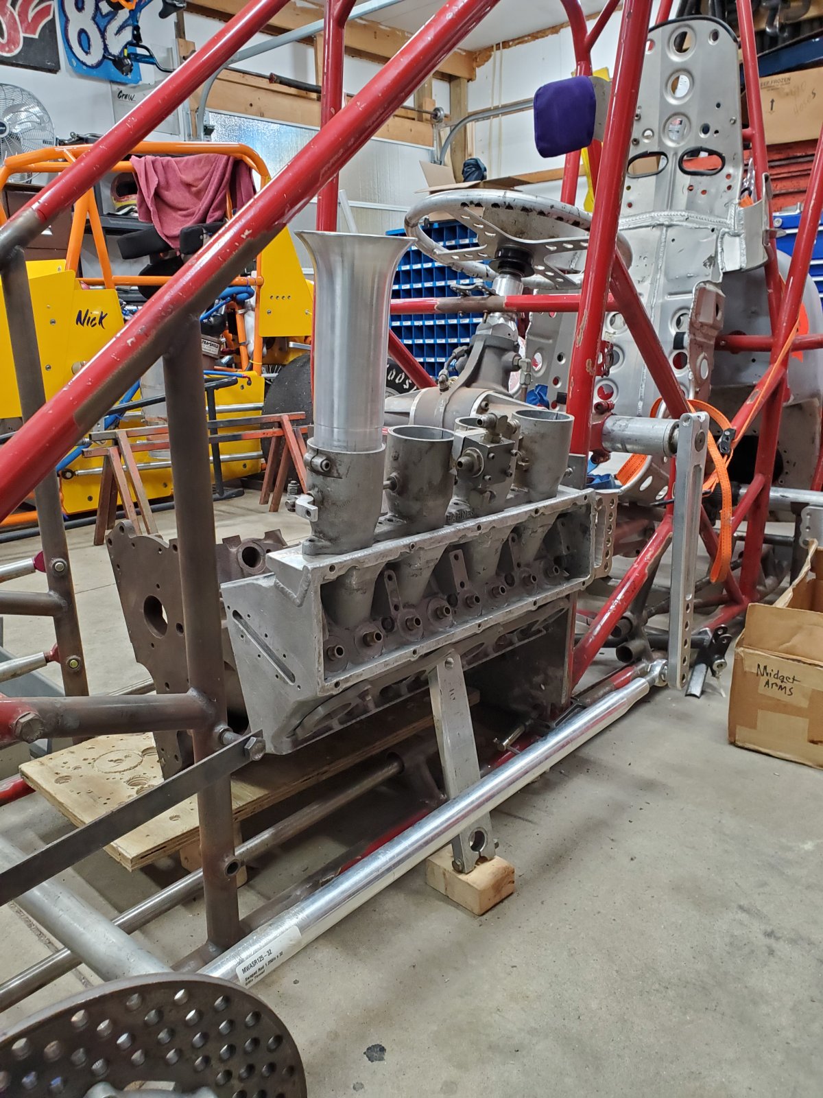

    I thought you guys would love to see the monster I'm working on. No I am not a hot rod guy. My family has been involved in open wheel racing since 1953. My grandfather owned a machine shop for over 50 years and did a ton of innovations for the sbc. In 1982 my father dabbled with a midget for a couple years. He took a 181 engine, welded the water jacket up on the deck, drilled the deck for a sbc head, and laid the engine flat in the car. Fast forward 40 years later, I'm rebuilding the engine with a modern twist. Rather than a factory sbc head I am using a Barnes down draft sbc head and a modern dry sump system. Unfortunately I lost my father in a racing crash in 1989, my grandfather do to dementia in 2019 and my step father who owned the engine shop that my sprintcar engines were built in passed away in April. At this point I think it would be easier find the lost Ark of the Covenant than peicing this thing together. I'm trying to not make all the same mistakes learning to build this as my father did. He built two of them. One as a vertical engine, and one as a horizontal. Unfortunately, I have the vertical. So trying to guess all the problems that will arise from it being nearly flat has been. I'll try and post more later. Right now I'm finishing up hand making the parts for the cylinder head, and working in the water pump and oil pump drive parts. The debate right now is whether I use a harmonic balancer or just a balancer wheel.
    Nick Landon
    Feather Ruffler Engineering
    Landon Racing
    Tman, Tim, alphabet soup and 3 others like this.

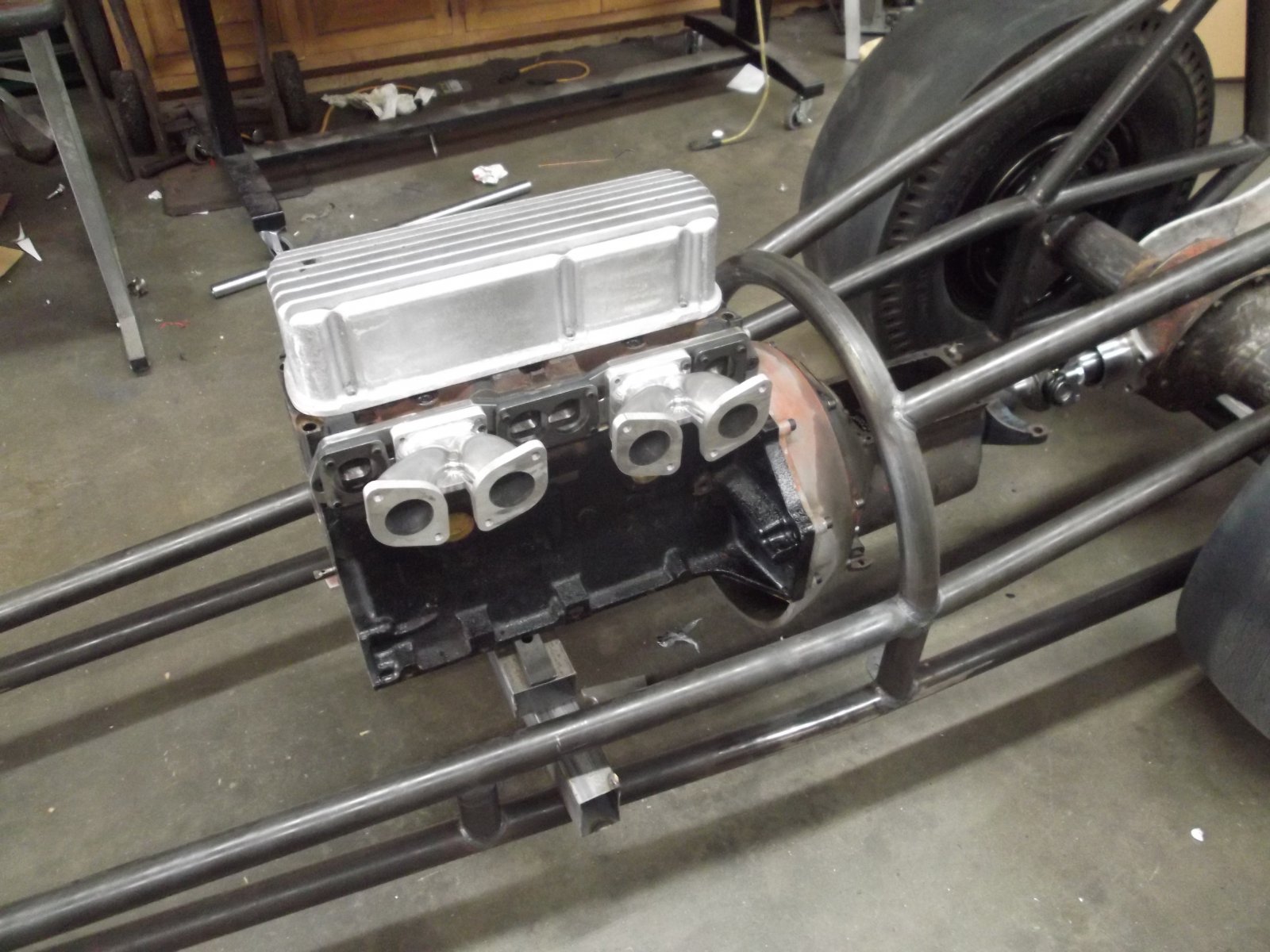

    Since my block had water damage in #4, I had to go with .030 over (3.905bore)

    Early 60's Dragster
    Tman, Graham08, Tim and 2 others like this.

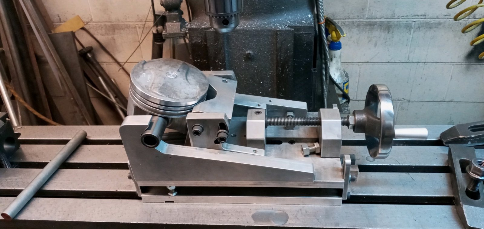

    Six Ball,
    Here is a picture of a piston vice I made, could be set to cut the tops flat. Also if you have a lathe and a mill you could make these jaws for your lathe or buy them. ( The pin should not be in, it will fly out! I just left in for the picture. piston vise.jpg lathe holder.jpg
    Tman and alphabet soup like this.

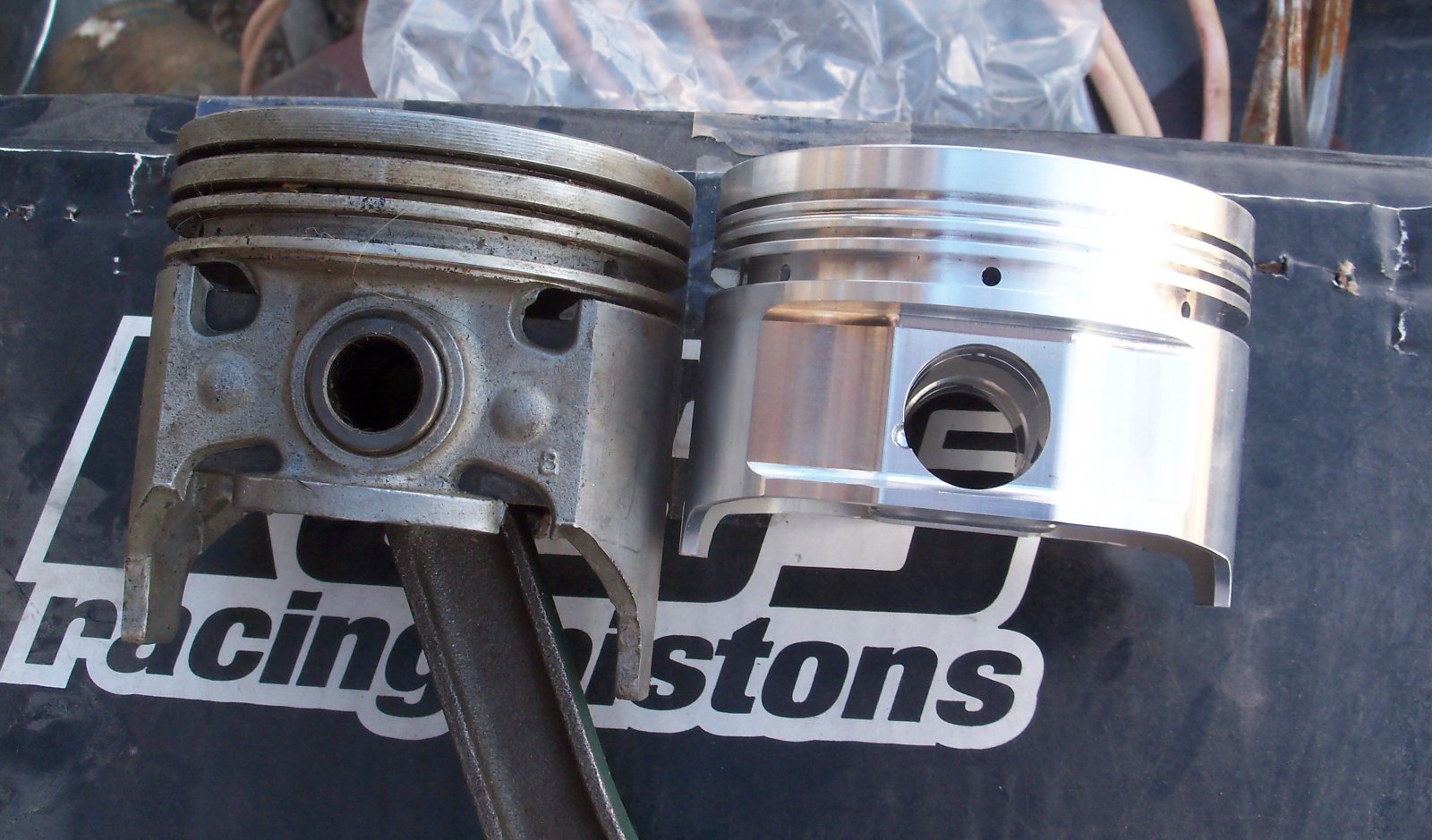

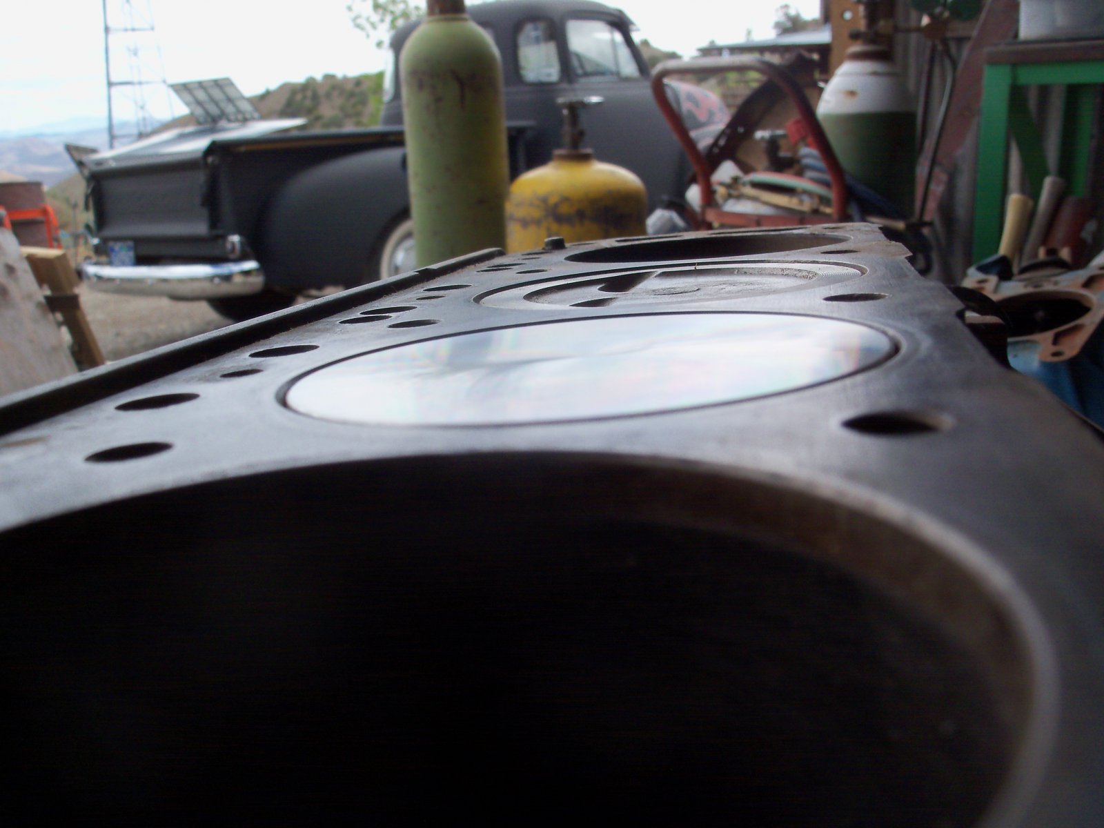

    I think I was where 1biggun is now a few years ago and was enthused enough to figure this stuff out amongst the BS. I think I still have my notes around and possibly some pictures have survived too.
    The 194-292 Chevy sixes were designed to use many of the same parts as the small block V8. Figuring out which ones is the issue.
    My 153 as I got it. 0.040 over Pistons 0.050" down the hole.
    Below is a 0.040" over 307 on a 181 rod with the 181 crank and one of the stock 153 pistons sticking our of the top.

    Below! Obviously no pictures below are below that. I was having trouble, still am, loading these old pictures and just quit to watch a baseball game. I''l try again.
    The one in the last post is what was in my 153 when I got it. Next is one of those pistons (4 valve cuts) and a 0.040 over D-dish 250 Chevy 6. ( 153s are 2/3 if a 230)
    Next we have The same D-dish and a 307 0.040 over with two valve cuts. (the only ones of these I've seen.

    Finally the forged custom Ross 250 flat top and the two cut 307. They do not show that the Ross is actually 0.020" above the deck. There is another picture that shows it but I can't find it.
    I was focused on "zero" deck height. I should have quit with the 2 cut 307s and that is what is on the rods now. I bet the flat tops would work well with fine with a 153 crank and some decking.

    The D-dish piston in the pictures is a 250. I rejected it because of the big bevel around the outside edge and it's affect on CR..
    The forged Ross flat tops were custom ordered, by the guy I got them from, with an extra length to the top. Ross will make them any way you want. I believe 250 & 307 are the same. The problem is the replacement piston makers don't tell how much they shorten their pistons to retain stock compression ratio for over bore increments. The bigger the over bore the shorter the piston. That could be made up by decking the block if your machinist had the pistons in hand.
    Here is one of the pistons that came in my 153 next to a Ross. Note extra material above the top ring.
    I haven't really looked into pistons for the 181 but I'm pretty sure a decent choice is out there.
    The 6 cylinder family the 153 comes from have an accepted over bore limit of 0.060" = 3.935". I have a 250 block with pistons that have 0.080 on the top. That would be 3.955" still well short of 4".
