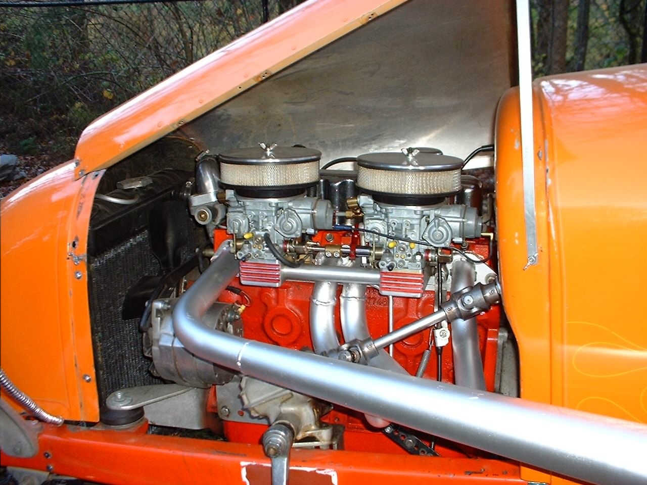

    Pretty sure this is the same car and was for sale here .
    home made intake and exhaust on a 153" progressive 2BBL's
    I think the stuff I have coming will put the carbs through any hood if I use one .
    I like what he did on that intake.
    38 Hump and Tim like this.

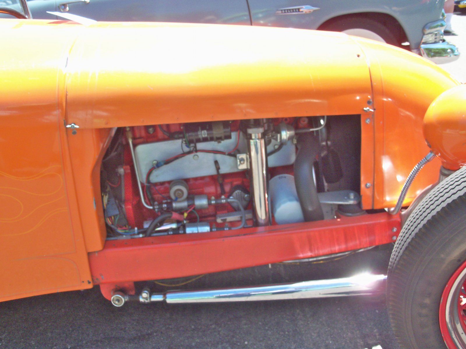

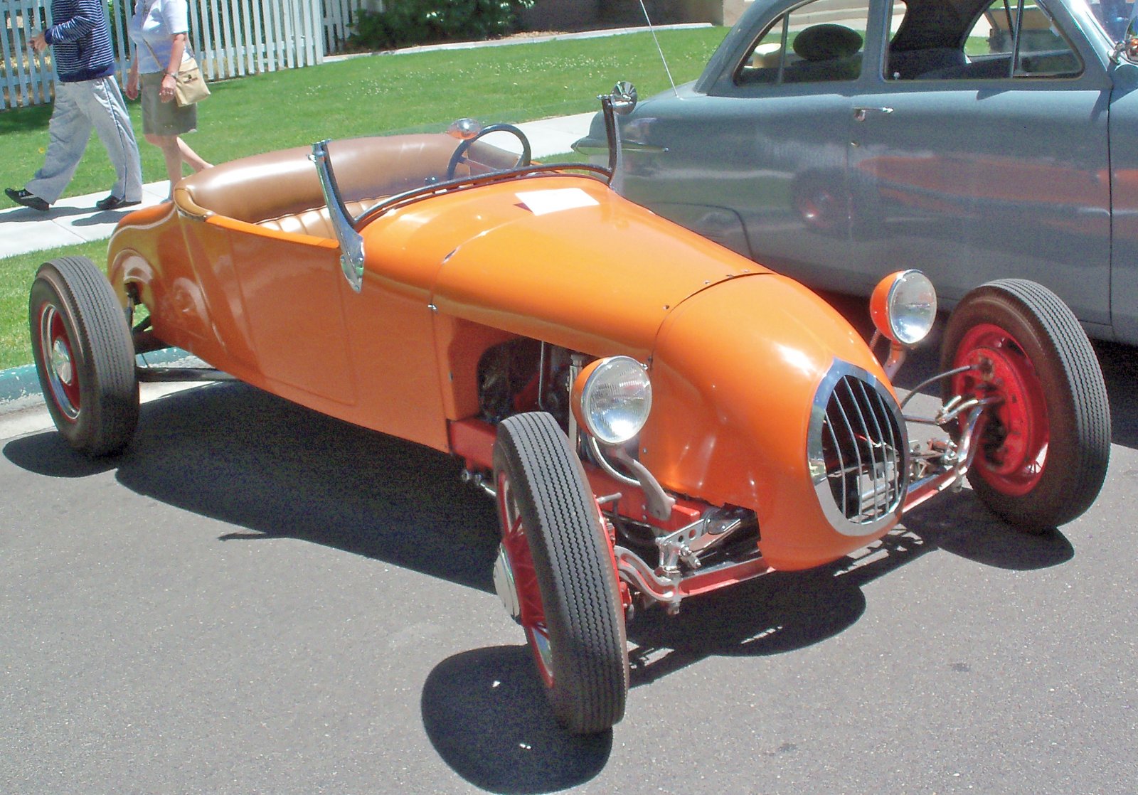

  26. Six Ball
    Joined: Oct 8, 2007
    Posts: 6,757
    Six Ball
    from Nevada
    Same car for sure. What part of the country are you from. I took my pictures in Carson City ,NV in 2012 at the Inliners International Convention. I think Tom Lowe bought it after that. He is from Iowa.

  30. Six Ball
    Joined: Oct 8, 2007
    Posts: 6,757
    Six Ball
    from Nevada
    So he had it for sale 3 years after I saw in in Carson City. I sorta know that guy through some posts on the Inliner International site as well as the club. The car was built well with some interesting features but several details bothered me. The exhaust was one. I think it went to Iowa, either that on or another one that was there in 2012.
