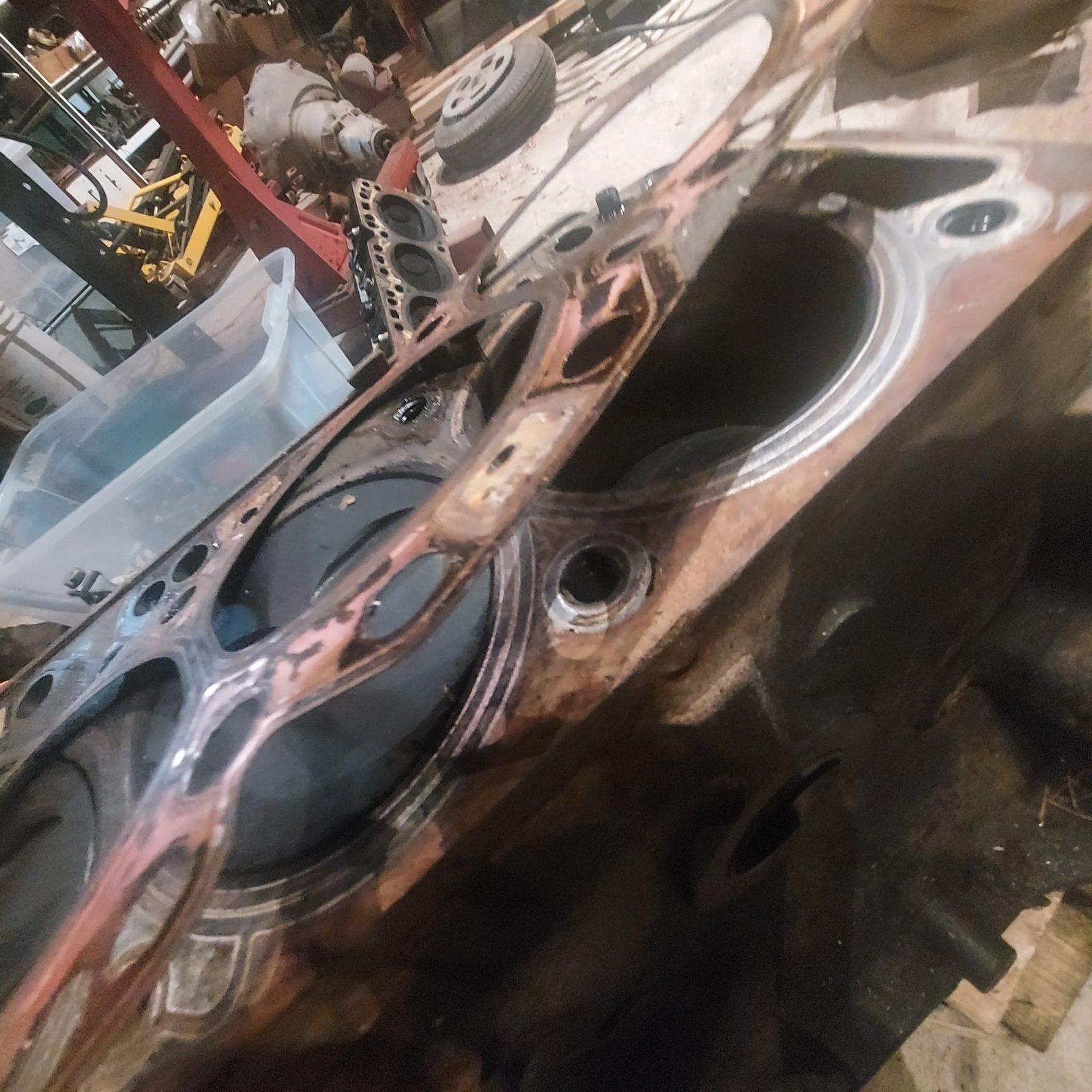

    The 120 HP Mercruiser 153CI I just
    pulled a head of also has a steel shim head gasket .
    It had 4 eye brow flat tops that were about flush. Shame the block is cracked.

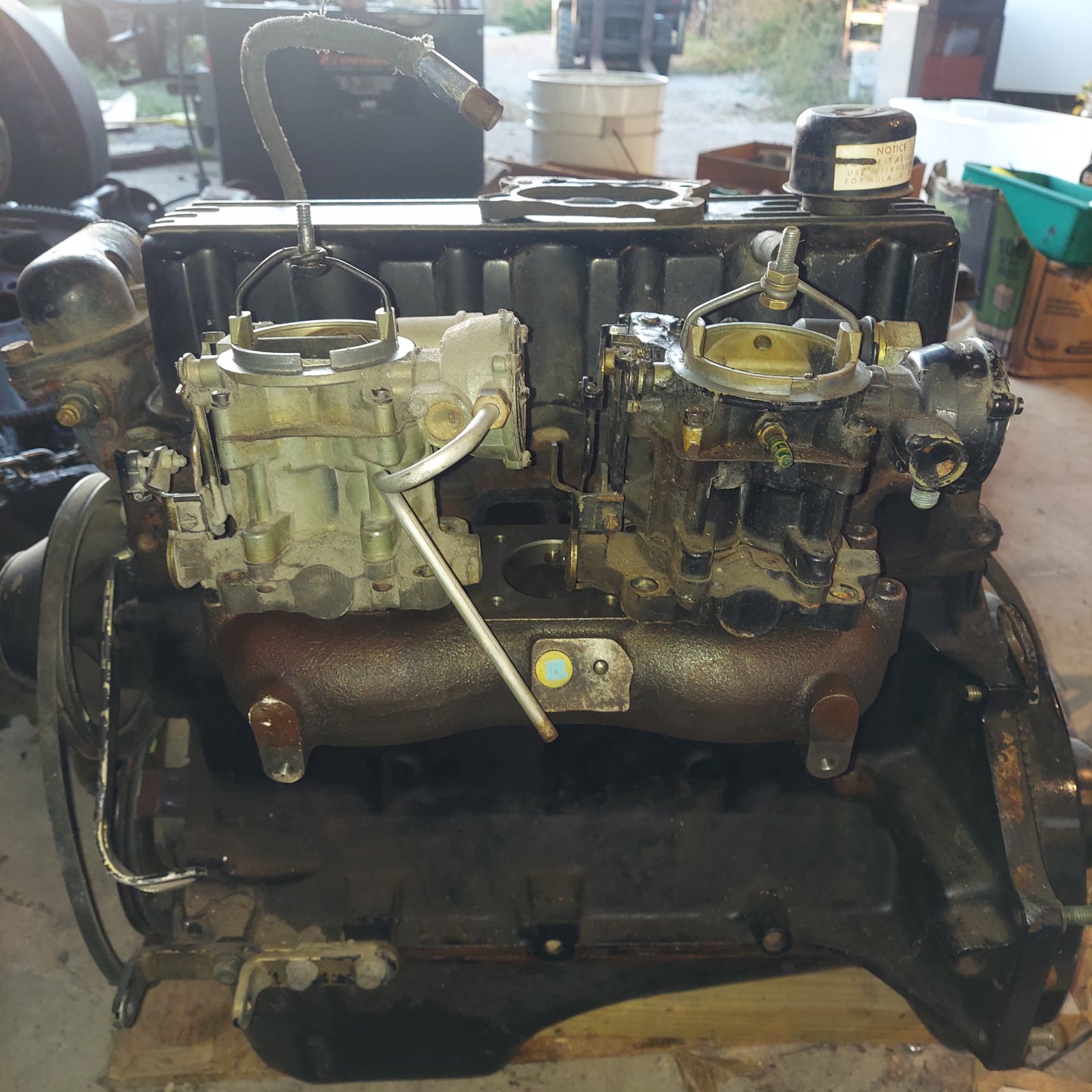

    Well my guy came through and I got 3 sets of manifolds.
    There smaller port than the older (pre 91 or so ) 3.0 head. The intake will work on the early head it's just going to have a much smaller port feeding a bigger port that's got a much lower bottom. ( lumps or something maybe ) I'm sure it will run fine with a smaller port centered in a bigger port .
    The exhaust ports are much smaller while they cover the earlier head ok there is going to be big step going out so not good . Maybe some porting on the manifold or a transition plate sandwiched in or both . There is a fair amount if material on bottom of the exhaust to allow for enlargement.
    A later post 91 or so head would be the way to go I think that would be on the 1 piece rear seal engines.
    I may have a line on one. ( MAYBE )
    I'm not convinced the later head has more power potential however .
    They claim it makes more but yet the later engine is onlyv rated at 135 not 140 in Mercrusiers literature and that's with electronic fuel injection.
    I think a Rochester 2BBL carb bolt pattern can be drilled and tapped directly into the existing flange on the dual intake . If not a adapter spacer is simple . I laid a Rochester gasket on the intake and I think there is enough meat ti drill and tap and the butterflies align near perfect.
    Might be better if there was a common plenum but the carbs are pretty high already .
    Might be a bit tricky to get each barrel on two differant ports to have the same air fuel mixture needed to run a individual port manifold .
    The exhaust is a poor fit for the 153" head the intake likely would work but it's two ports going into the common single 153 port . as long as it seals I guess It will run OK .
    It might flow into a lump head pretty good . 20221015_140905.jpg 20221015_134322.jpg 20221015_141335.jpg 20221015_140905.jpg 20221015_134322.jpg 20221015_141335.jpg 20221015_141335.jpg
    I also got a Impco brand cast iron intake also in the deal.
    It's got small ports while it will run its certainly not a performance piece. Will need a carb adapter or a one barrel or something .
    The mock up looks good .
    But I'm pretty sure some mods will be in order to use the rear exhaust to gain firewall clearance. 20221015_140905.jpg

  3. Tim
    Joined: Mar 2, 2001
    Posts: 19,027
    Tim
    from KCMO
    Looks good!
    I’ve seen similar ford banger intakes with a small, 1”? Balance tube run between the two halves. Might be able to drill a hole and braze one in.
