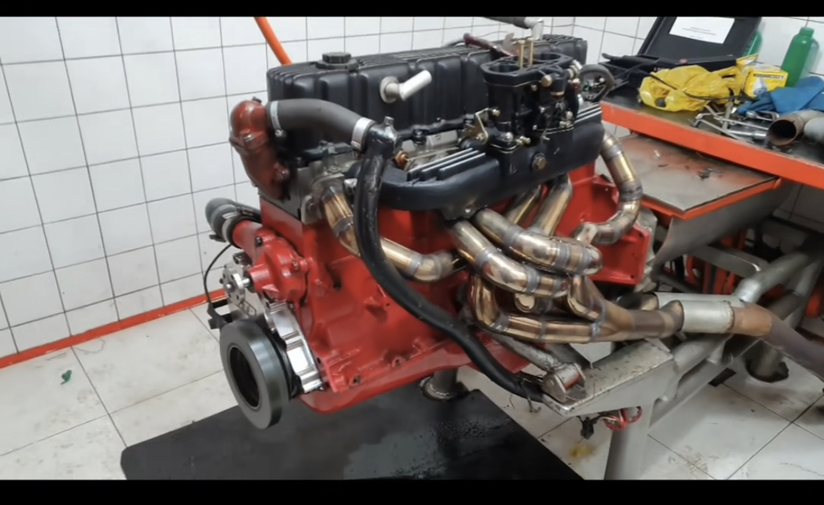

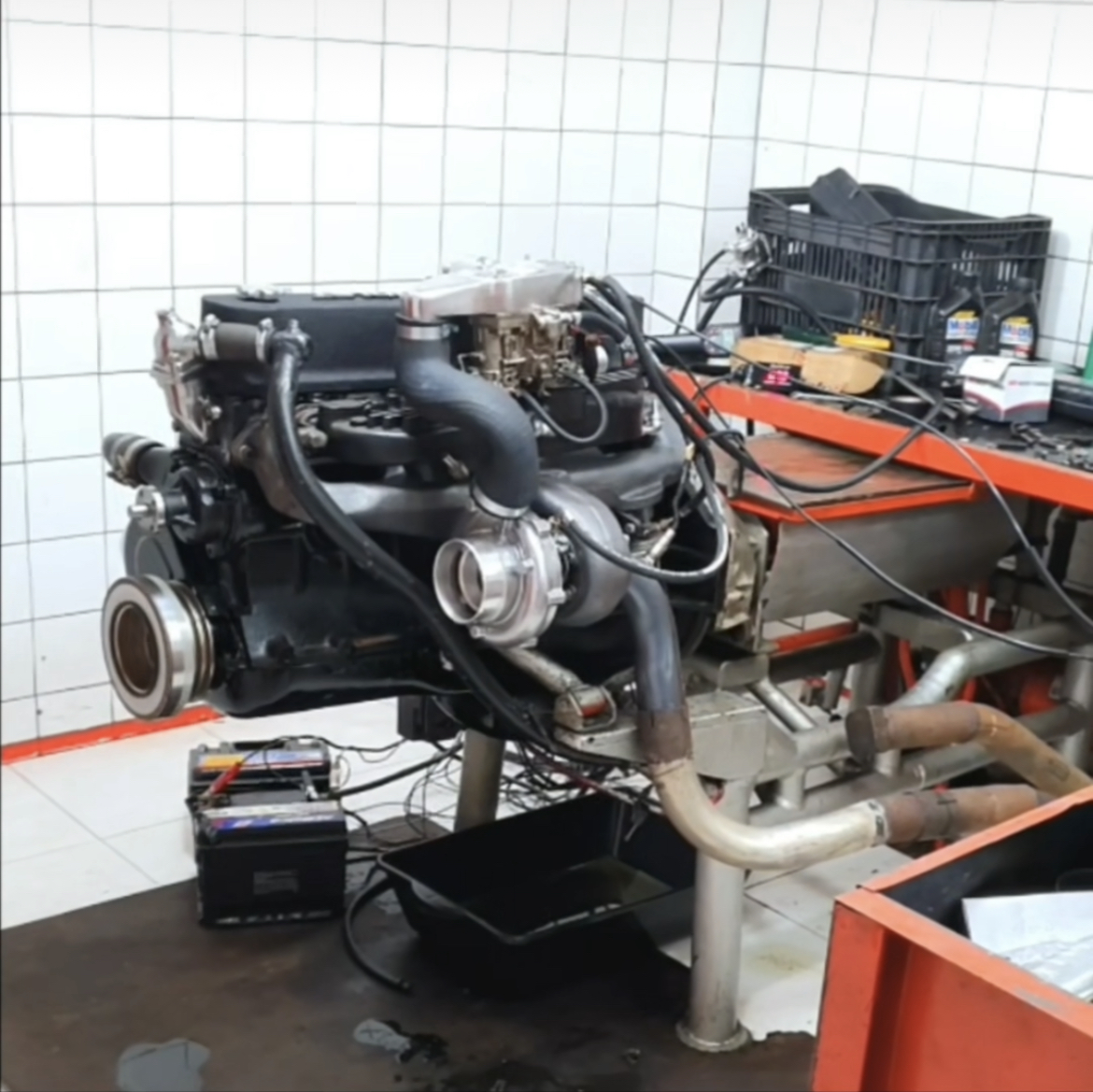

    That would be Classic Racing Parts in Brazil. You can find them on Facebook and as classicracingpartsoficial on Instagram. I posted a Weber intake earlier. Brazil even made a 3" stroke 4 with 6" rods to lessen vibration.
    Tim likes this.
  2. Tim
    Joined: Mar 2, 2001
    Posts: 19,576
    Tim
    from KCMO
    Well hot damn! Looks like I’ve got some
    Exploring to do! Thanks :) B6E182FB-7E40-4C8D-81FB-B38033813AD5.jpeg 2CF8D400-DE8F-45A4-BAA0-F0BCDA3D18E0.jpeg

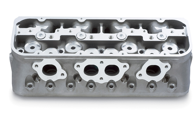

  11. Back in post #317 Mr. Gun showed pictures of three heads. Is the large port head from a 140hp motor?

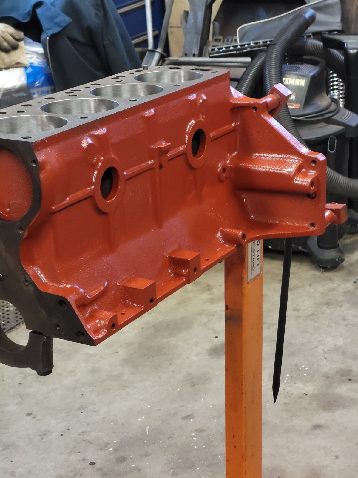

    Also, I got my block back today...turned out pretty darn good. .060 bore now, .030 off the top, new cam bearings, cleaned-up and some new paint. Gene. Resized_20221019_180014.jpeg
  12. Six Ball
    Joined: Oct 8, 2007
    Posts: 6,755
    Six Ball
    from Nevada
    I think all of the 181 boat motors were rated at 140.
