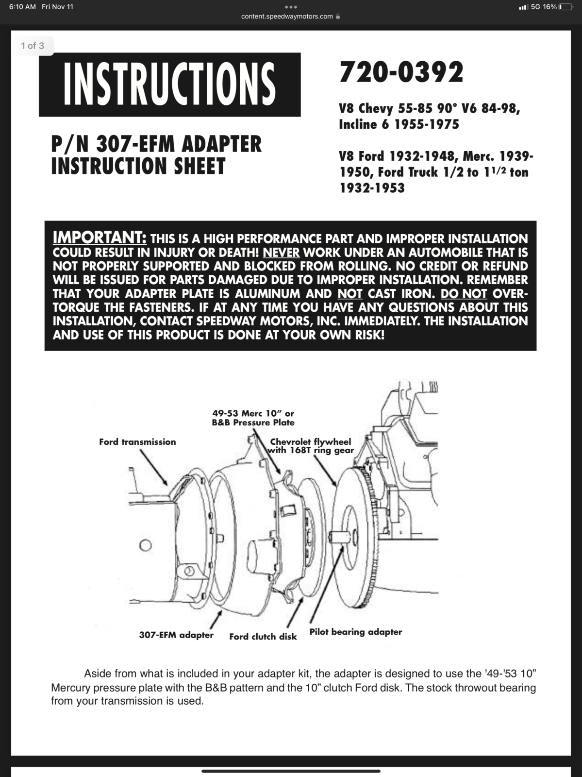

    I’m looking to stick this into a model A with a early V8 trans behind it.
    Seems like an easy swap.
    49-53 pressure plate, ford clutch disk, ford throw out bearing. My question is the flywheel/starter setup.

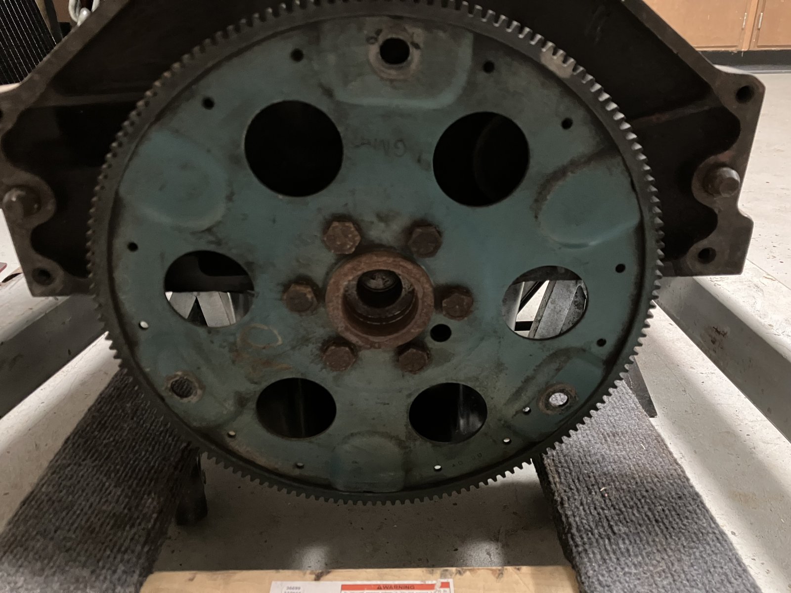

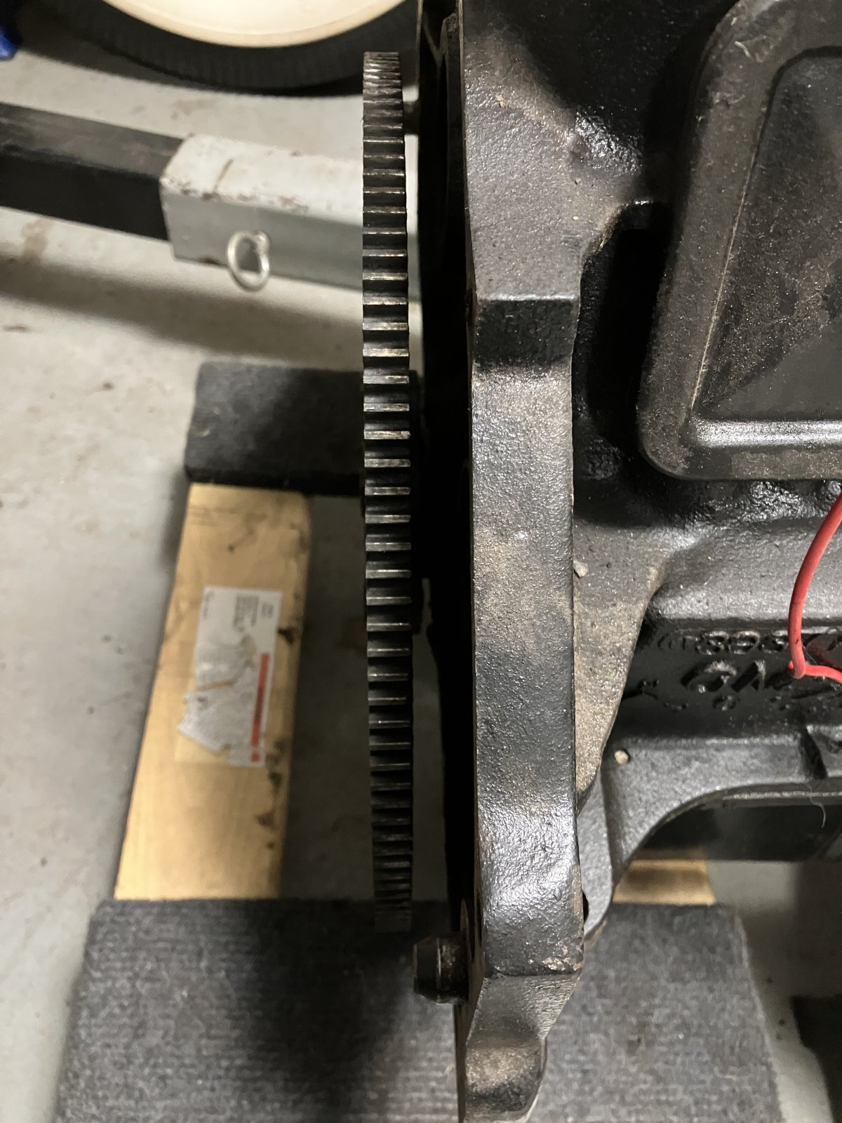

    This 153 flywheel looks different than the SBC flywheels I’m seeing on-line.
    Should/can I use this flywheel (153 tooth)and starter setup? Any reason not to?

  4. At the risk of me asking a stupid question...you do know the flywheel on that motor is for an auto trans?? Gene.

    Stupid to ***ume I know what I’m talking about….just kidding.
    Actually, no I didn’t. But noticed it has a lack of weight compared to the model As I usually mess with.
    I’ve only replaced one auto trans before and it was a direct swap, so really didnt pay attention.
    So, what flywheel do I need? The speedway adapter directions don’t call out a specific flywheel, but call for 168 tooth ring gear for some reason.
    Trying to figure that out..
  6. I'm not sure why you need a 168 tooth flywheel. It may have to do with the bolt pattern of the pressure plate. A 168 flywheel, usually goes with an 11" clutch, which would have the larger bolt pattern. Gene.

    I’m ***uming I’ll have to have the pressure plate drilled by a machine shop since it not a stock setup.
    Merc or Ford pressure plate on the Chevy flywheel.
    I’ll have to purchase regardless, so it wouldn’t matter to me either way 168 vs 153 tooth.
    But, I could use the starter I have already if I can use a 153.

    An 11" Chevy clutch requires the larger bell housing .IIRC
    A 153 tooth stock Chevy flywheel , 10.4 " pressure plate & disc with the more common bell housing is a direct bolt up to that engine , whether its in a boat , forklift , mail truck etc. , crank flange is the same .

    Guys that ford/merc pressure plate is recommended because it has the ford and chevy pattern. Should bolt right on.
    I can see zero reasons to not use a 153 flywheel. You change the flywheel the. You have to change the starter and on and on.

    Yes. He originally was asking about using the 153 tooth flex plate on the engine. He needs a flywheel. So he just needs to get the correct flywheel for the other parts he has. The block is drilled for a starter so shouldn't have to worry about a starter that bolts to the bellhousing.

    Won't the early Ford transmission to Chevy adapter require a 168 tooth flywheel and early style 2 bolt Chevy starter ?

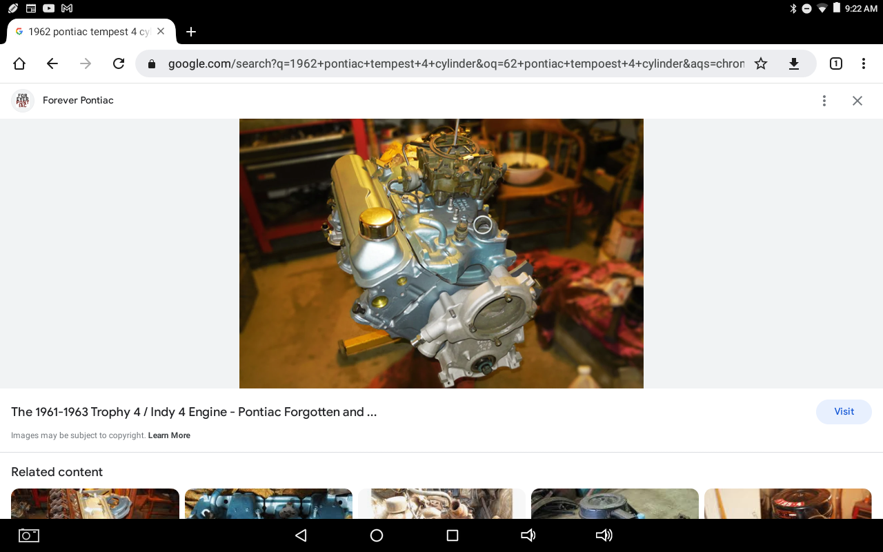

    Screenshot_2022-12-05-09-22-01.png I think there are more than one 151 ?
    There's the chevII based 153/181
    There's the Pontiac based " iron duke" , 1/2 of a 389
    Then there's a later 151 used in Monza ?
    Then there's a Vega 4
    Then there's a 4 used in S10
    Then there's the ford based 3.7 mercruiser exclusive
    And there's the usual internet confusion .

    People have always confused the 153-181 with the 151 Iron Duke. It has led to a lot of miss-information. There is just enough interchange to make it confusing.
