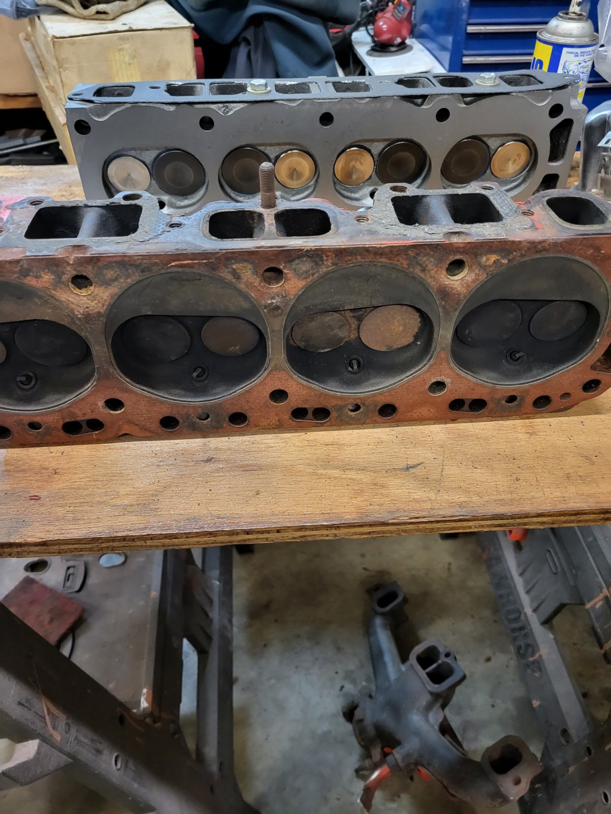

  19. OK...question. I am still planning on using a 140hp marine head on my 153. But yesterday I bought a 151 non-crossflow head and factory 2bbl intake. After checking, it uses the same head gasket, push rods, cam and some other small parts as the 153. It does have 1.72-1.5 valves, but has factory screw in studs and guide plates. In reasearch it seems like it's from a '77 Sunbird or Omega. Anyone have any knowledge on these?? And opinion as to this head vs the 140 marine head?
    Thanks, Gene.
  20. Six Ball
    Joined: Oct 8, 2007
    Posts: 6,742
    Six Ball
    from Nevada
    I'm pretty sure that at least the later 151s had the valves in a different order. I think that it why the later roller cams won't work in the 153 & 181. Maybe that came with the cross flow heads. It might work to change head & cam. Do you have pictures of your head?

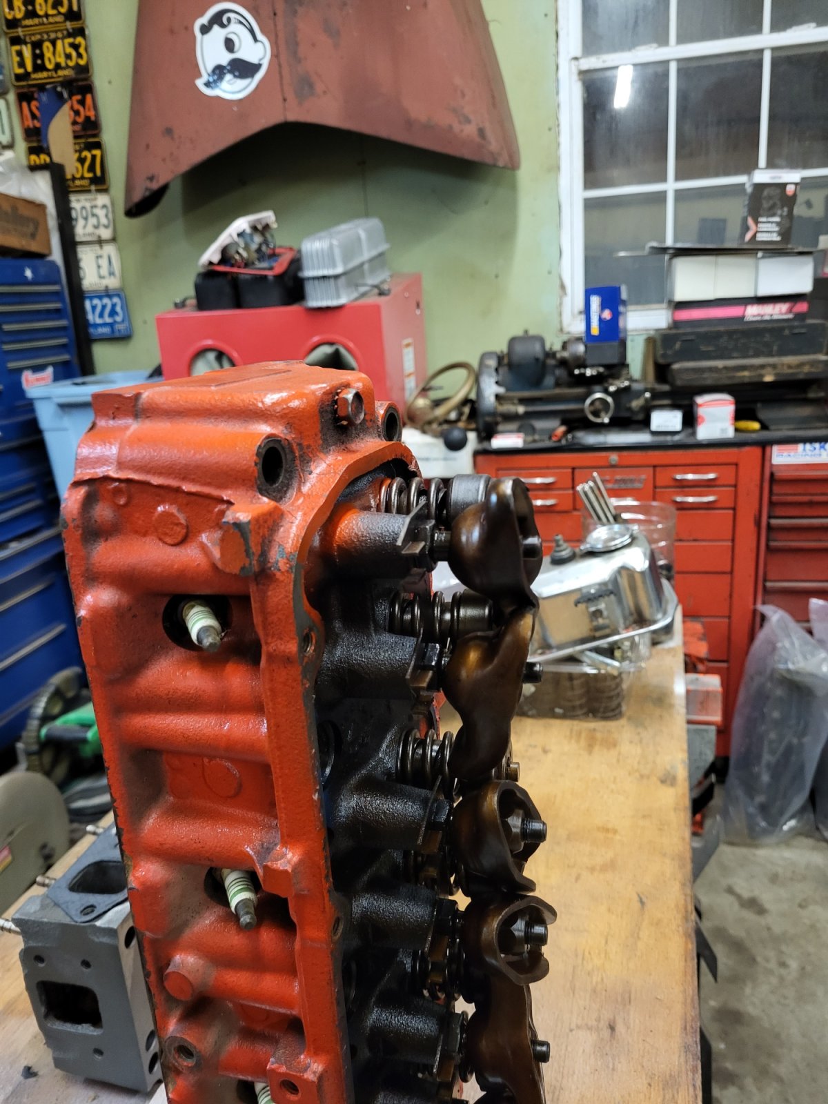

  21. Some pics...the exhaust manifold on the floor is off of it. And it came with a chrome valve cover. Gene. Resized_20230103_194356.jpeg Resized_20230103_194450.jpeg Resized_20230103_194533.jpeg

  22. Six Ball
    Joined: Oct 8, 2007
    Posts: 6,742
    Six Ball
    from Nevada
    Well, that is for sure the same valve order. The extra bolts for the intake might help with sealing, like with a turbo. The screw in studs & guide plates are a plus. The 8 port still has the advantage (?) of 4 separate intake ports. Who knows where the advantage lies. or at least useable advantage.

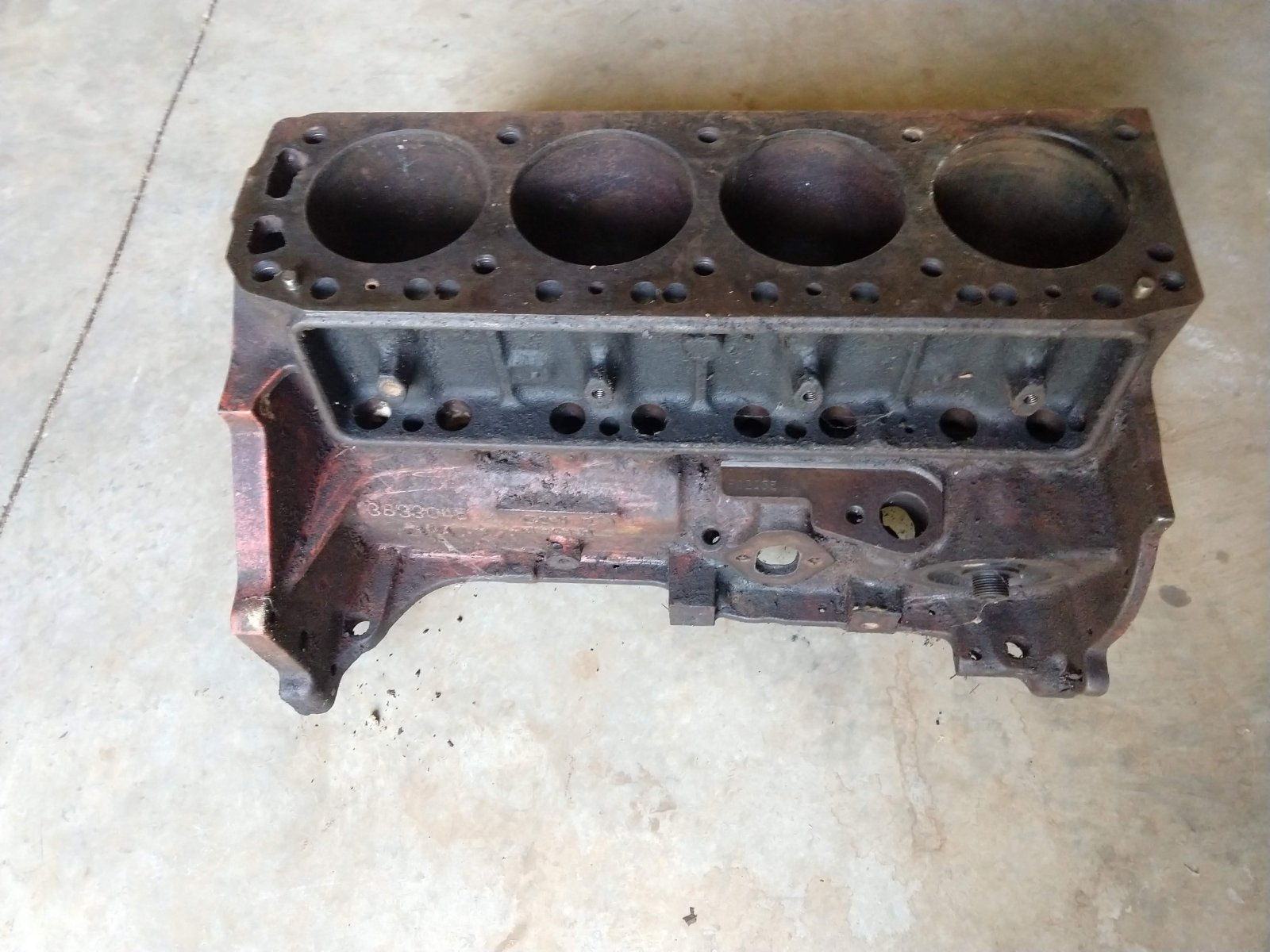

  23. Nick Landon
    Joined: Jun 19, 2016
    Posts: 10
    Nick Landon
    So it's been a while since I posted about my Barnes headed chevy II. I found out one cylinder needs a sleeve do to a wrist pin walking into the cylinder. The other problem is, it's already 4.060 and when the block was torn apart before I got my hands on it, it was cleaned and not reoiled. It's looking like the rust pits won't be cleaning up with a simple hone job. Considering that i need custom rods anyway for my racing application, I think I can make a set of lsx 4.065 pistons work. The problem is, the shop I was talking to was hesitant to work on such a Frankenstein build. With the cylinder wall problems, the crack at the base of the water, and then laying the engine down to 15 degrees from horizontal they just are not interested. I had just ask for them to do the work and not worry about the rest. Apparently they don't understand "Don't worry about the horse, just load the wagon." So now I'm setting on the build while I get my sprintcar ready for race season. It sure sucks not having my step father to help with these builds. He was just crazy enough to build engines like this.
    Nick Landon

  24. Tim
    Joined: Mar 2, 2001
    Posts: 19,560
    Tim
    from KCMO
    Where are you located/ what machine work needs done? Maybe between us all we “know a guy” who can load a wagon

  27. Beanscoot
    Joined: May 14, 2008
    Posts: 3,528
    Beanscoot
    Probably a Weber DGV would be the best for that 181 engine.
    As for the machine shop not wanting to work on Nick's cylinder block, they might have had issues in the past with customers wanting more unusual work, then giving them a headache when it didn't work out how they hoped.
  28. Six Ball
    Joined: Oct 8, 2007
    Posts: 6,742
    Six Ball
    from Nevada
    If that is a 153 block that is a HUGE bore. 3.935" @ .060" over is the suggested max. If it ran that way maybe your dad knew something.
