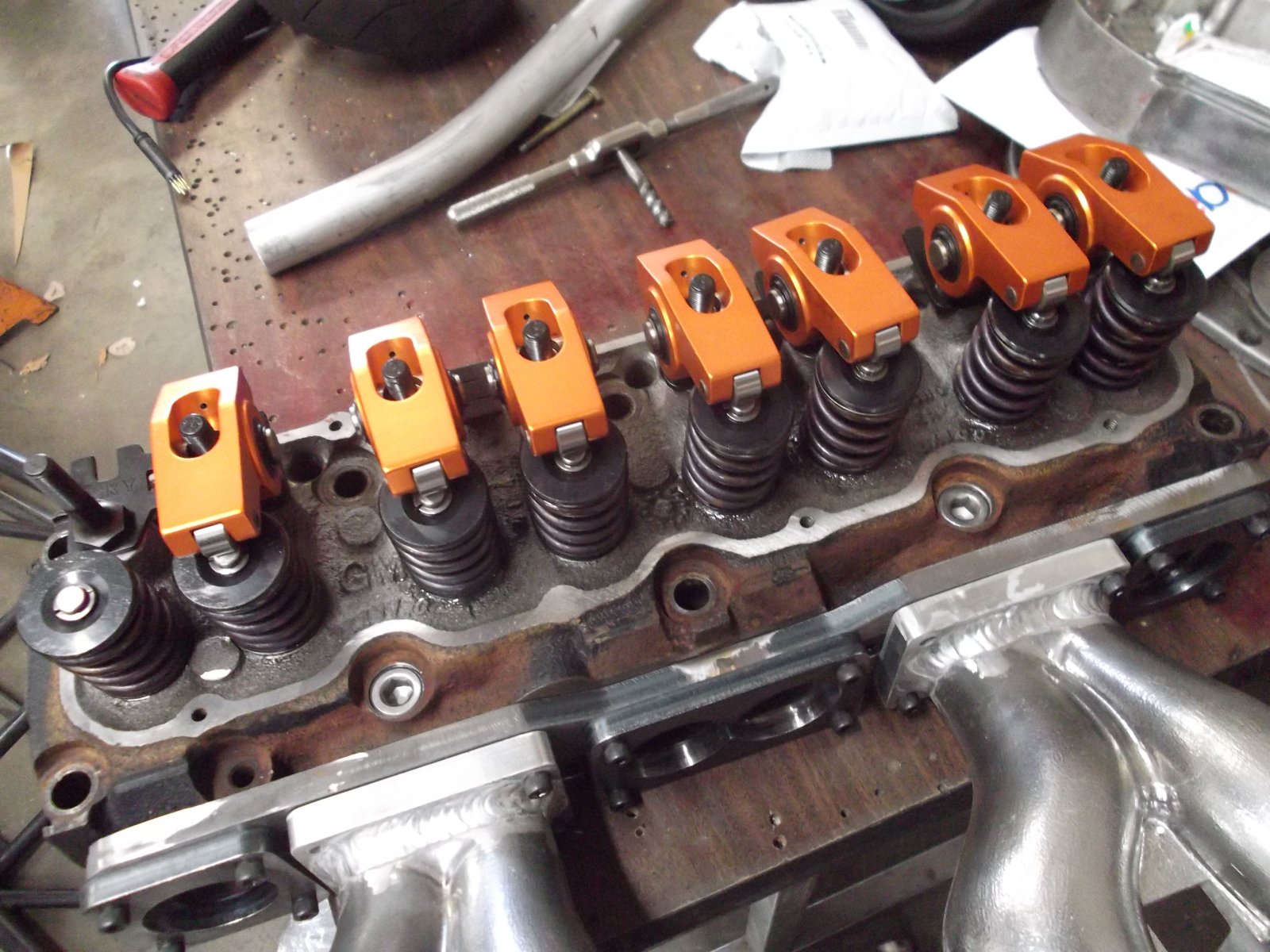

    Harlen/Sharp 1.75 ratio, But you need a valve cover spacer(or tall aftermarket VC) and knock the corners off the outboard rockers to keep them from rubbing upload_2023-2-20_8-8-55.jpeg

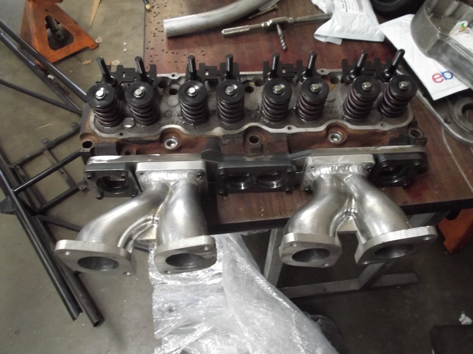

    Volkswagon Webber intakes

    I haven gotten to the point to measure for pushrods yet. I'e only been putting this engine together for about 10 years. :rolleyes: But when I had the cam ground I had 1.70 big block roller rockers and have cam specks using them as well a 1.75s. When it is together I'll measure for both before order pushrods. Does anyone know for sure if pushrod guide plates are needed?

    I opened mine up and using guide plates only for the fact that I have not put this combo together before and dont want to get caught later on needing to open the PR guide holes

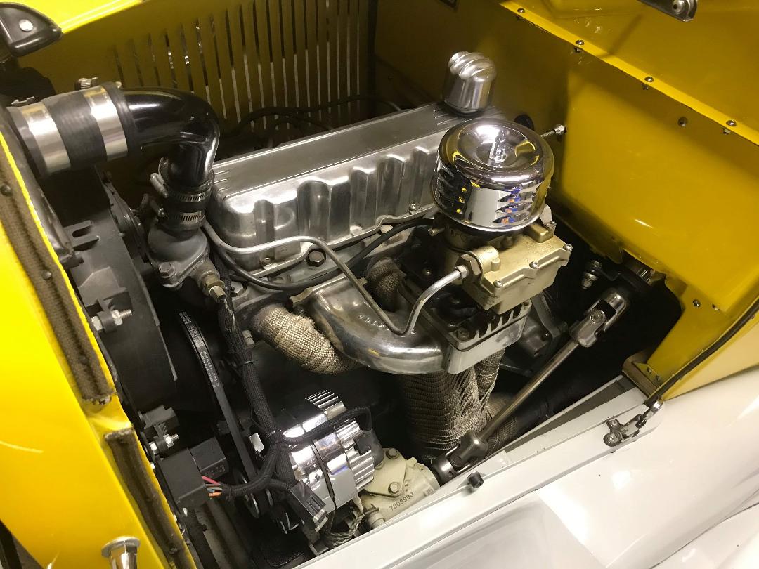

    upload_2023-2-20_22-0-15.jpeg Chevy II 151 in my 29 Ford upload_2023-2-20_22-0-15.jpeg 1929 Ford Woody 19.jpg
  9. hotrodbob
    Joined: May 7, 2002
    Posts: 521
    hotrodbob
    Clifford. I just got an adapter from them to mount a Holley/Webber type two barrel carb on it. The Chevy V8 carb is just too big. Runs way too rich and mounted like it is, it stalls when turning.

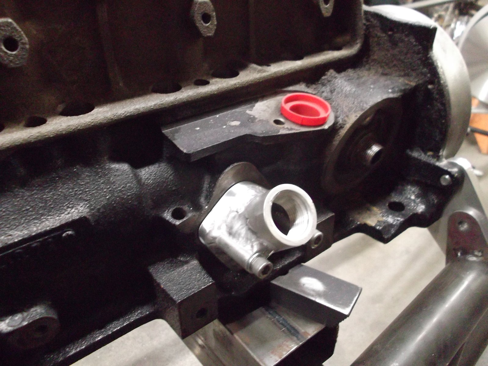

    Morning project

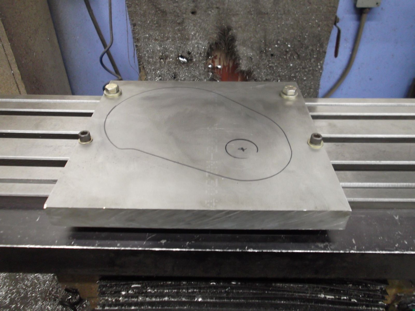

    Since the engine will be fuel injected, and was going to make a fuel pump cover plate anyway, Decided to make it my oil fill also

    What thread is on the oil filler neck?

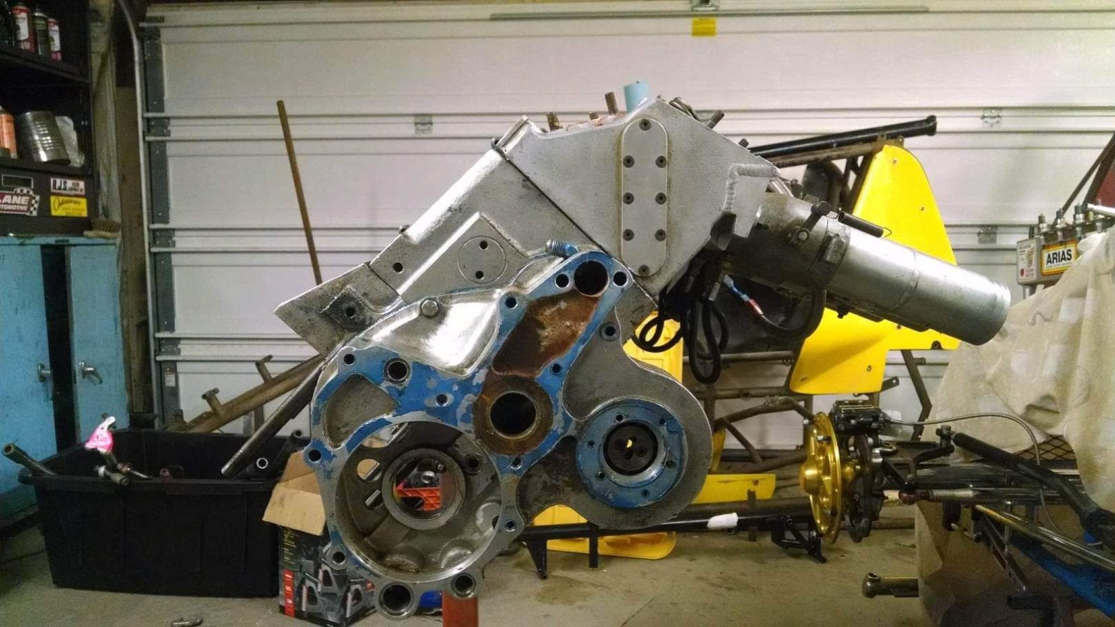

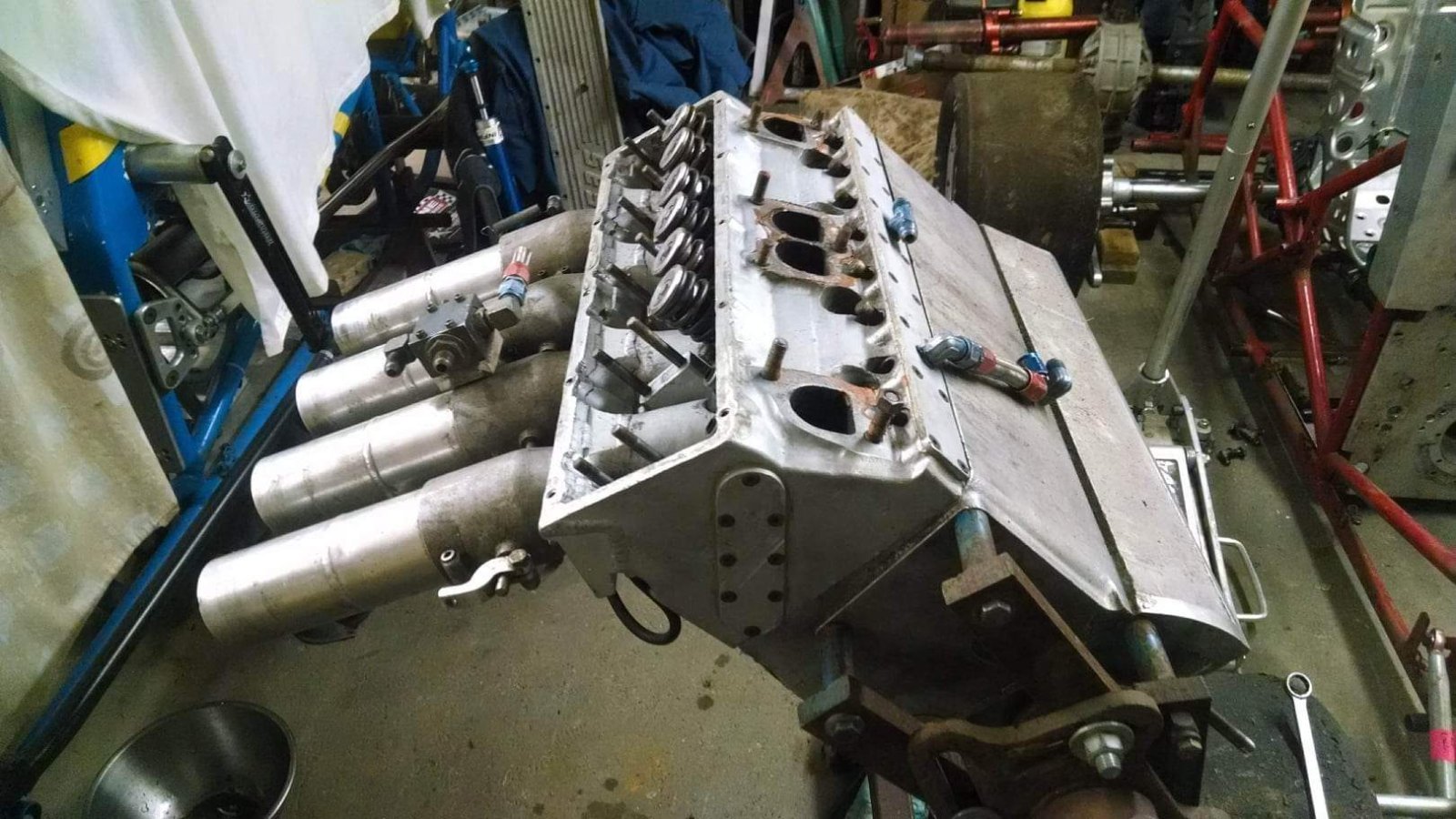

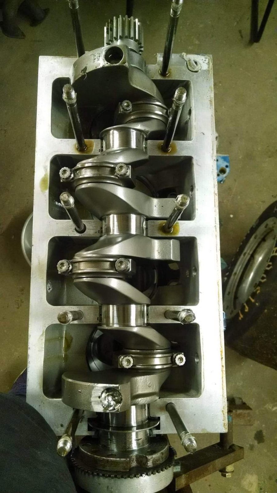

    Well, I hate to say this, but I gave up. I found one of the welded up head stud holes had a Ccrack from there to a water jacket hole. I was able to get my 166ci Sesco Chevy back that I traded to get one of my grandfathers old super modifieds. The chevy II racing parts I am selling to someone who is building a vintage midget. The Sesco Chevy original came with my midget and after my step father p***ed it became available. I promise not to hijack this thread, but here's is what I have to work with.

    AN -12

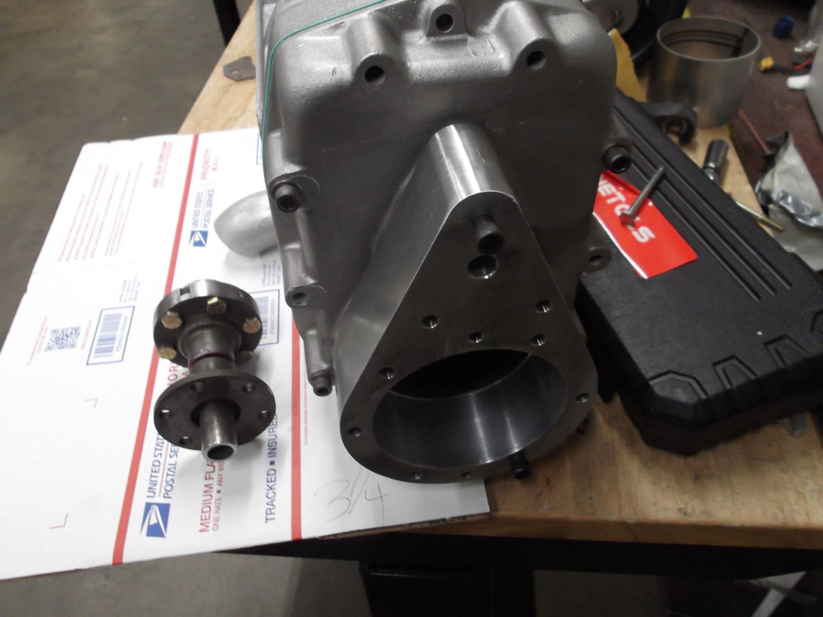

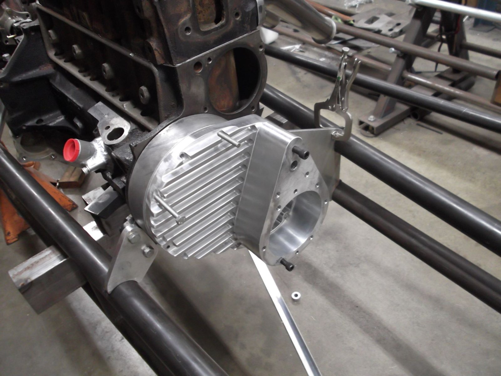

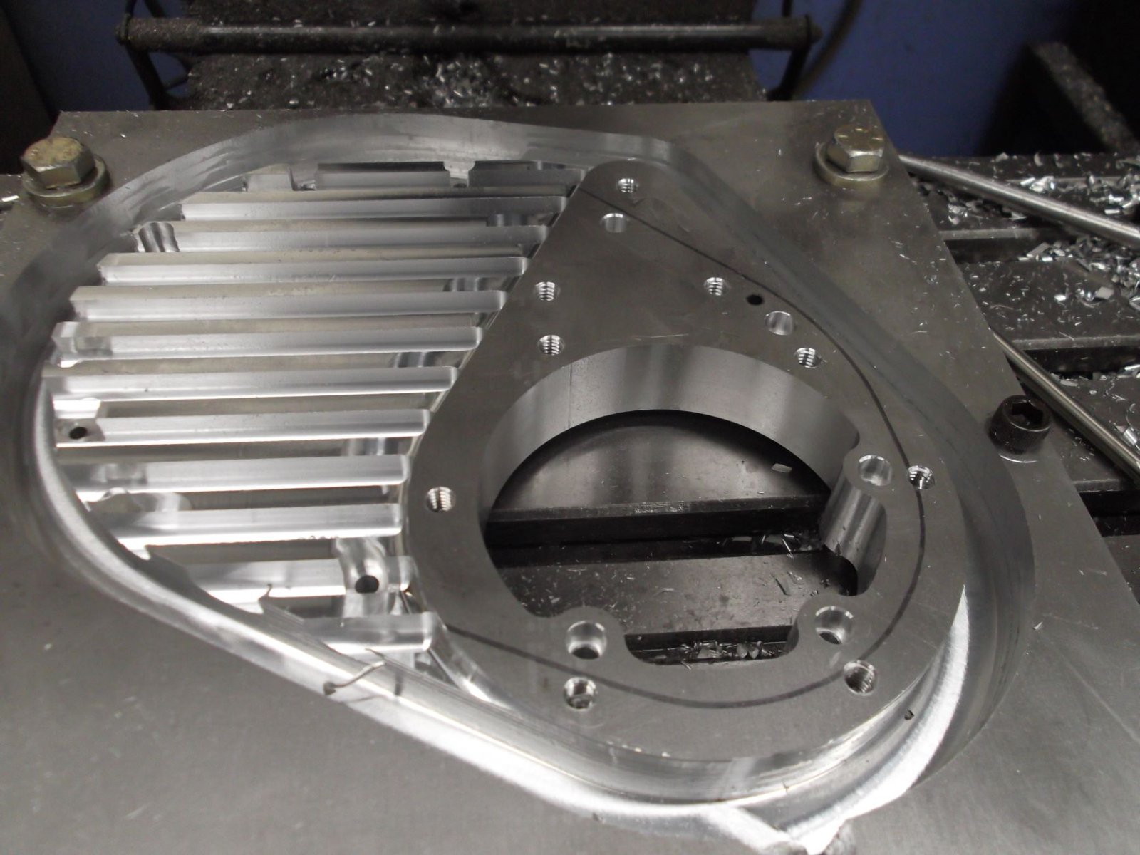

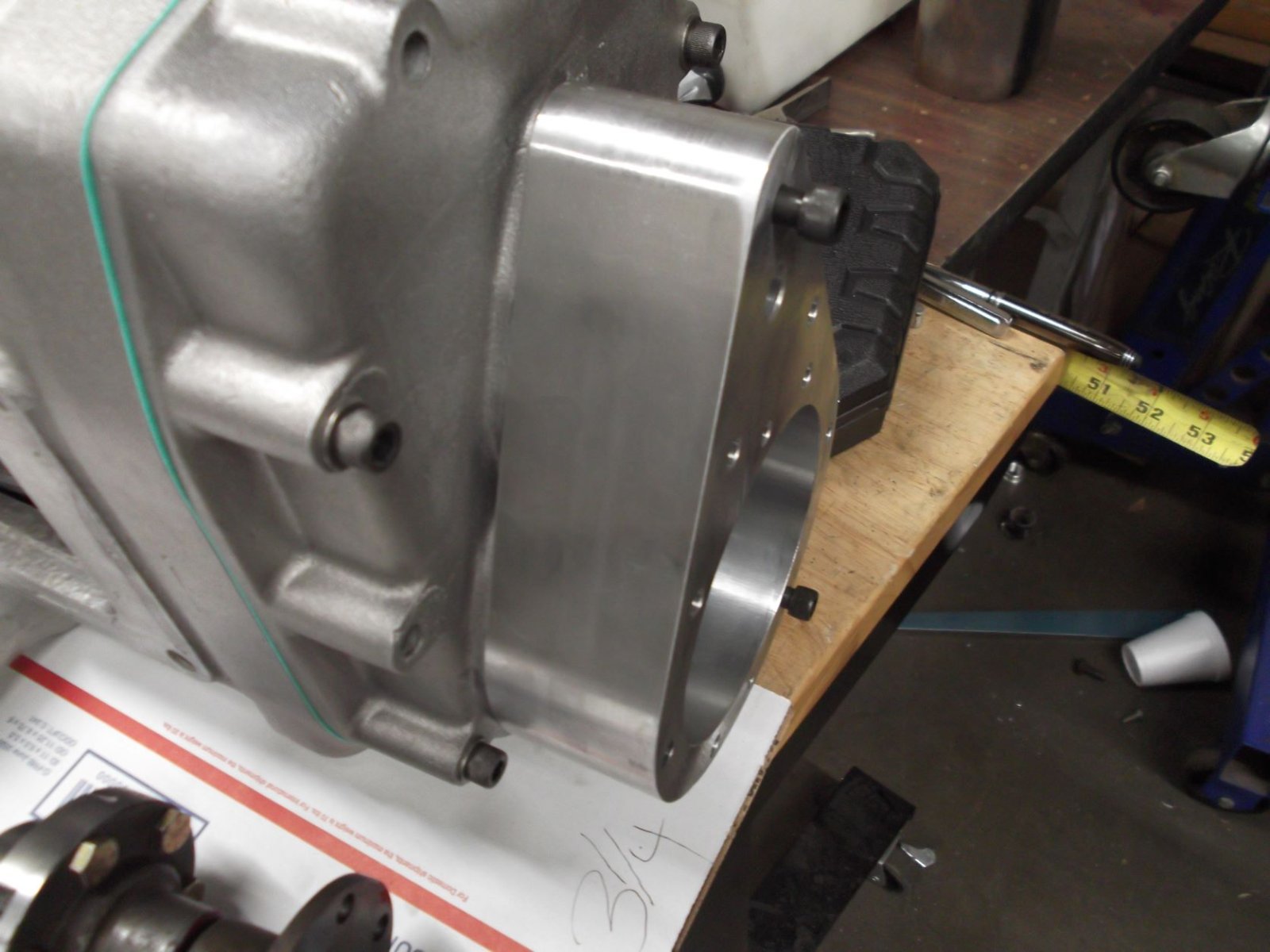

    Machined up the new timing cover that I will mount the 4/71 blower to. Need to make a 2" spacer because of the length of the drive coupler
    upload_2023-3-3_8-13-45.jpeg upload_2023-3-3_8-14-6.jpeg upload_2023-3-3_8-14-26.jpeg upload_2023-3-3_8-15-45.jpeg

    4-71 I like what I’m hearing!
    Six Ball likes this.

    Impressive work. Makes me wish I had skills. I want to see the videos to this thing running!

    Two of the critical skills are to be able to tell when your plan is no longer a good one and being able to see the best path forward.
    Nick Landon and X-cpe like this.

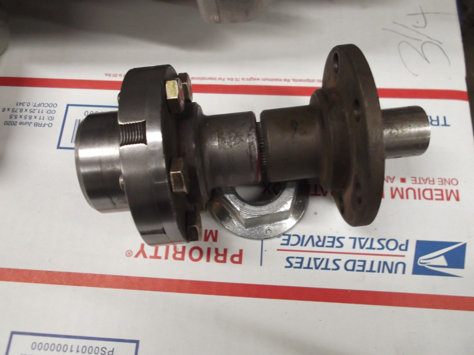

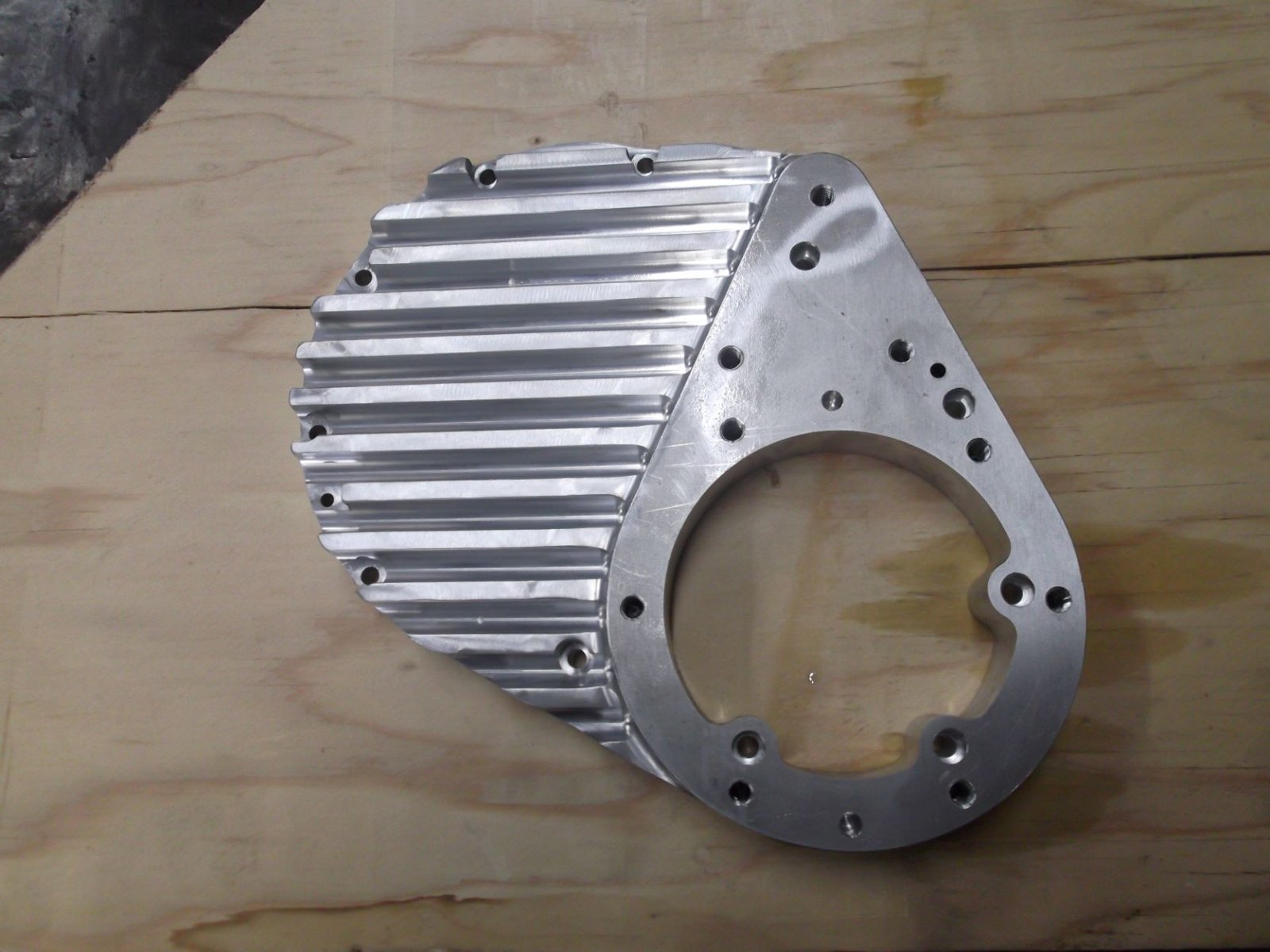

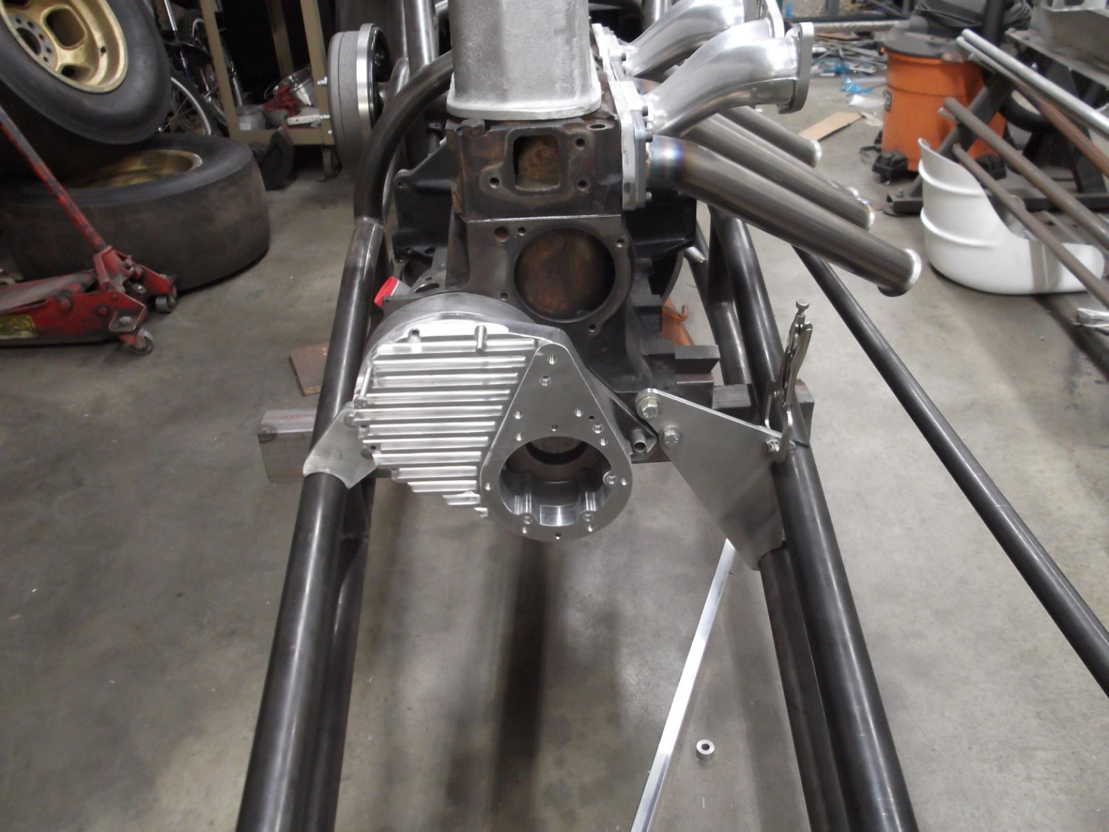

    More chips today, same part, as it goes between the blower and the timing cover upload_2023-3-3_17-13-17.jpeg upload_2023-3-3_17-13-32.jpeg upload_2023-3-3_17-13-51.jpeg upload_2023-3-3_17-14-8.jpeg

    I hate to do it, but I need to finish the car up. It's been a sad running joke with the amount of problems I've ran into and delays of progress. The Sesco has all the engineering done, I just need to repair it and put it back together. That you everyone for all the advice.
