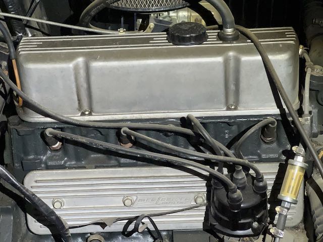

  21. What do the people that have a 181 (140hp) do for an intake manifold?. Could you modify the marine intake/exhaust to work for a car or are you stuck making your own set up. I'm looking for a simple 2bbl on a 8 port head, pretty much what the stock marine motor had.
    Just getting ideas for the future build of the '57 Hillman (1900-2100 lbs). I have a Ford T5, a Jeep bellhousing and a small rear differential.
    I found this while looking.

    I don't know of anyone making 181 intakes. I di know a guy that reworked one of the dual carb boat manifolds to get the water jackets off. It didn't look real nice but it wasn't finished yet. Maybe it could be done to the 181 intake.

    I see now that a 151 is totally different. I modified a 2x1 Offenhauser to fit my 153 head. I bet the flanges could be modified to work on a 181. Probably have to use some dividers or you would be right back to the Siamese ports. Probably easier just to build one.

  26. You can buy a rebuilt 181 marine engine without a core on some websites and looks like places repo the stock marine intake/exhaust manifold. I have to read waaaay more research, but I'm thinking get the rebuilt motor, figure out the intake/exhaust situation, stock point distributor, the correct flywheel, the correct balancer and I'm in business??????

  28. I think the 181 also found its way into fork lifts which might be a source of manifolds that aren't water cooled.

    sorry but i can't find the post i got a email about asking if anyone cut up a marine manifold set and the answer is YES, sorry it can't be used , to much of the casting is also how it bolted to the 8 port marine head.
    yes the motor made its way into forks, also generators and field water pumps, with a different head like the one posted above which i would call the 6 port head . the forklift motor uses a very low rpm torque grind cam, the hp is low about 85 at around 2000 but compression is way up at 10.5 swap the cam to the marine
    manifolds it's far easier to go to clifford performance and get a intake and header
